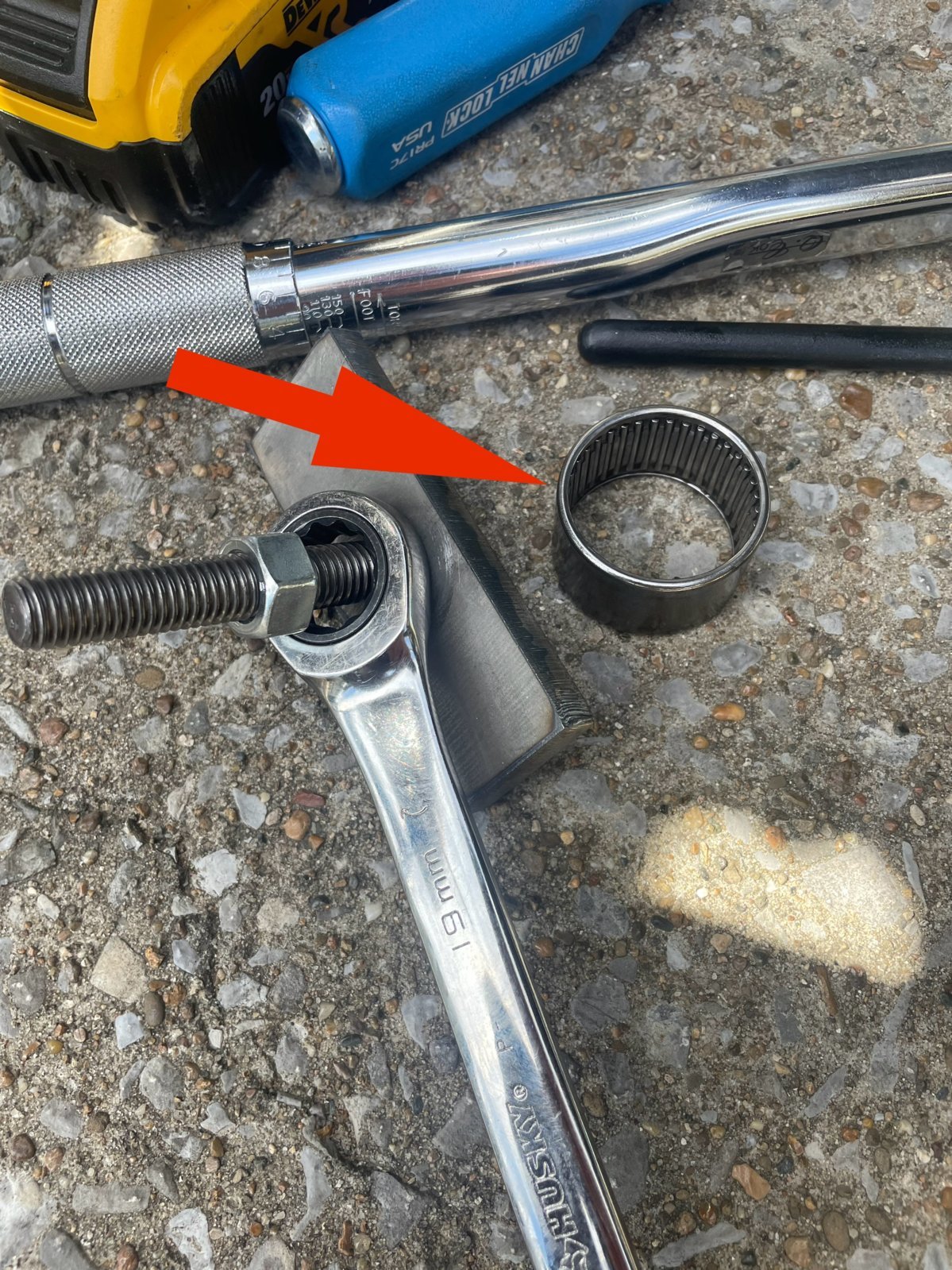

    I replaced mine a couple months ago. Not the funnest thing I’ve ever done, but not too bad. I’m pretty sure it made the noise from day one, but it was never more than that. The needle bearing looked great when I got it out. No wear or damage to the axle or anything. In my case, I think it could’ve gone forever just making the noise.
    Here’s a pic of the needle bearing. It looks new; no wear on the needles or anything. Just the tiniest bit of room for the axle to wobble in it.
    2mchfun likes this.

    always my thought too. Mine makes noise, keep thinking of going the bushing route. Probably will one day, but as you note I don’t see anyone complain of them actually going bad and everyone says how good the rollers look when they come out
