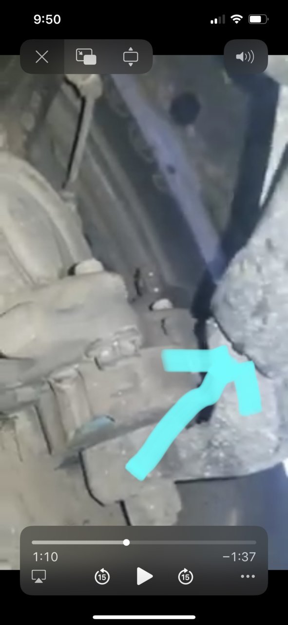

    Hey there,
    I'm having a loud snapping / sound coming from under the the passenger side tire area when driving or having the truck rocked side to side while parked.
    It comes and goes over the last two weeks, sounds very loud in the cab and can't always be recreated.
    I removed the skid plate to get a better look and made a video. I've narrowed it down to the area I filmed.
    Would someone be willing watch my short vid and see if they have any idea what it might be. I'd appreciate it:
    https://www.youtube.com/watch?v=pya6qzFdJ0U
    thanks!

    I'm pretty sure its coming from the area on the wheel that I was filming. Near the lower control arm / brake assembly. I was hoping that someone else had this same issue and might recognize the snapping metallic sound. Sort of like a slapping a crowbar against an empty gas tank. Tong, tong, tong.

    OK. Do you think its vibrating against the thin metal plate that it protecting the brake disc.

    Either the joint is toast or not torqued to spec, zoom in on the joint and you can see it separating, there should be little movement

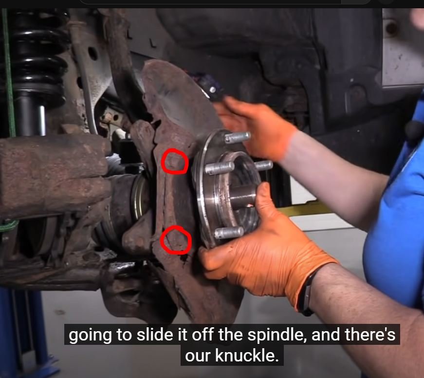

    I don't think so. What you're pointing at is an artifact of the LCA shape and the direction of the light coming from the camera.

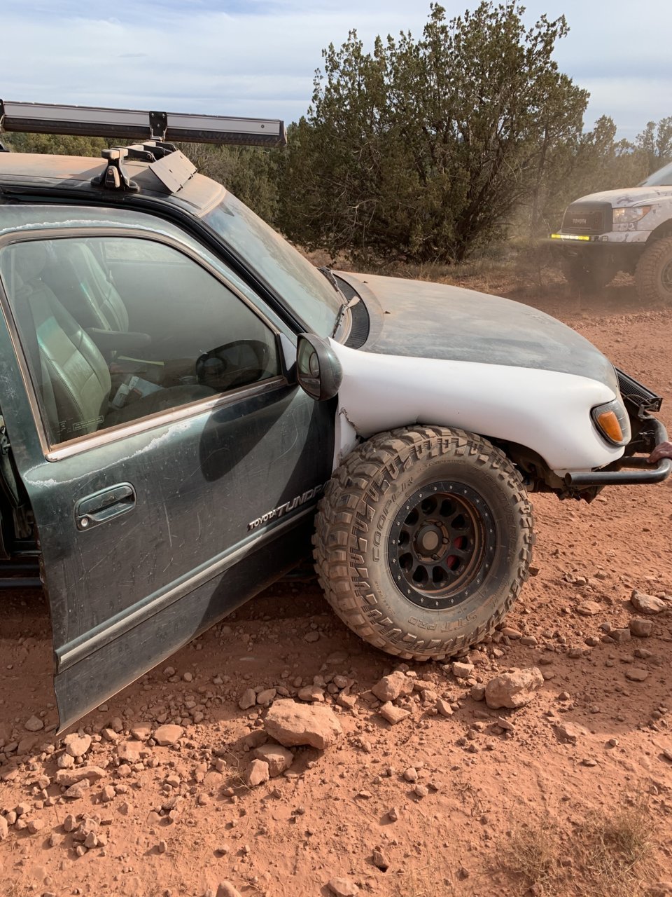

    Yes. Your LBJ about to fail is a very likely source of that noise. The guys telling you to jack up the truck are suggesting you take weight off so you can “see” if the LBJ can be made to move when you manipulate it. Here’s a photo a buddy sent me, showing where to insert a tool to manipulate it:
    I don’t keep a video hosting acccount anywhere, so I cannot post a video, but you can probably find one on YouTube.
    I can show you from experience why you should go ahead and replace both LBJ’s though:E056C121-203F-4C75-8D68-BB4BBDCFE640.jpg
    I was lucky this did not fail on the freeway at speed… as we’d been hearing the sound, which seemed to correspond to tire revolution, for a couple of days in numerous driving conditions. Even at less-than-freeway speed, sustained damage to the firewall, so now I have increased wind noise in the cab. Seriously, don’t drive your truck until
    you replace the LBJ’s or confirm it’s something else.
    P.S. Mine failed because bolts sheered off— probably one backed out and the rattle/ popping was the LBJ shifting around on the remaining, eventually working them out. I found a sheered bolt in the dirt behind the truck.
    So start by torquing all your LBJ bolts to spec. Maybe you’ll get lucky and that will fix it. But, apparently, I’m the only one anybody in here knows that had bolts fail; usually it’s the actual LBJ.

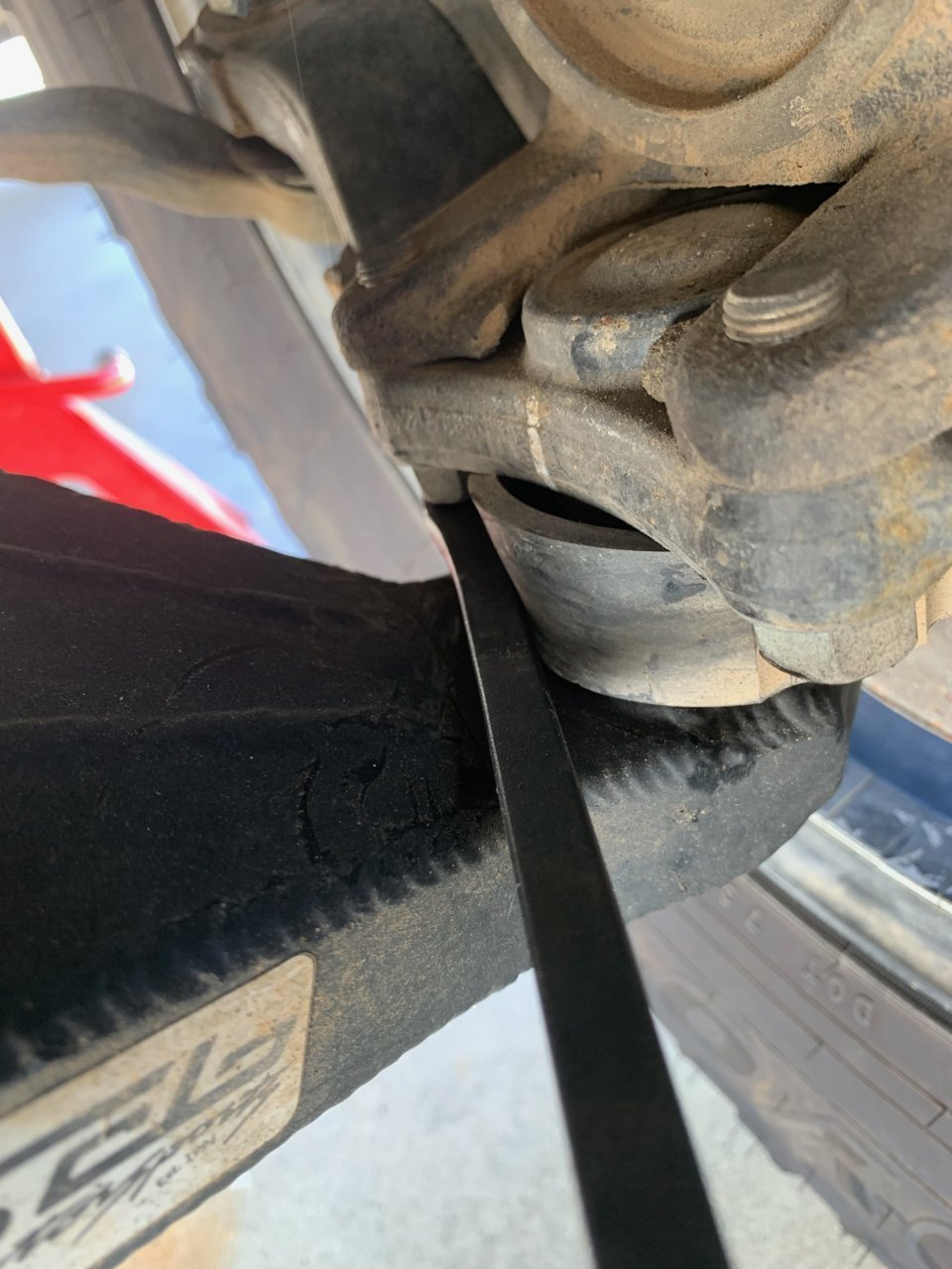

    With that kind of racket, if you put a lever between the two parts that a ball joint connects and can see any kind of movement it would be bad, the ball is supposed to rotate in the socket not move up and down (for a LBJ such as the one mentioned).
    What kind of shop did you take it to? Rather than looking they should have used a pinch bar to test joints. If they are kosher and a new control arm was fitted then you should be safe looking elsewhere...unless they omitted to replace the bushes in the control arm at the chassis end and whilst I haven't owned an older model that kind of noise is something I've only seen when those bushes are shot. IME balljoints make a lot more subtle noise whilst a bush that has fallen apart would make a right racket.

    Let us know your findings by checking for play when you jack up the lower control arm. Pics of said shock mount would be helpful if nothing found.
