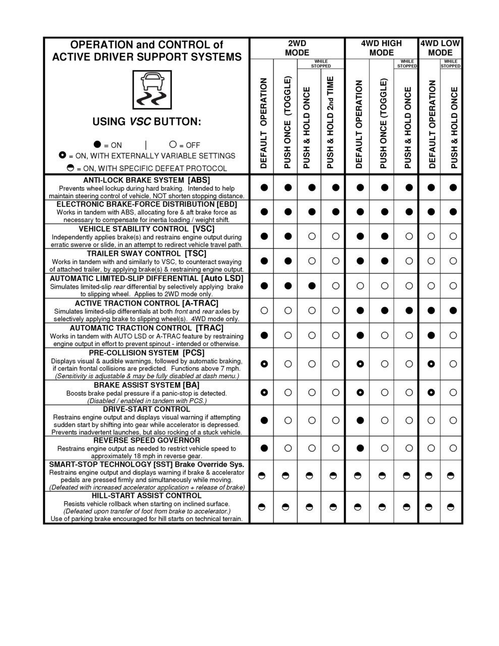

    Tundras have "electronic brake force distribution" and "brake assist" which is fancy for "the truck decides how much pressure needs applied in certain situations.
    I thought mine was soft too but they are fine. It takes some getting use to. My abs went off yesterday and it sounded like someone was blending gravel in the back seat. :confused:
    Here's a list of nannies, what they do and if you can control them.NannyCheatSheetV6.jpg

    Blending gravel in the back seat is the perfect description of the sound it made. Guess I'm glad to know that's the "normal" sound.
    Thanks for the diagram also - now it's time to go find somewhere to get this truck dirty

    More than a few.....
    just to clarify, the proper sequence to turn every nanny off would be, push and let go once, then push and hold, then push and hold again, correct?

    yep. whenever im dealing with snow, slick, loose gravel, etc, i press, and then press and hold till the lights come back on again. basically if im not on pavement, thats the mode i use. if im on pavement, i only do the single press, and only when im in so much snow that i'm worried about loosing momentum up a hill.
