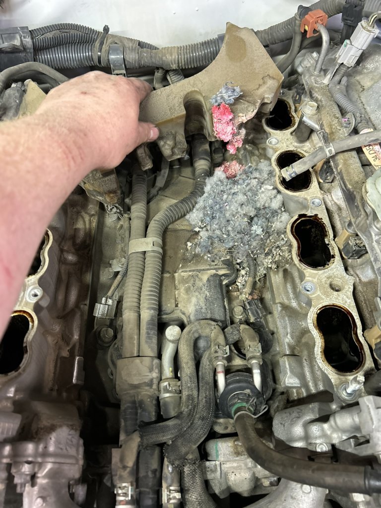

    I worked for Toyota off and on from 2007-2017 as a tech. I've never seen any issues with the PCV system whatsoever, besides rodents damaging hoses. They love to nest in the valley of the engine, on top of the PCV system. Here's a pic of the mouse nest my brother found when resealing my valley plate. Attached to this issue, it is very common for rodents to also attack the knock sensor wiring.
