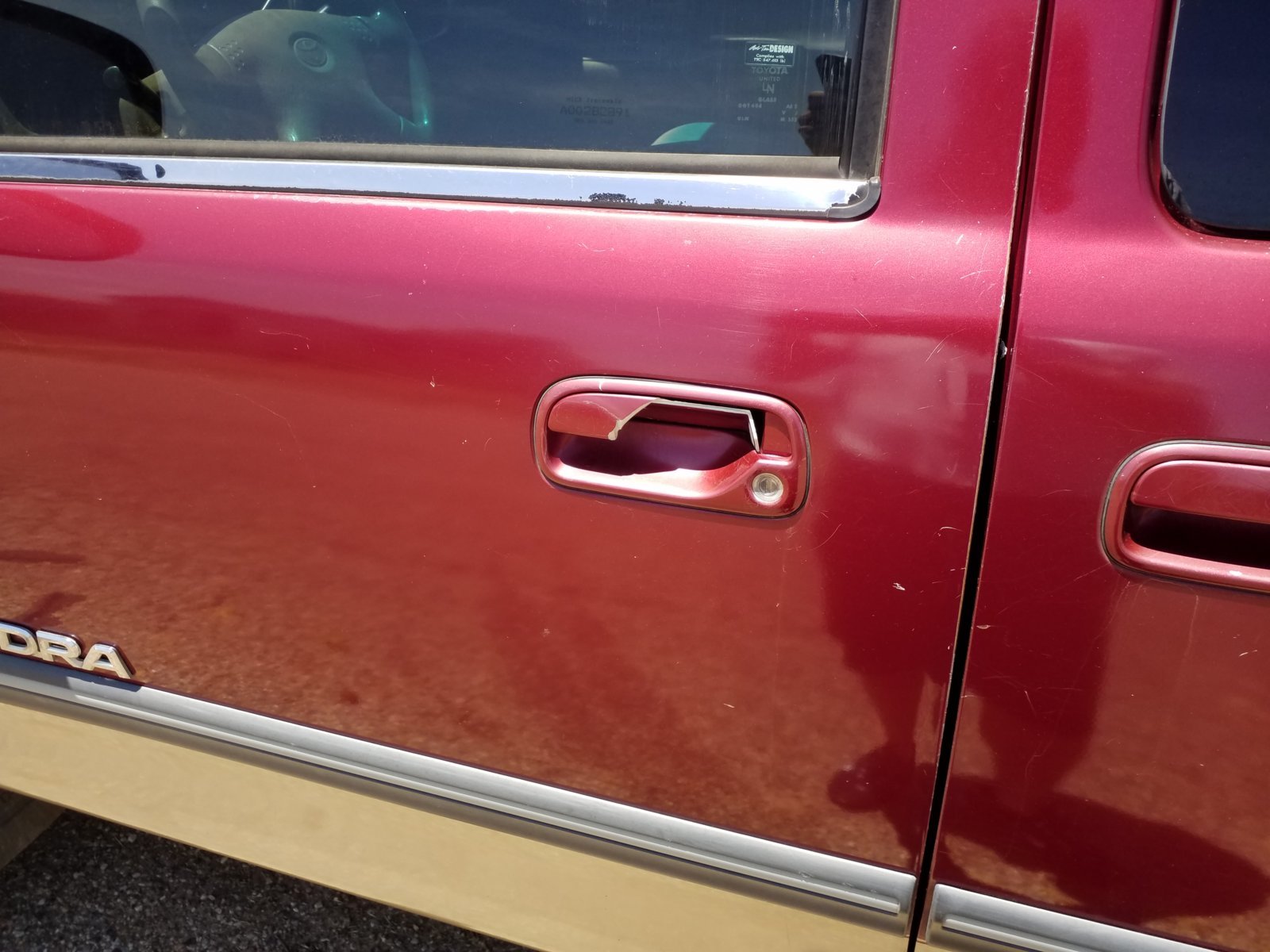

    Grab a red access cab exterior door handle for @bmf4069 while you're there :rofl:
    bmf4069 likes this.
  21. Dec 19, 2023 at 6:55 AM
    bmf4069
    Sep 1, 2018
    #18880
    9,485
    Beau
    TX
    02 AC sr5 4wd v8
    Why? It still works. You just have to open it with one finger....
