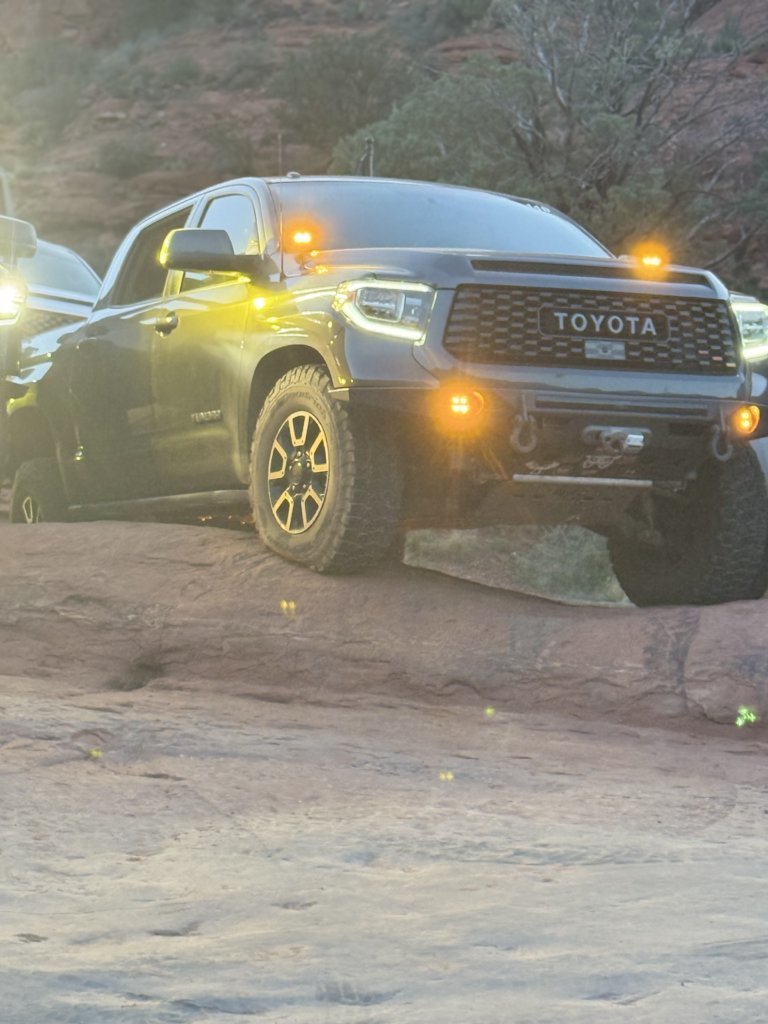

    These trucks are known for jiggly fog lights - it wasn't as noticeable with the incandescent lights but with the LEDs you could see the light bounce across every joint in the pavement.
    my solution was a Demello bumper.
