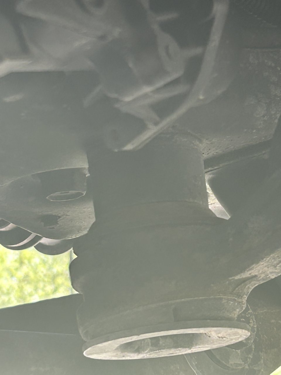

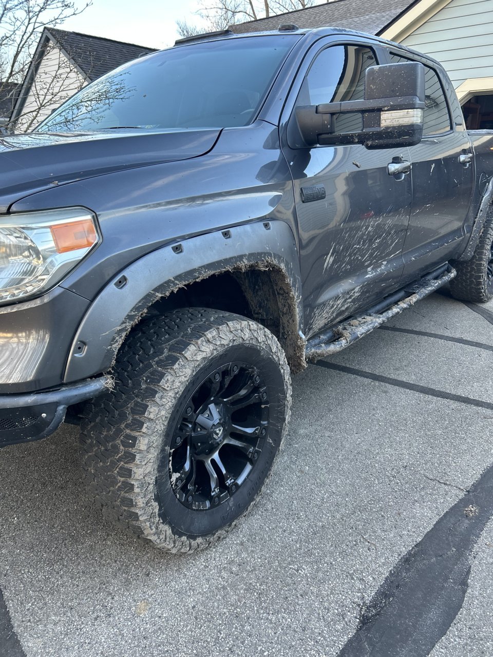

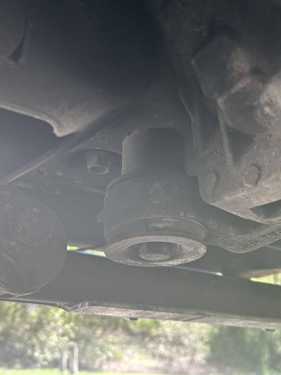

    Hello Fellow Tundra Owners.
    Just bought a 2014 Tundra 4x4 Off-Road with a stick Bilstein suspension (4600) I assume. Previous owner put a 3-1 spacer kit on the truck and 35” tires. Been hearing some clicking, thunking and creaking coming from the front suspension.
    I think the ball joints are binding, the Upper control arms are also rubbing the coils on the front shocks.
    All that to say, I’m looking for a better option, thought replacing with Bilstein 5100 (adjustable ones) but that won’t quite maintain the lift I have I don’t think.
    @Toytec Lifts what would you suggest?
    I don’t wanna continue putting my suspension under harsh angles and tear more stuff up…

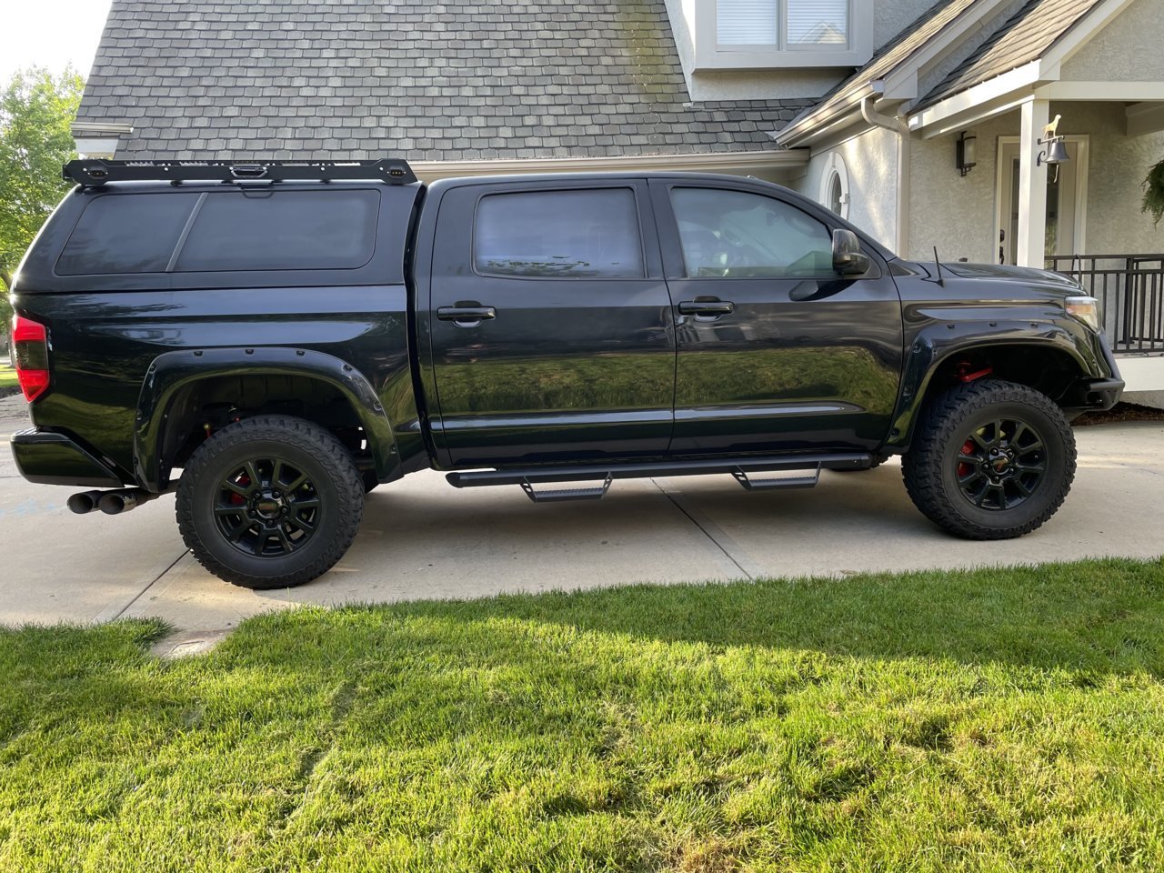

    I got toytec coilovers with coachbuilder shims and powder coated SPC's UCA's...pretty critical to change those if you get up to 2.5 inches or better. Added a leaf in back with 3 inch shackles....Important to put dif drop kit on as well.
