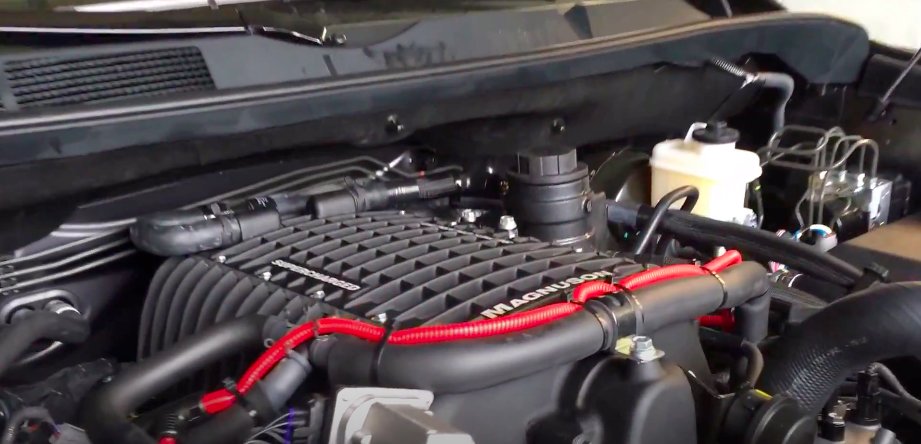

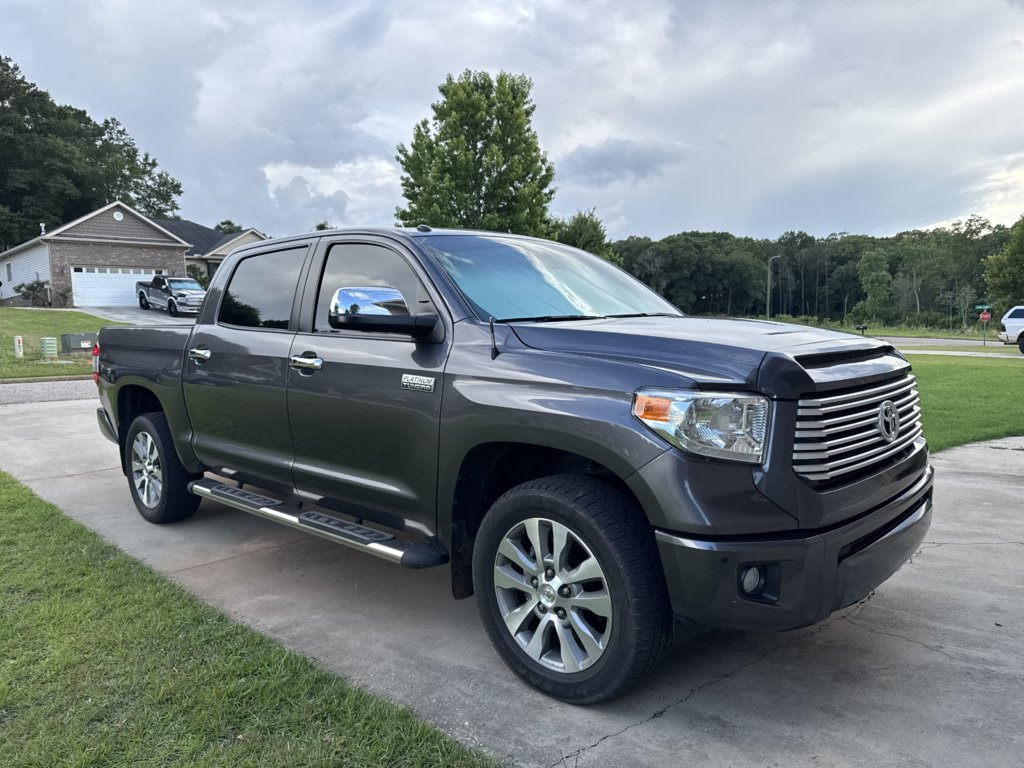

    I'd like to get back into a tundra, and I found a 2014 supercharged(Sc) Platinum model with 60k miles, Sc was installed at 4k miles from the dealer(TRD/Magnuson 1900).
    1.)What is everything that should be installed with a dealer TRD SC install?

    1. Supercharger, there will be a coolant tank, oversized air intake but it'll look factory, the injectors should be green and not tan, there will be an intercooler behind the grille that looks like an AC condenser essentially. There should be wiring run from the intercooler pump to the fusebox. Nothing will be particularly obvious, if it's running normally I wouldn't be worried about parts missing.

    5. Check the supercharger coolant level, it should be red coolant and the same the truck uses. The supercharger should have a "subtle" whine to it when you get on the throttle. It should be totally quiet otherwise. If you hear anything that sounds like sand bouncing around in the intake---usually at idle---it means the supercharger coupler is going out. It's a $20 part but can be a little annoying to replace, if you're handy at wrenching it's not a big deal. Those are really the only issues specific to that model of supercharger. The supercharged trucks are generally very reliable, and while that's a decent amount of miles being boosted it's nothing crazy or anything I would worry about.
