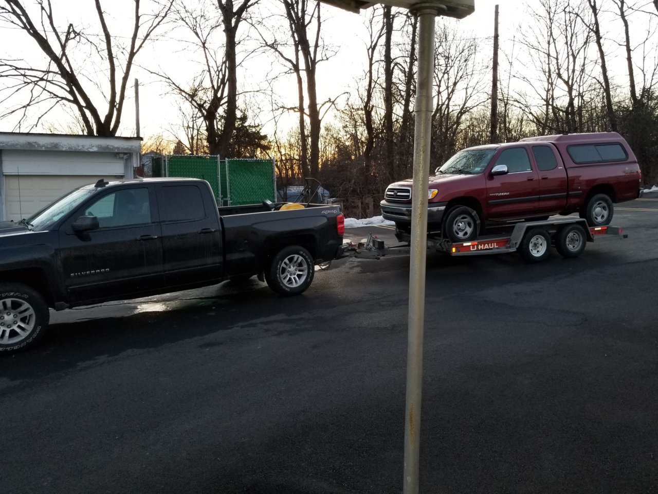

    2002 4x4 6cyl manual
    I found one!
    Dog, speedtre and gosolo like this.

    2006 SR5 AC 4x4 TRD-OR
    I am calling BS until we see the pics! :thumbsup: :bananadance:

    Congrats and Happy New Year!!!
