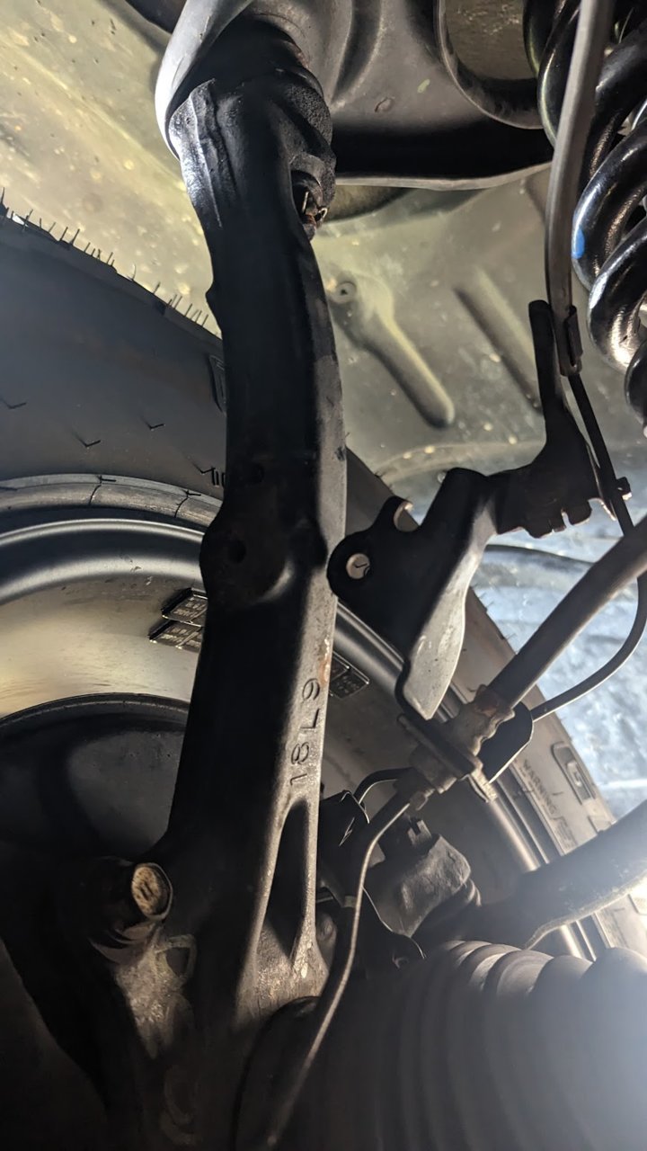

    I noticed that the Front Left (US drivers side) steering knuckle brake line bracket was loose and I would like to buy a new bolt for it. However, I can't find the part number for the bracket to save my life. See the attached photo of the part I'm looking for. Thanks in advance for any help!

    Take the opposite side off and take to parts store. Easy fix

    Such a simple little thing but I couldn't find a bolt that was a true match for this anywhere and I didnt want to wire tie the thing. The guys at Sparks sent me this diagram and it ended up being 90080-11400. Hope this eventually helps someone else.
