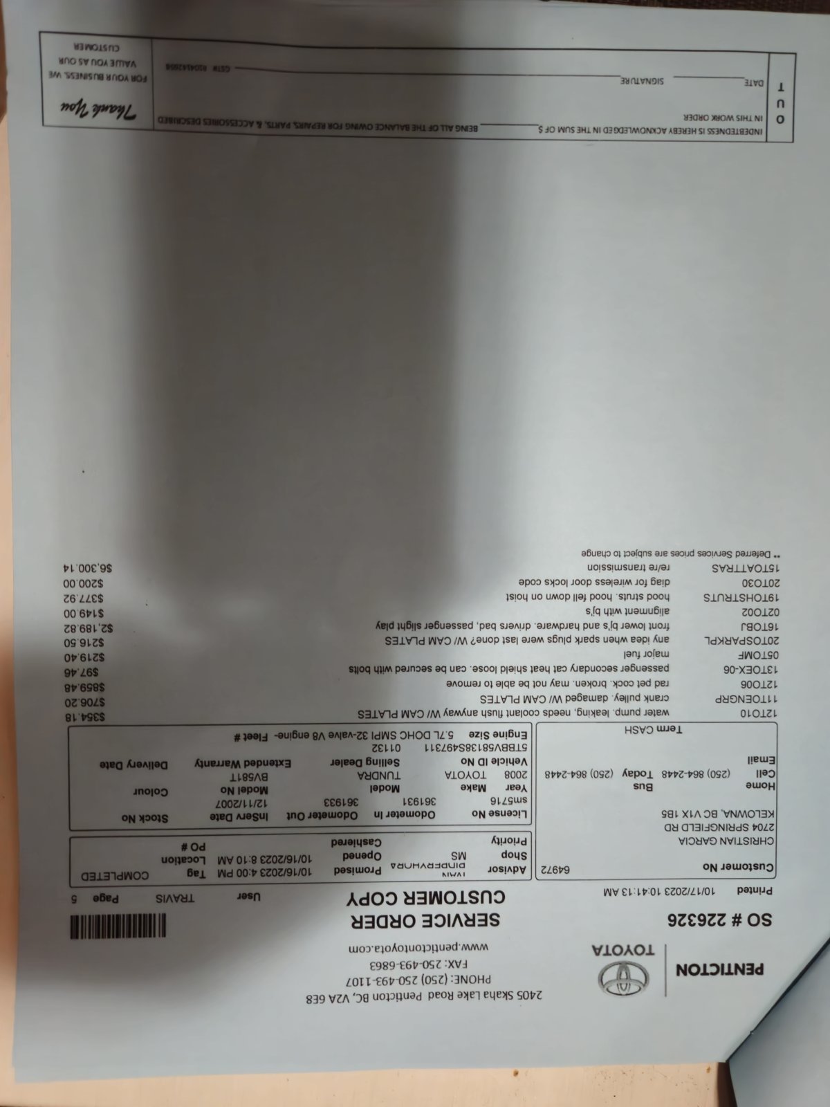

    Start from the bottom up if you have he courage or time . The total quote was over 27,000 Dollars I paid 10,000 for the truck 5 days ago .

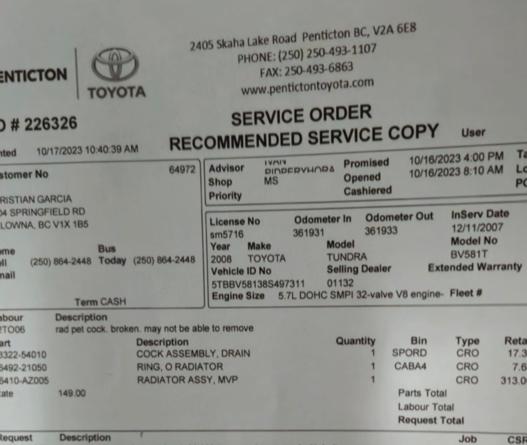

    I'd say $17 is a decent price to have your cock assembly drained.

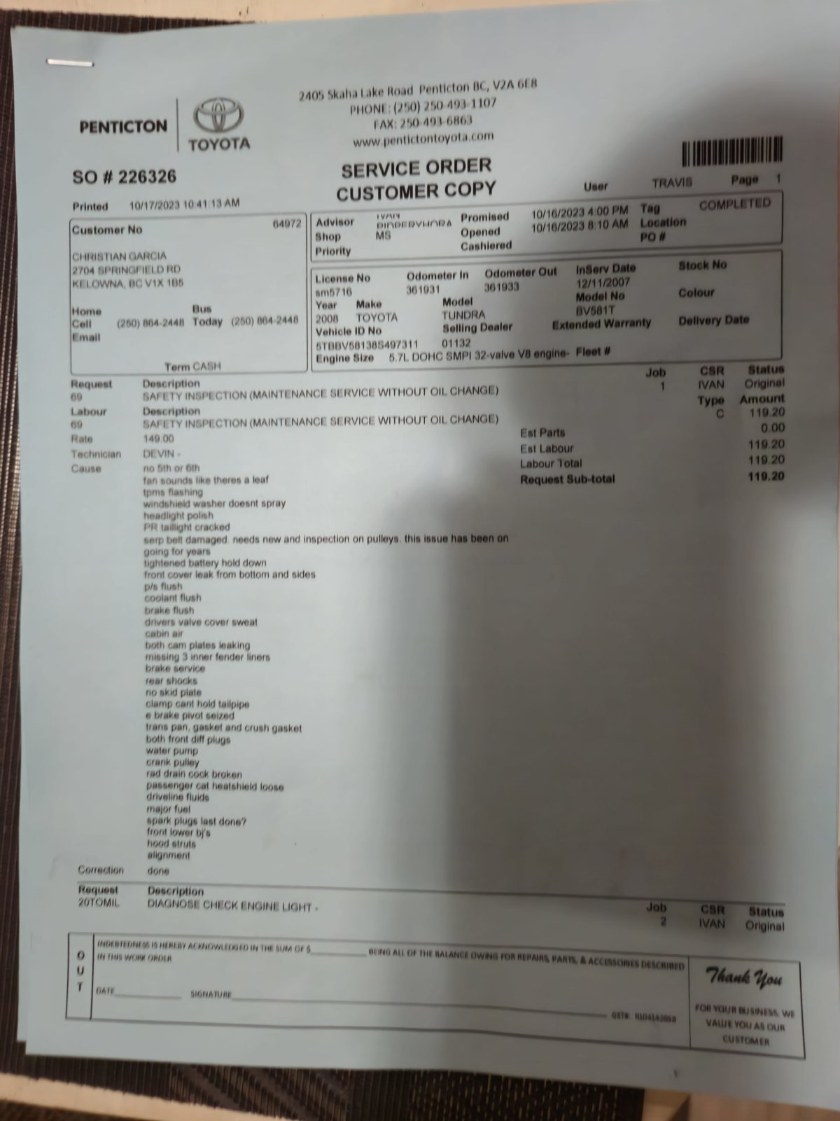

    Reading the recommended repairs again, I'd get a second opinion.
    Some of those items are routine maintenance, or due for repair/replacement from mileage or age. Suspension and brake components, parking brake cables, etc. Stripped diff drain plugs, exhaust leaks, coolant change. This stuff any DIY mechanic can do.
    But a complete engine rebuild? You would know within minutes of driving if your truck needed an engine rebuild or head gaskets.

    First and foremost don’t ever take an old car to the dealer. They will give an estimate just like this one.
    What prompted you to take it to the dealer anyway? What problem were you having?
    360k guys… those are kilometers not miles. So 220k miles.
    nobody is going to flip through multiple pages of upside down dealer nonsense. Find a local Indy shop to take it to if you’re having issues and get a legitimate estimate.
    plenty of us can help you if you give us more specific info.

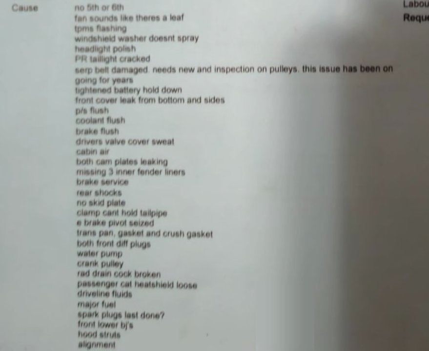

    First off, OP, you got ripped the hell off if you paid more than $3k CAD for this thing, and I'd be returning it ASAP. Here in the states if I couldn't find some consumer protection law to save my ass, I'd be calling a lawyer and filing a civil suit against the seller unless you can't do that there. THIS IS WHY YOU ALWAYS GET A PRO VEHICLE INSPECTION IN ADVANCE! This person knew there was a host of crap wrong with the truck.
    I'll post two sets of images. 2/3 or more is just fluff, bullshit anyone with a basic toolset can manage. They even give him the cheat codes (part numbers) to order everything.
    First, you know stealerships and how they work, this is the laundry list of stuff they supposedly found wrong, although some of the descriptions are laughable, like "needs brake service, someone spray painted over the caliper and contaminated the brakes" and "liquid pooling on top of fluid in brake fluid reservoir" which sounds absurd, and even something about sweating in a valve cover? This is what dealerships do, and why we call them stealerships. They write up the worst possible, hope you'll eat it, and then if you do, they'll "find" extra problems in the meantime. But the other description (2nd image) sucks also, it sounds like there's a known transmission issue with this generation and if a known fix doesn't work, the other option is to replace (and they'll opt to replace, and say the fix didn't work, because ... stealership!)
    But beyond all that, I think this is the most concerning thing I saw, while holding my laptop upside down because OP posted most of these upside down. It looks like they're wanting to do head gaskets, major teardown work on the engine. But I know very little about this gen/engine, so ...

    You really need us to tell you not to spend 300 on hood struts or $100 on bolts for exhaust shrouds? Or not to spend $500 on a piece of crap Toyota skid plate?
    water pump, lbj’s and engine stuff matters. Lots of bs here but heaps of work. You don’t intend to DIY anything? If so then you want to find a trusted independent mechanic.
    at a bare minimum independent for belts, brakes and all fluids. Then diy the struts, skids and shrouds. Plan for a new suspension, some options there, take your time. Deal with the water pump and cam issues. Replace the radiator and lbj’s. New plugs for sure.

    Some of that is stuff that is easy DIY for a fraction of the quoted price. Differential oil for example.
    Almost $600 to drill out stripped bolts in skid plate??? :rofl:You can buy nice extraction tools and helicoil kit to fix threads for under $100 total and maybe an hour work if you are good with tools.
    If the brakes seem to work ok, dont worry about paint residue in the pads. For the stuff in brake fluid reservoir, remove cap and use a turkey baster to suck it out. Hold a cup close to drain into so you dont drip it all over. Don't let fluid go too low but you can get some out then bring back to full mark with fresh fluid. Check after driving a few days and repeat if needed. Maybe fully bleed brake lines if you feel like it.
    Rear shocks i bet you could find someone's used old ones for free or cheap. Rear shocks are easy to change.
    For radiator and engine work, get a second opinion for sure. If it seems to be running ok, wouldnt worry too much. Depends on why check engine light was on though.

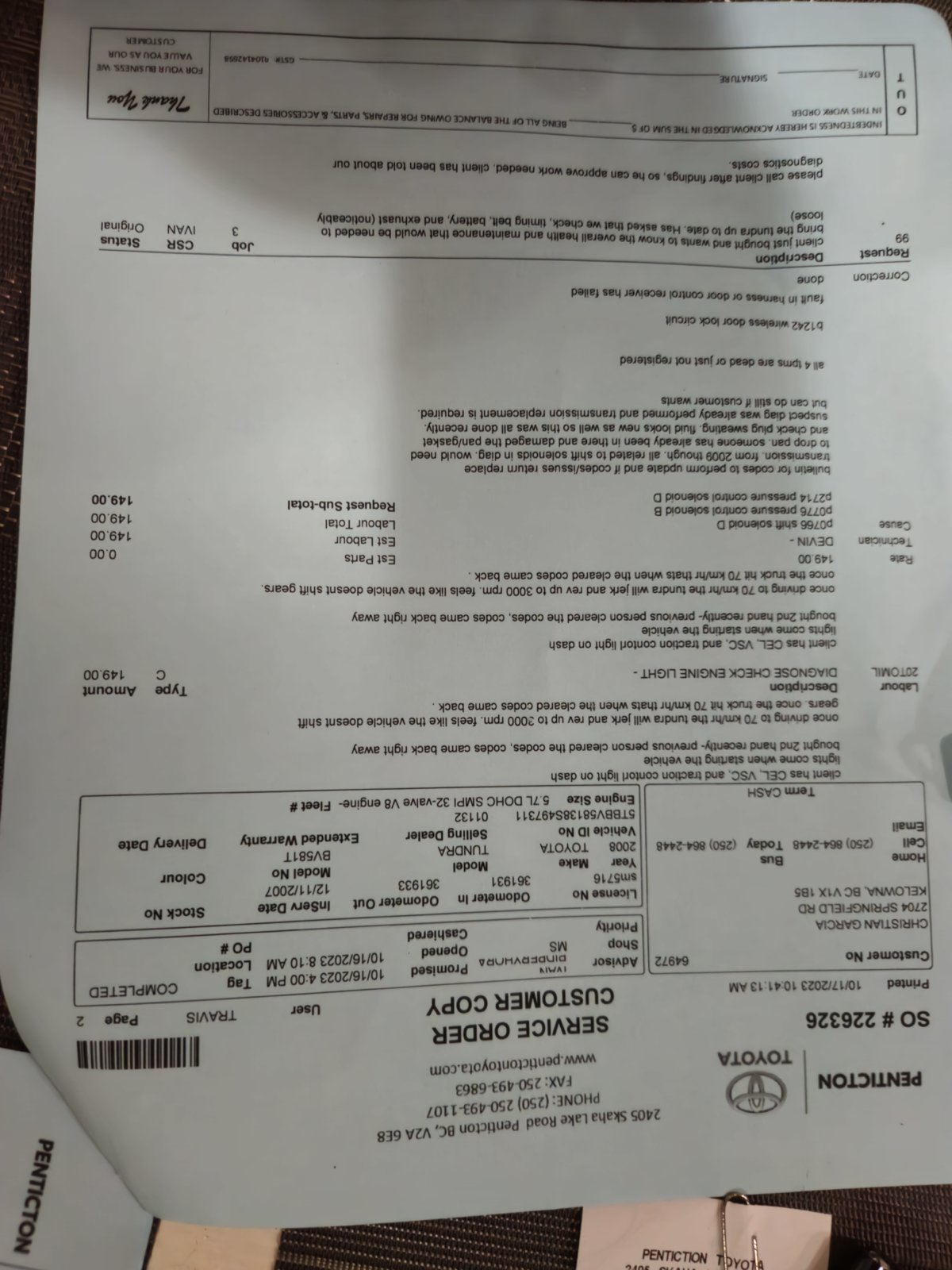

    And I think the TSB the dealership is mentioning with the transmission problem is attached below. It looks like a re-flash may solve the problem, though the problem can be caused by low transmission fluid also, and it can be due to other more-catastophic failures. This may be why the seller sold it to you!!
    I'm not sure if that's something an independent shop can do, so you may actually want to pay a dealership to handle that ... (Edit: I also see the TSB has been superceded and was stretched to impact '07-'09 models)
