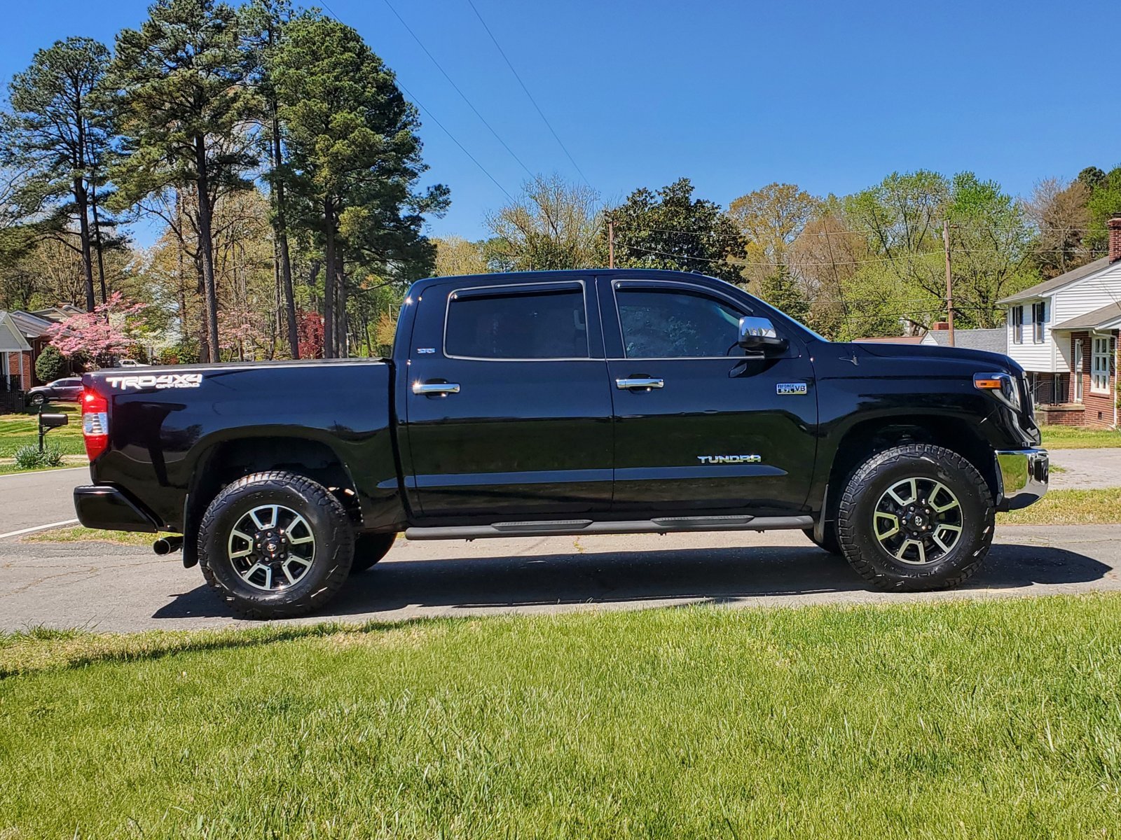

    This is close, 285/75 tires, stock wheels, 2 inch lift in front and 1 inch lift rear. No rubs, still have mudflaps and no messing with inner fender. Did trim the skid just in case.
    If I had wider rims, wheel spacers or different offset, Id have to lose the mudflaps and maybe push the inner fender. My brand of tires have thinner tread area vs wildpeaks and some others so tire brands that run wider will need more tweaking, just like lower offset wheels. Tires are 34.8 tall.

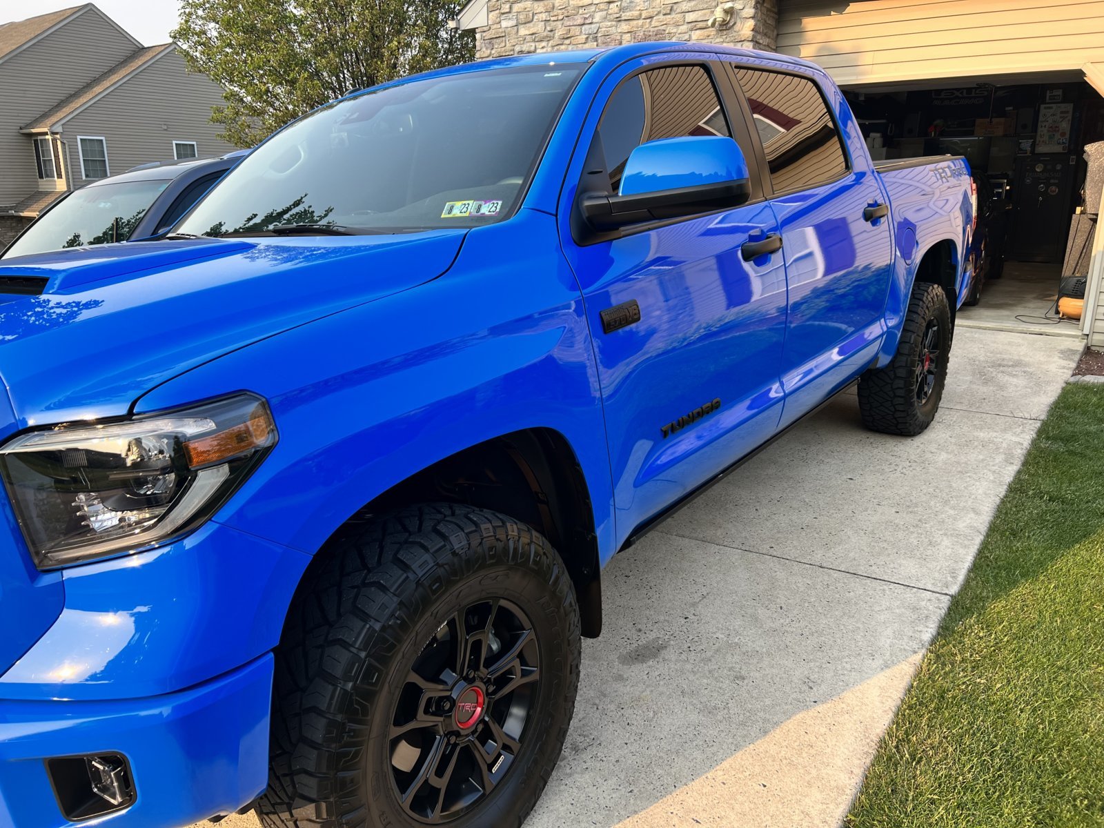

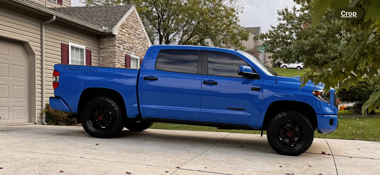

    295-70-18 nitto ridge graps and Westcott lift with the factory pro suspension, so extra 1.7 up front and 1.0 inch rear, removed little flappy thing in front of front wheel, no wheel spacers
