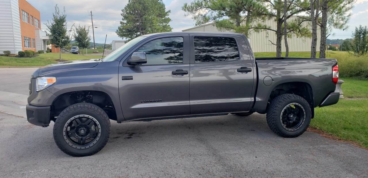

    Here's a shot of my truck. 34's were the plan either way I went. Trying to decide between 275/65/r20 or 295/70/r18. Leaning towards the 18's for a touch softer ride but 20's look so good

  7. Sep 23, 2019 at 8:12 PM
    50,708
    Love those wheels
  8. Sep 23, 2019 at 9:46 PM
    Ely010606
    Ely010606 New Member
    Aug 27, 2017
    #9286
    4,042
    SPARKS, NV
    2017 QS SR5 CM TRD 4x4
    Pretty BA

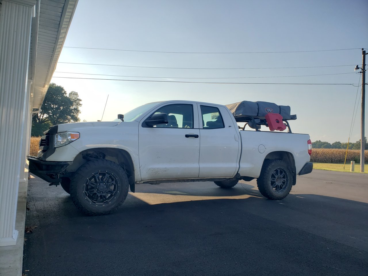

    Go bigger, these are 275/65r20 on 6112's at top setting and 5160 rear with 1.5 lift
    I'll be going bigger next time

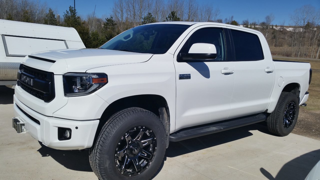

    59.jpg I'm running 295's on mine but they rub the inner wheel well liners.
