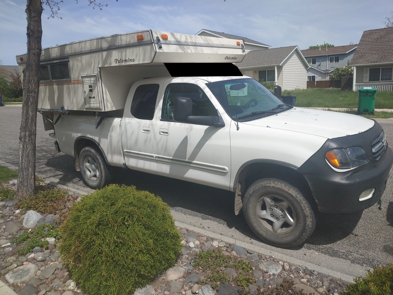

    pics of the truck! How aero is this pop up?

    Better than a hardside, but not by a ton. From this angle it looks like its squatting the rear end, but in reality its pretty level, maybe even a little rake. I took it out of OD pretty often, and as for elevation, I'm sitting at about 4,800 ft. I can also say that all of the suspension work was well worth it, because it still rides great.

    Adjust your headlights. Thats pretty nice, but extra aero tax.

    I have a feeling that part of the struggle is the shape of that camper. Your truck is essentially driving with an open parachute. If you dial the speed back to around 60-65 I think it will ease the resistance considerably.

    Need to fashion a wind deflector of some sort for this gap between the cab and camper. Or at the leading edge of the cab with a roof rack bar and a wind deflector maybe. Would help with aero.
