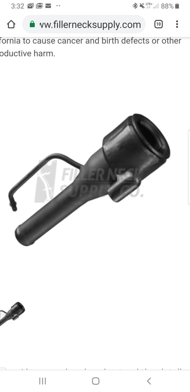

    Check the fuel filler neck.
    The neck has the return line and the port where you stick the gas pump handle when you fill it up with gasoline. The return line is known to rust and get pin holes... throwing leak codes. The return line hose itself may also be crackin and brittle causing a leak. The hissing sound could also be where the return line hose hasn't been clamped hard enough which would explain the hiss.
