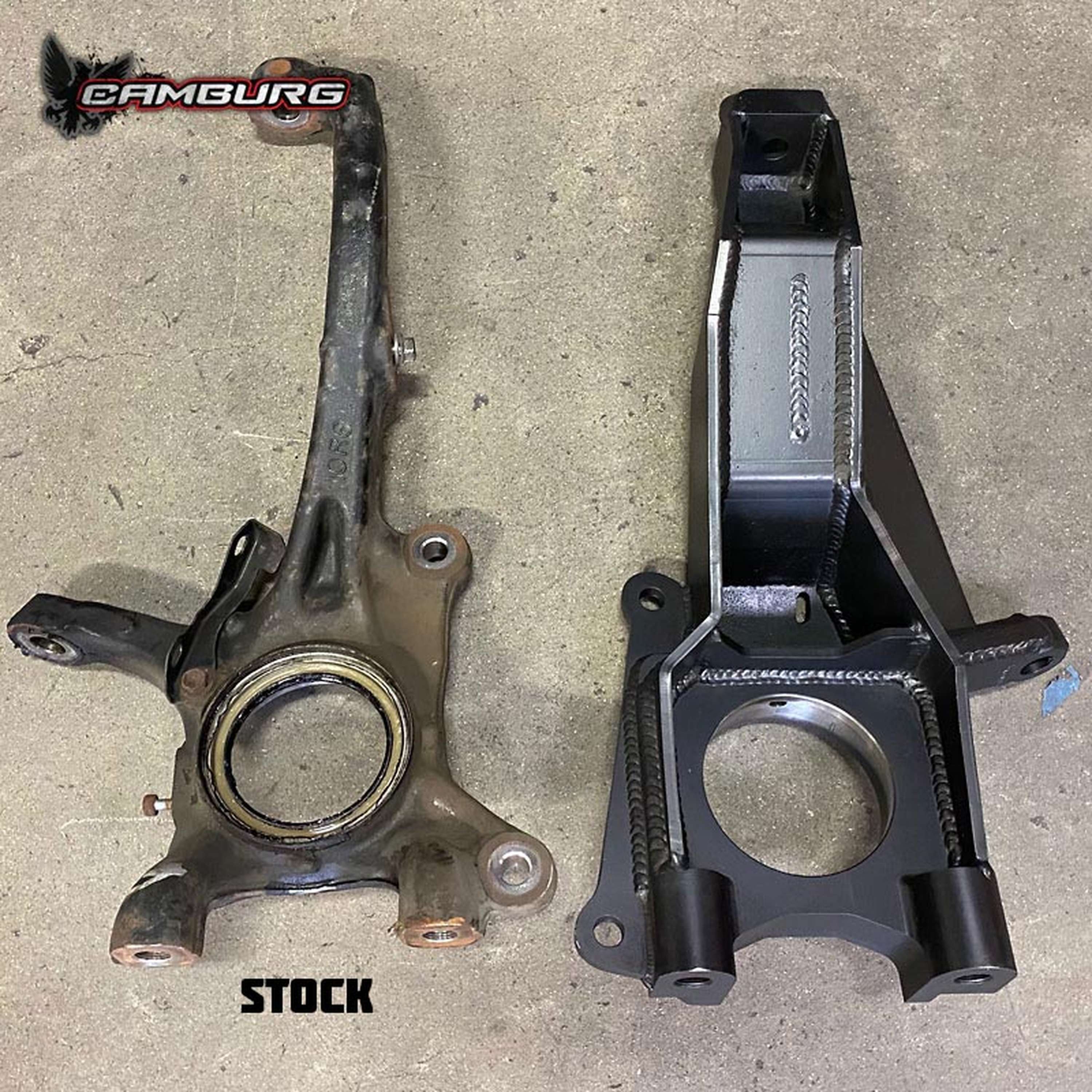

    You'll also need to either find a set of used OEM spindles/knuckles for sale online or upgrade to an aftermarket pair like the camburg ones (even more money)
    The wheels you have are also going to just increase stress on everything suspension related. -44 offset increases the leverage your wheels and tires have on everything, which definitly becomes amplified with a long travel kit.
    The only thing you have currently that you'd really be able to retain would be the ADV glass, which is probably the cheapest part about long traveling a truck lol.

    Anyone know if you need to replace the knuckles if you return the crossmember to OEM location?

    yes you will need replacement knuckles as well

    Yes your bds spindles won’t work

    he'll need new spindles depending on which kit he has no?

    Yeah figured I would need knuckles too.
