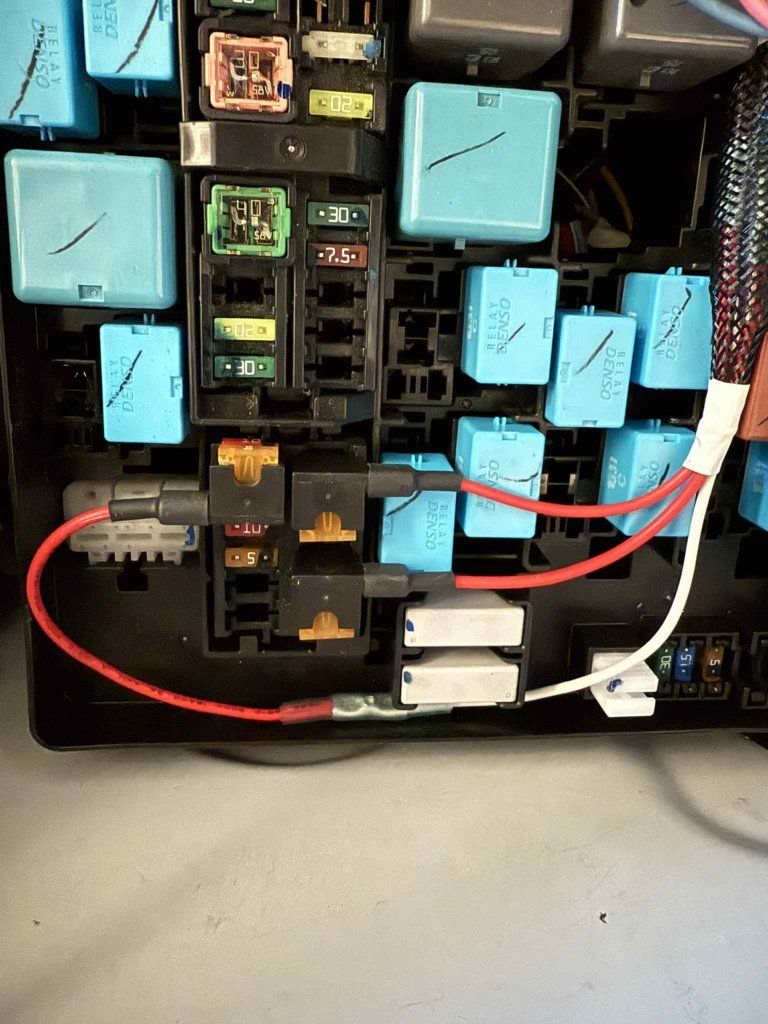

    I noticed that my Switch-Pros isn’t working properly in my 2020 CrewMax. After driving awhile, I’m not able to turn on anything, unless I have my phone hooked up to it via Bluetooth. So I check the ignition fuse under the hood and getting good constant voltage. So I have the blue wire from the Switch-Pros hooked up to the 10 amp ignition circuit with a 5 amp Add-A-Fuse , I have the white wire from the Switch-Pros hooked up to the 10 amp LED RL circuit with a 10 amp Add-A-Fuse and then the pink wire from the Switch-Pros hooked up the LED LH circuit. All three wires are hooked up to the fuse box under driver side. The weird thing is that when I pull into the gargage my auto headlight, parking lights etc, comes on everying works fine, then when I pull out of the garage into daylight everything shuts off. It works fine when it’s dark outside and the lights on but I have to have it hooked up to Bluetooth in order for it to work. Looking for any help please. Thanks

    If it working when you pull into the garage and your auto headlights come on and also working at night when your headlights are on it sounds like the fuse you are tapped into with the ignition wire may be related to the auto headlights in some way.
    There are three LEDs on the power module next to the four pin connector, when it is not working what ones are lit up?
