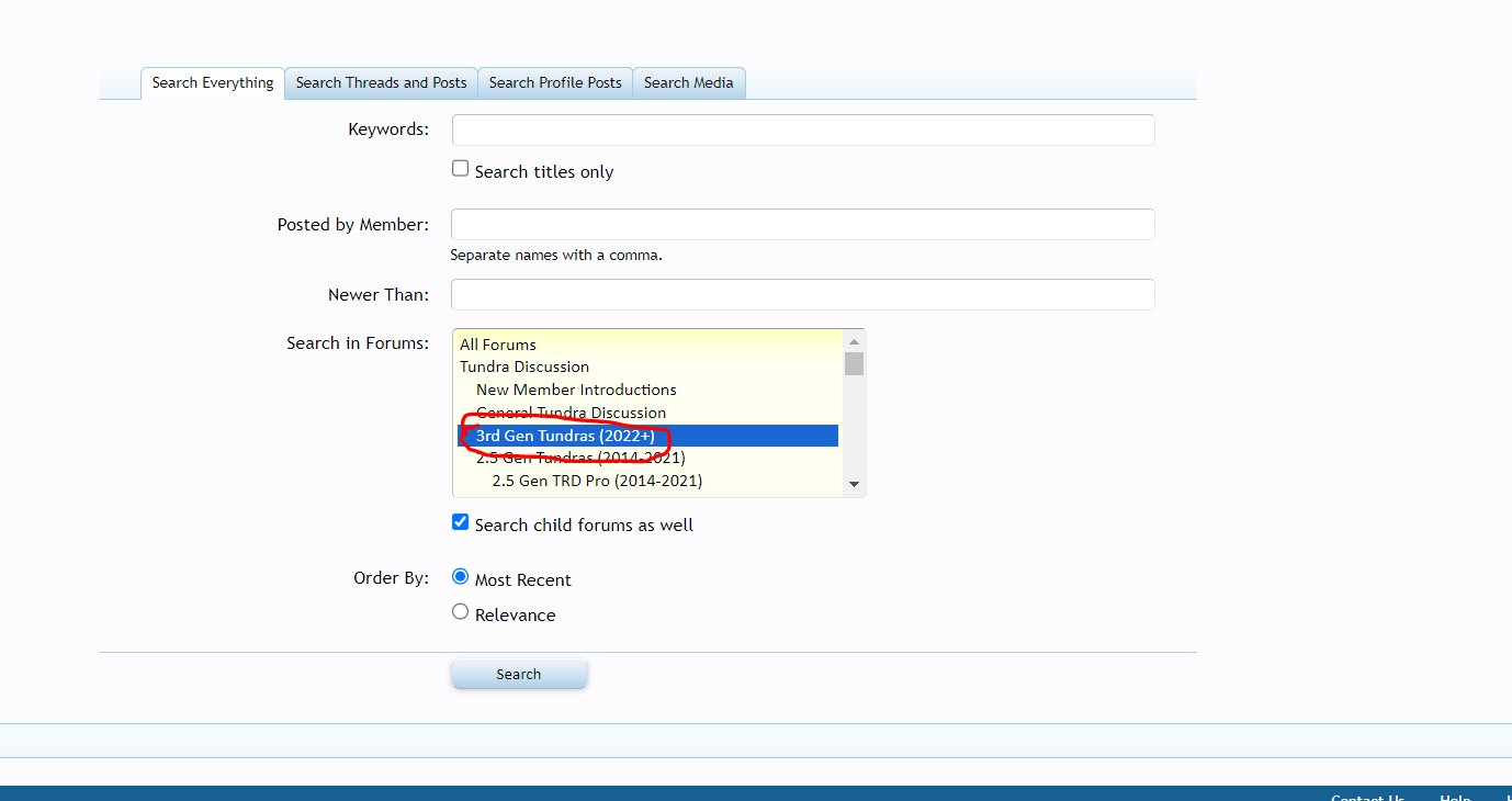

    If you want to zero in on specific topics familiarize yourself with using the search function on here to narrow down to specific topics and you can also narrow it down to 3ed gens too. Everything you asked has been discussed to death.

    For lots of us, that IS helping the new member out. The search function here is beyond fantastic. You can restrict to thread title only to get entire thread results on your search topic, you can search one particular subforum, and you can search posts from any member(s). Hit "Advanced" in the drop down menu, and you can pick a date in the past and only search posts made since that date. Plenty of times I'm trying to find something I know I read in the last week or two. GREAT feature. And there is so much more than what you or I could fit into a single reply.
    I'm not saying don't reply to the newbies; but suggesting the search feature is not a dick move. This search is awesome, and I think a lot of new members don't try it because they expect it sucks like other forums' search features.
