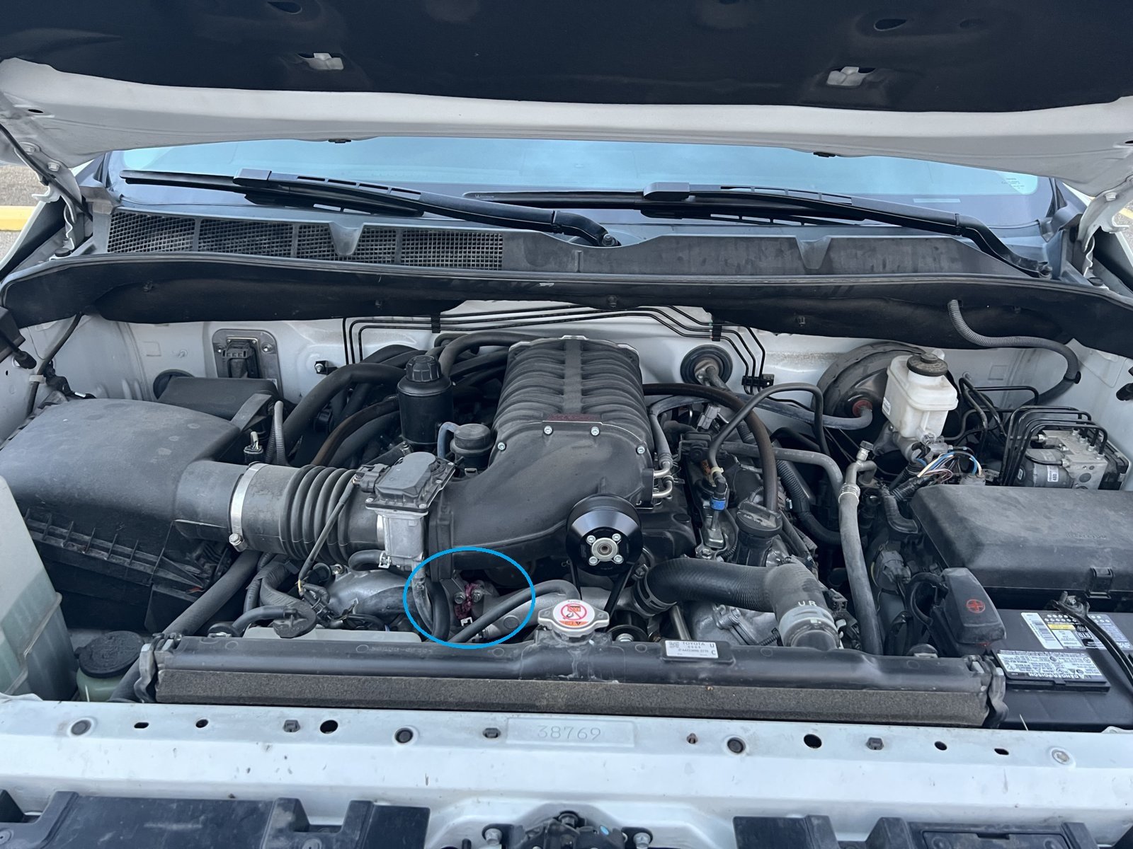

  26. Mar 28, 2024 at 12:01 PM
    #26
    ssmokedz
    ssmokedz Toyota Master Diagnostic Technician
    May 9, 2019
    #30282
    302
    Shelton CT
    2019 Super White Tundra TRD PRO
    I don't know if you saw it or not but you've got some coolant crusties there you gotta take care of.

  29. Mar 28, 2024 at 1:34 PM
    #29
    nobodyintexas
    nobodyintexas What?
    Jun 22, 2020
    #48303
    6,381
    South of Houston
    S/C'd 2020 White 1794 Tundra
    good eye.
    It hasn’t gotten any worse since I originally had the darn thing installed
    yes, I’m lazy
    reywcms likes this.
  30. Mar 28, 2024 at 1:35 PM
    #30
    Ctaylor76
    Ctaylor76 New Member
    Jan 4, 2024
    #109675
    153
    Chaz
    Houston
    2021 Tundra Supercharged
    BDS 4.5 inch coil over lift BDS UCA’s 35 inch ridge grapplers AT 20 inch methods with offset 5.29 Nitro Gears ARB rear air locker with dual stage air compressor RC switch panel Both bumpers are RC LED Bumpers (6 pods and lower LED light bar) AMP Research power steps Lower RC Tow hooks B&M Transmission Pan CSF Radiator Radium Duel Catch Can BDS recoil traction bars Helwig adjustable rear sway bar Retrax Power Trax tunnel cover NSV LED front light bar Morimoto XB LED Head lights DOOD Rear smoked LED Tail lights (Amazon) NSLUMA Smoked 3rd brake light (Amazon) Morimoto 4 Banger LED A pillar lights Boostautoparts LED tow mirrors w/ power fold (smoked black) Full 3 inch true duel with XF Flowmaster mufflers custom Vbands Steelworks Longtube Headers RC seat covers OEM Audio plus full sound system duel sub 13 inch Phoenix Automotive In dash screen Stater X remote start system Uniden R8 Radar detector Odyssey Extreme Battery RC Seat Covers RC Rubber Mat Bed Cover Full body color door handles & TRD Grille OEM Magnuson TVS2650 Supercharger
    is that just a gasket leaking or why is coolant coming out of that area ?
