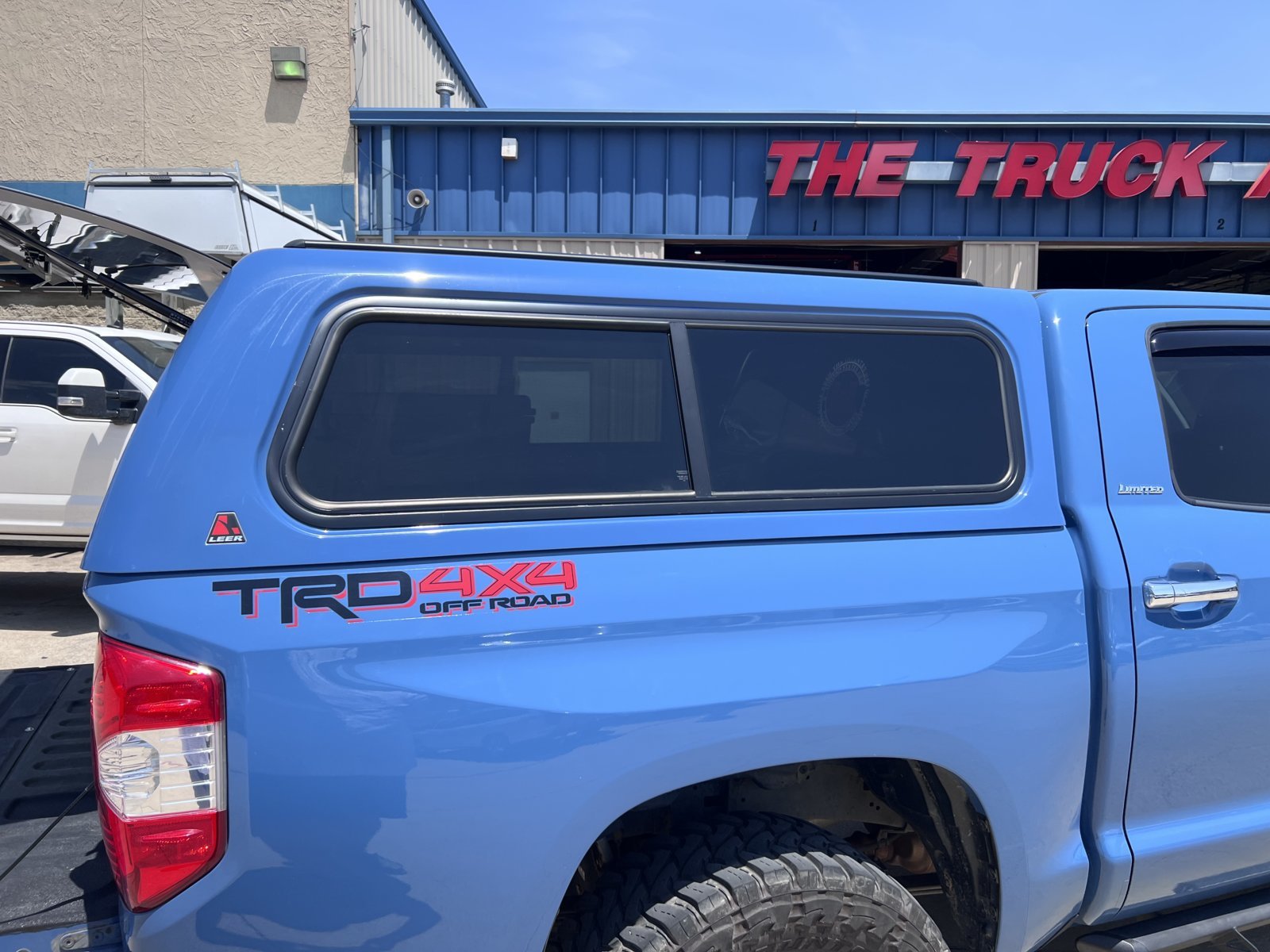

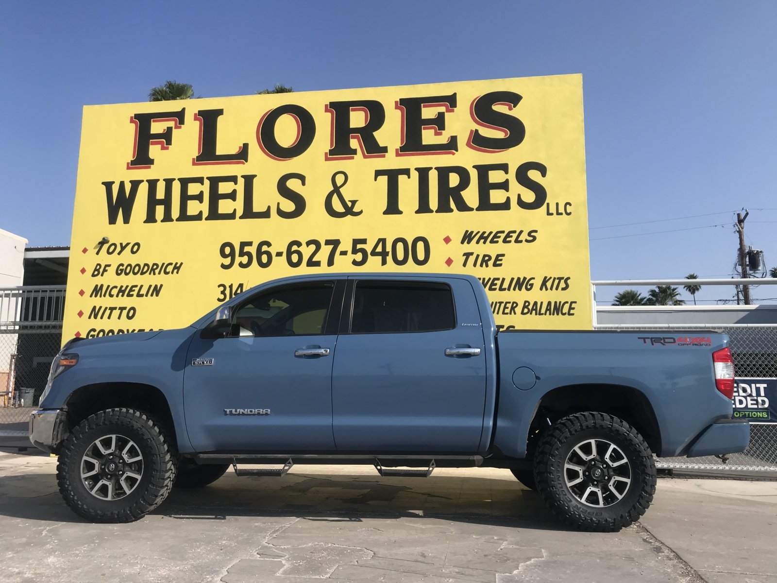

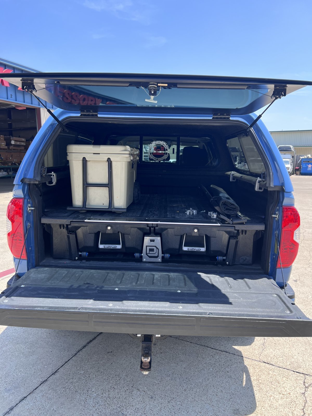

    Hey guys. So here is my Tundra. It’s basically stock. I’ve done a Ready Lift SST 3” front 2” rear on 35s. Since I’ve added the lift I’ve added a deck system and a camper shell. I’m wondering if anyone in the group can give me some advice. I think the rear is over loaded with the extra weight, especially if I add a trailer to it. So what options do I have to help with this sag in the rear?

    Get your truck weighed (loaded and unloaded) to determine your payload and compare that to the GVWR of your truck. You'll also want to determine the tongue weight of the trailer (loaded) you are looking at.
