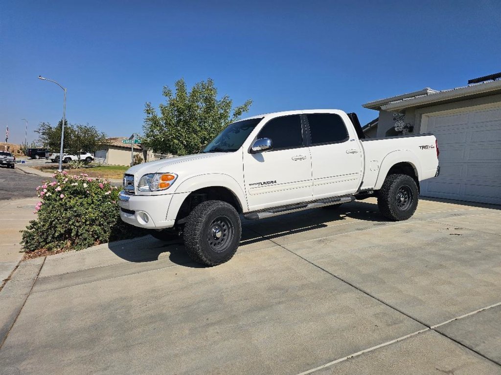

    Here's a pic of the truck I took when I went to see it:
  6. Sep 16, 2025 at 8:41 PM

    That kit you linked is the better of the 2, the shocks are likely trashed just FYI. Not great quality to begin with I don't think. From that picture it somehow doesn't seem too look tall enough (gap between tore and fender) to be the 5...

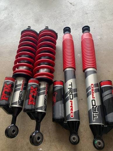

    If i needed a longer shock i’d be searching for a set of the trd fox shocks from the turd gen trd pro. No clue about how they ride, just for the cool points.
