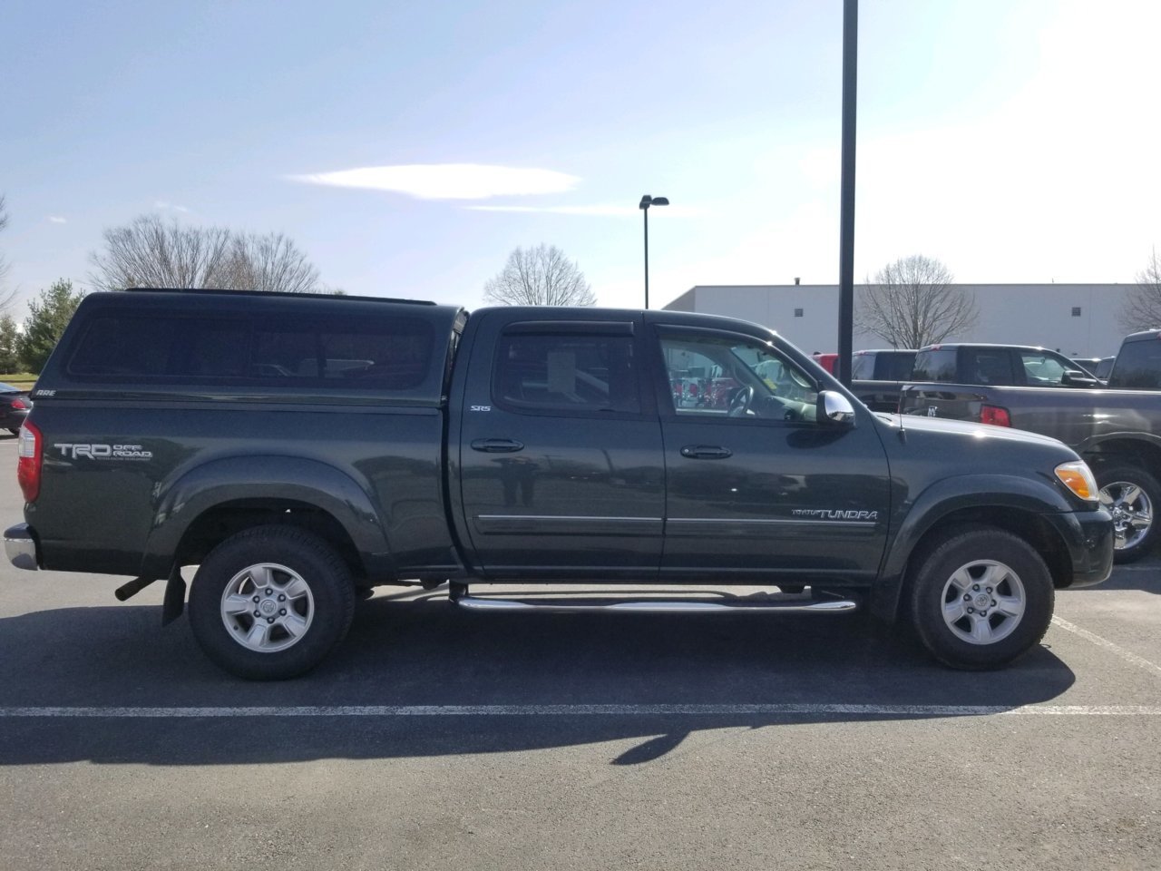

    Good afternoon everyone. First and foremost, I'm a new member to the site.
    I currently own a 99 taco with 200k+ miles on it. I'm looking to "upgrade" to a first gen Tundra for many reasons. From the research I've done, I've narrowed my search down to a 05-06 Dbl. Cab.
    For my area, they are priced around 10-14k averaging 150K+- miles. I however found a 2006 with 83,000 miles on it. 2 owner, clean history, service records, etc. etc. etc. It has the TRD off road package and a color matched ARE cap. After negotiating with the dealership, I have an out the door price (tax, tags, title fees) of $16,250. It seems steep, but its still within the KBB fair purchase price.
    I'm looking for opinions on the price. Would you all suggest I buy it, or jump ship and look for one with high miles and cheaper. Any feedback is appreciated, Thanks!

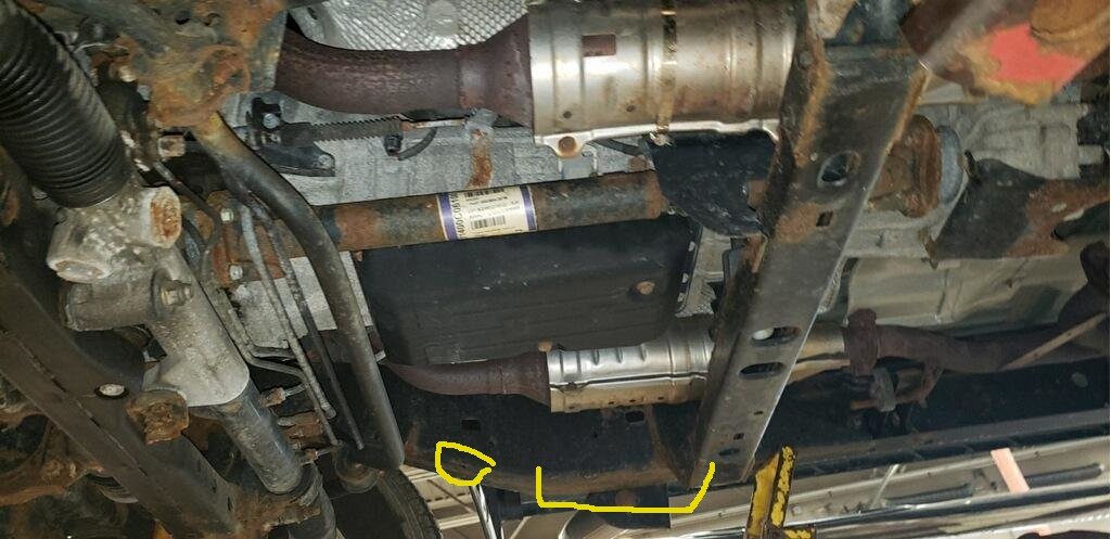

    This is the frame. It looks okay, but I might not know what I'm looking at.

    Looks like it might be on the edge of no return. I’ve seen way worse. I’d need tighter pics inside and down the box frame at front tires and ones of the rear cross-member where it ties into frame.
    You could be eligible for a new frame if not already sprayed under the ‘recall’.

    So I bought a Tacoma from PA a few years ago. The frame was worse then that but solid. I cleaned it all up and made it look halfway decent. The problem was all the bolts were so rusted it made it a pain to change anything. Brakes, shocks, rear leaf springs and was going to cost me an arm and a leg to get just the brakes fixed. That frame doesnr look terrible but how are the small components.

    Check out the frame really close for any serious rust issues.

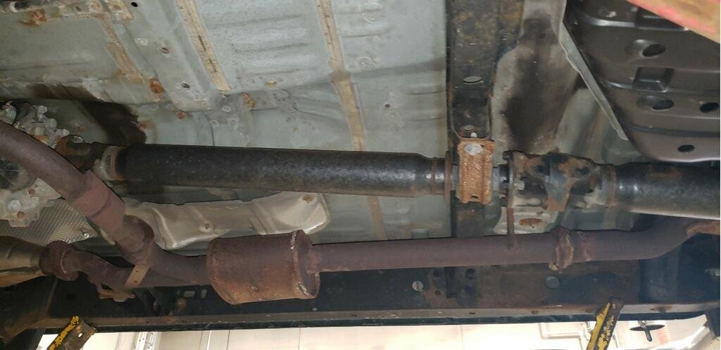

    Small components look okay other than a few rusty bolts pictured. The rest of the frame looks good with minor surface rust. I'm calling Toyota to see what the recall status is.

    You won’t be eligible for a frame recall unless there’s holes in the frame larger then a pen size.

    Looks like the layers could be starting to delaminate. If like mine the frame has overlapping layers here. Rust builds from between the layers bulging them out. Depends on how much you want to either work on it yourself or pay someone to clean it up. One thing I think most here will agree on is you will be chasing rust issues the day you buy the truck. I firmly believe the powertrain and most other components are good for 500k with DIY maintenance, but you need to keep up with the rust to prevent frame from rotting away long before you hit 500k. That's just the life of a Tundra in area that see salted roads. Like I said, my budget was 10k, otherwise I would have gone Gen2.

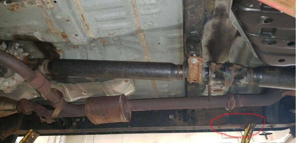

    I'd want to see more detail here as well. Is that a hole that has started? The box sections rust from inside out so the rust along the weld seam would give me pause as well.
