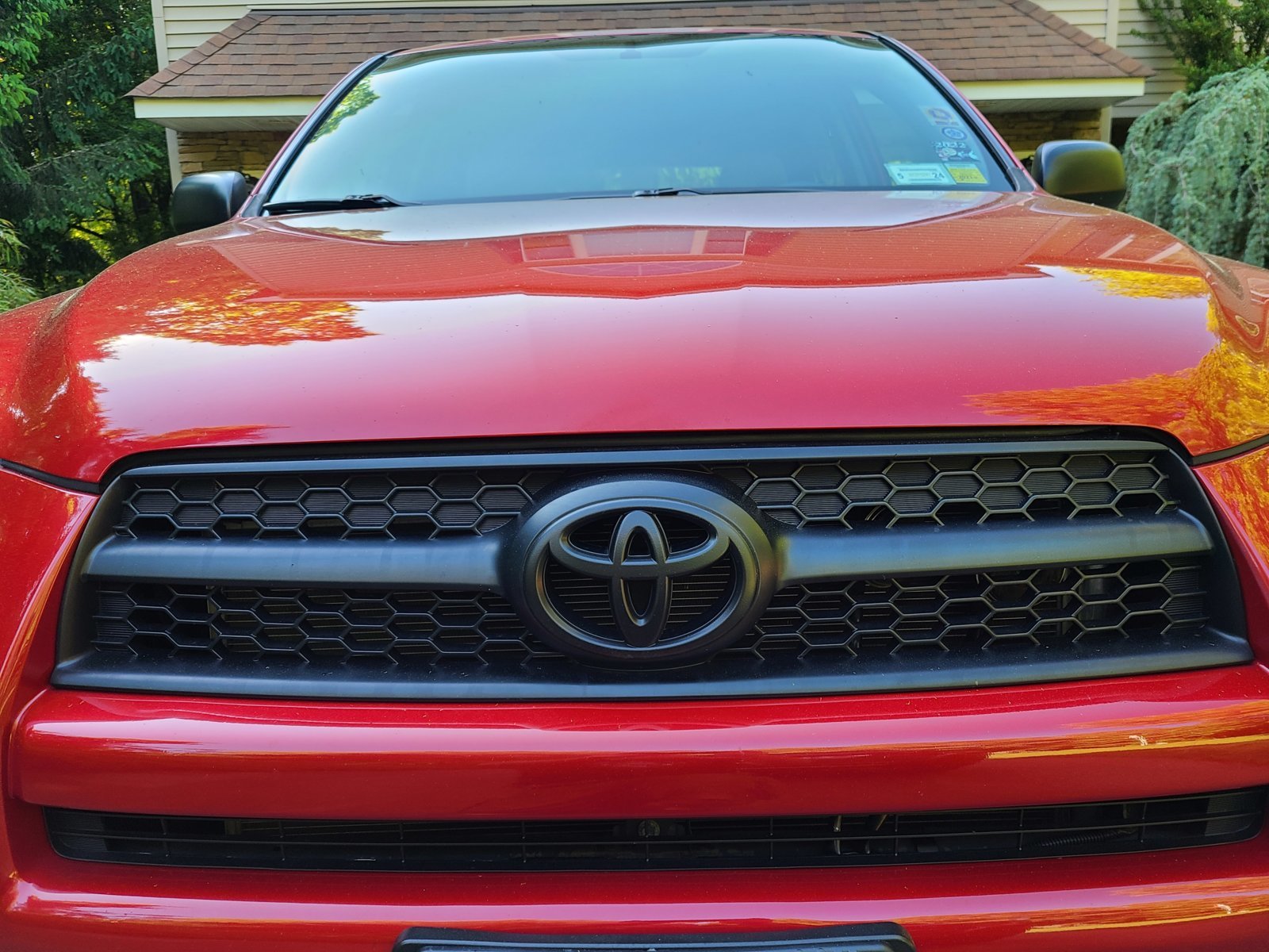

    You don't remove anything. I did my son's Rav4, 2 years ago and still looks great.

    That does look great. Very impressive. You're probably a lot more talented and patient than I am with masking.

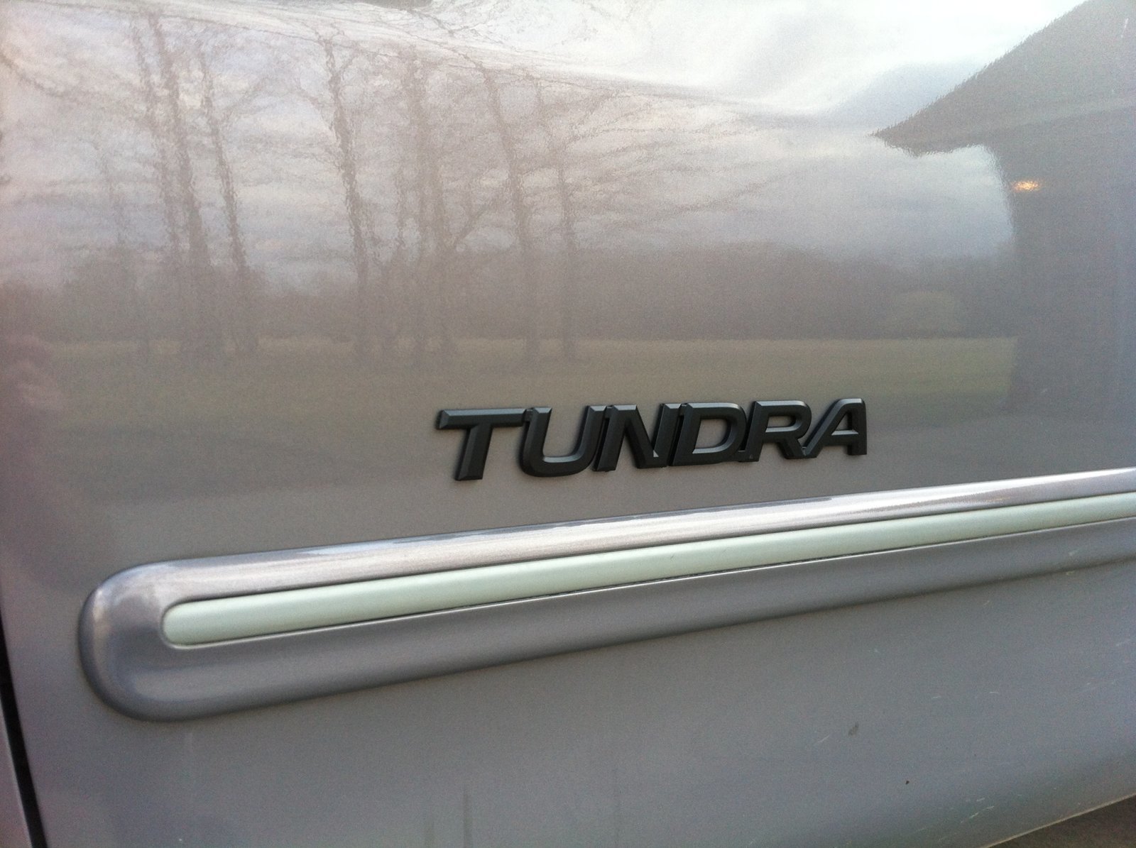

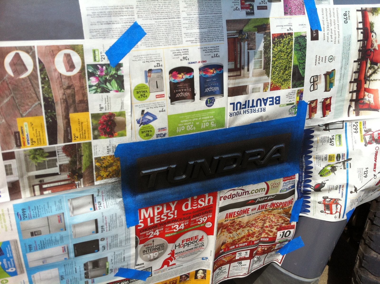

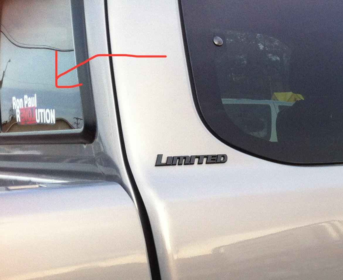

    With Plasti-dip, you tape off a square around the letters. You spray the letters and the square of paint around them. After applying 4 or so coats of dip, you simply peel the square away and the letters stay dipped. Even a slight crease will create a “cut line” for the dip. Really is easy. I dipped my emblems for my 2000 many years ago (like 10) and they still look pretty good. Last pic is “date-stamped” for proof of timeframe. :rofl:

    Watch some videos. After you have about 5 coats you can peel off the excess around the letters, a toothpick is your friend.
