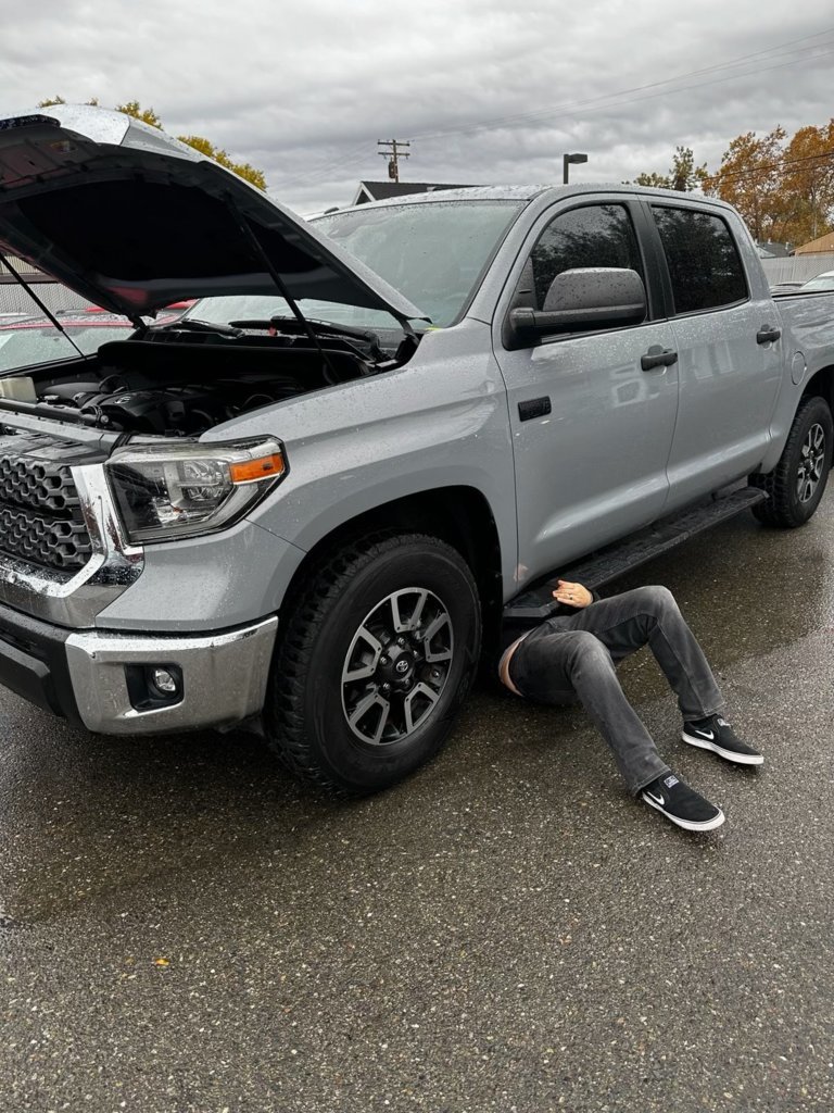

    Hello everyone in the 2nd gen forum. I’ve been on here for a bit in the first gen section. Had a 2005 double cab for 5 years but decided it was time for something newer and a little bigger (have a travel trailer and in the mountains it was just a little to much for the 05)
    I’ve looked at several and even almost bought a 2018 1794 but found it had the cam tower leak. (I want to stick to 2018 or older to retain the trans cooler)
    I found this 2018 sr5 with 67,000 miles and really like it. It is very clean. Feels brand new inside and out. Previous owner put in katskin leather seats. Feels really well taken care of. No scratches at all inside and very little wear outside.
    when I went to start it the battery was dead. Would barely turn over the engine. Sales person brought out a jumper and started it no problem. I looked inside and it showed 14 volts and no battery light…..ok just had something left on. Went on test drive and it drove great. Felt peppy and tight and new. But I realized the tun signals didn’t work. It would make a fast clicking noise but nothing on the dash. Got back and walked around and no turn signals. Turned it off and it would not start again. Dead battery. Sales person said we will put a new battery in and fix the turn signals. Battery was dated 6/24 from Toyota…..not that old.
    As I left the tech was working on it and had a big laptop plugged into the truck.
    We signed paperwork but haven’t given any money till it’s fixed. He called back and said the blinker relay had gone out and they were getting a new one from Toyota. Only $20 and should be fixed in a day. I crawled all around and under it. No cam tower leak, dry as can be, and looks very clean underneath. Didn’t see any flood type stuff. The truck is from Alabama.
    sorry for the long ramble but just trying to get all the info out. Anybody have anything like this? A bad battery frying a blinker relay? Or should I be worried about electrical gremlins?

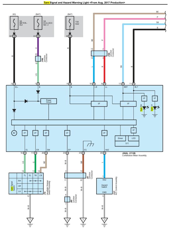

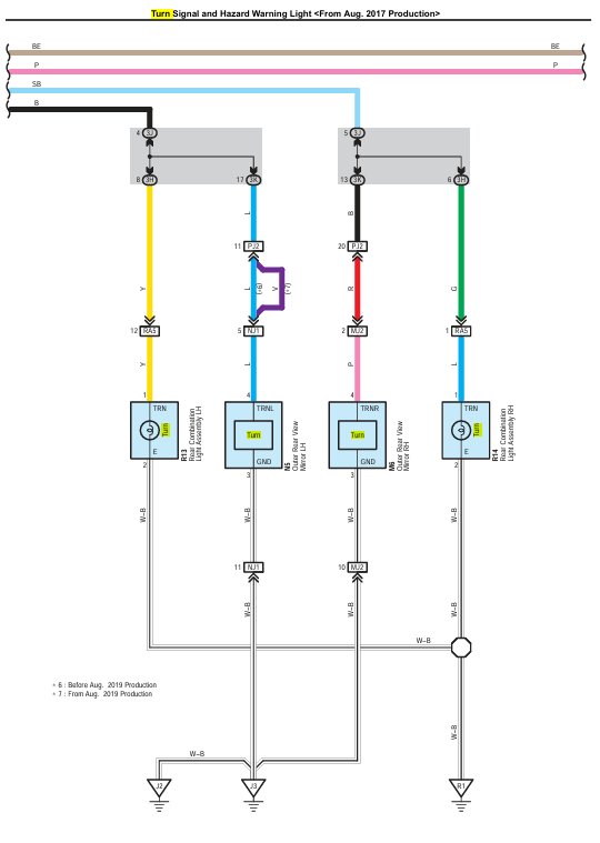

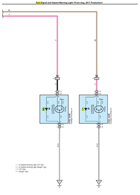

    These trucks are notorious for corrosion on the battery clamps.
    You may have found that on your 2005, I did.
    The thinnest film of corrosion can cause issues.
    As to the turn signal 'relay', it has an electronic flasher module.
    There is no single $10 relay.
    The part is around $75.
    2007-2018 Toyota Flasher; Flasher Assembly 81980-0C010 | Sparks Parts
    As @Blast Chamber stated if the hazards work, the turn signals should work as well.
