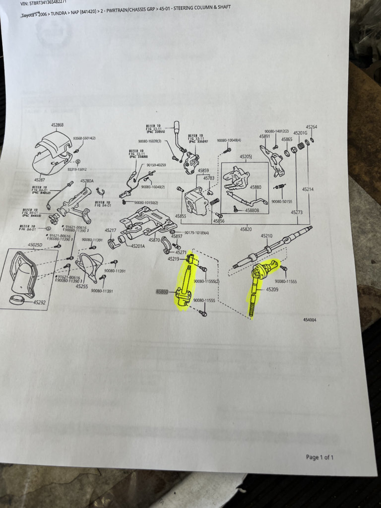

    Hey guys. I have a 2006 Long Travel Tundra where the steering has been giving me issues. In the morning when i turn it on i really have to force my steering wheel left and right to loosen it up. It's NOT the anti theft lock these trucks have. I took it to my buddy whos a toyota mechanic and he states it could be the steering shafts that connect the steering column to the rack and pinion. I uploaded a pic of the part number below. The issue is that toyota doesnt manufacture them. Has anyone had this issue that could direct me to a spot where i can order them aftermarket? We are replacing the Rack and Pinion as well. I attached a few photos of my truck. Any help with this is greatly appreciated.

    fluid is good and wasnt missing any. Its a mechanical linkage for sure. My mechanic said its the steering shafts for that year truck but i checked a few spots online and they dont have them, only for the double cab. It only happened when i first started the truck. after a few minutes and the oil gets warm it goes away.
