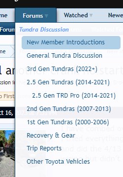

    I hope you've found the tabs at the top of the site, but if you haven't look for the Forums tab with the down arrow beside it. Click on that arrow to get to where you want to go.
    The search function at the top right is also very useful. This site is arguably the best source of Tundra info to be found anywhere, including Toyota's site. TONS of info for those willing to search, and a TON of awesome members willing to help you.
