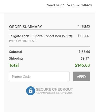

    Just a heads up on the part #s and application on these; it seems to be a little confusing (parts guys wasn't even sure), but the instructions seemed to clear up fit a little better. My part # was PK3B6-34JS0. I have a crewmax w/5.5 bed (145" wheelbase). The parts guy and I originally thought the "S" designation in the second half of the part number was addressing short box or 5.5ft bed; vs long bed (box) However, we found that in reading through the instructions and fitment guides that "S" actually was indicating a part for
    'standard' wheelbase. The wheelbase is the same for crewmax 5.5 bed, dbl cab 6.5 bed, and std cab long bed (8') @ 145"; as it only trades space in the cab for space in the bed. The only application that had a long wheelbase was dbl cab w/8' foot bed (164" wheelbase). So we found part # should be the same unless you have the 164" wheelbase. This is because the wiring harness routes under the bed, along the frame and enters the cab through a drain plug on the passenger side floorboard to plug into the existing wiring harness at the front passenger kick panel. So, application differences are simply the length of the plug in wiring harness.

    Sorry, my apologies for anyone trying to purchase online from the same place... The dealer is actually listed as "Lithia Toyota of Springfield".

    Thanks for all the leg work. So you are saying this part number is good for the CM?

    It doesn't matter, the CM and DC have the same wheelbase length.
    His posted link reads it is for either..
    Amazon.com: TOYOTA Genuine 2019 & Up Tundra Power Tailgate Lock Kit Standard Wheelbase PK3B6-34JS0 : Automotive
    @Roman has a better price, even with shipping (at least to Texas).

    Thanks again for the info, tried calling number for Roman , got Franklin Toyota, told me had to order online , but can't find web site. Anyone know specifics on this?
