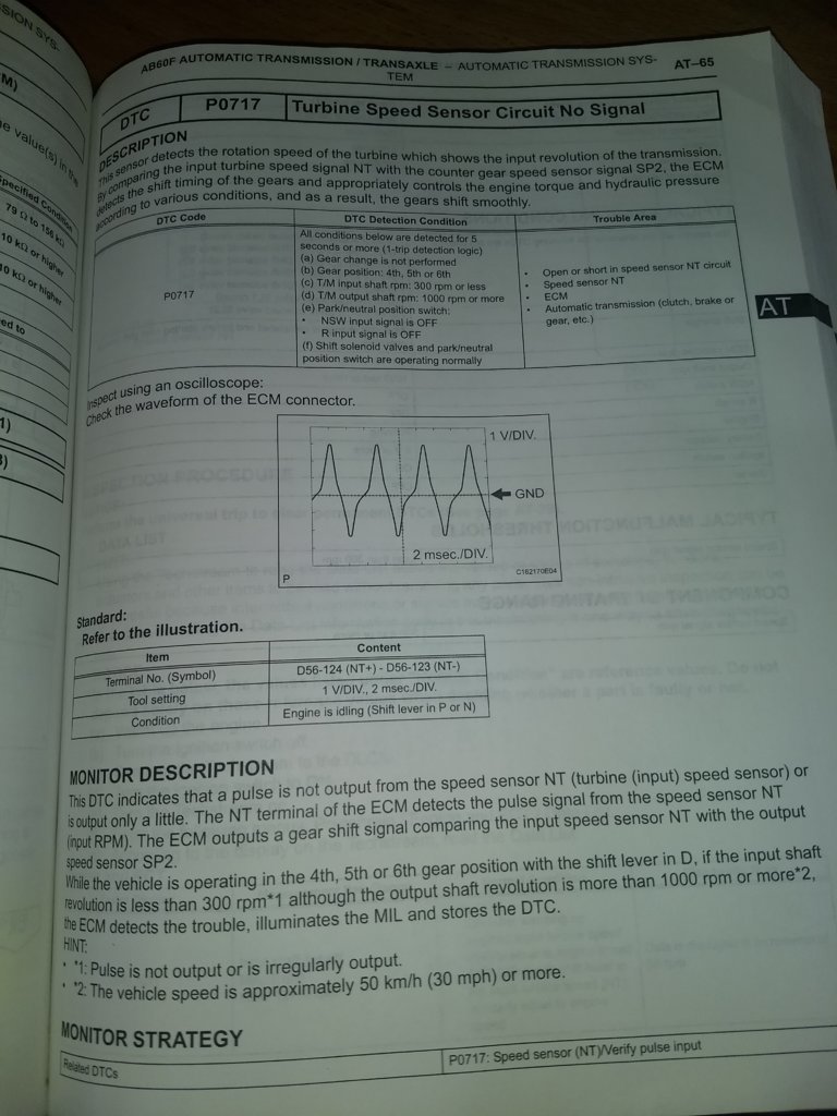

    I got code p0717. It says input/turbine speed sensor "A" circuit no signal.
    So I bought an input speed sensor for my 2012 toyota tundra 5.7 4×4 base model truck.

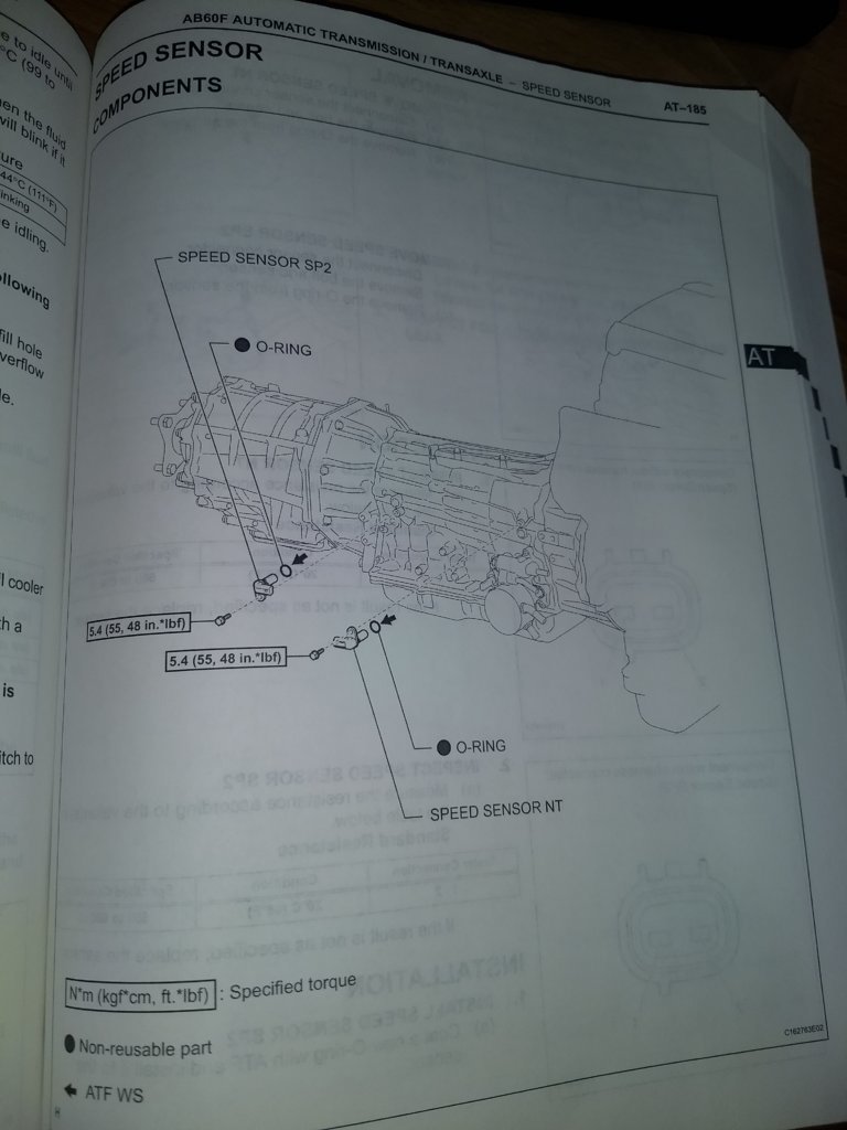

    Can someone please help me figure out where it's located? I see 3 different sensors at my transmission but don't know which 1 the correct 1 is. Can I find a wiring diagram or any diagram to help me find the location of this sensor?? Thanks in advance.

    Speed sensor NT

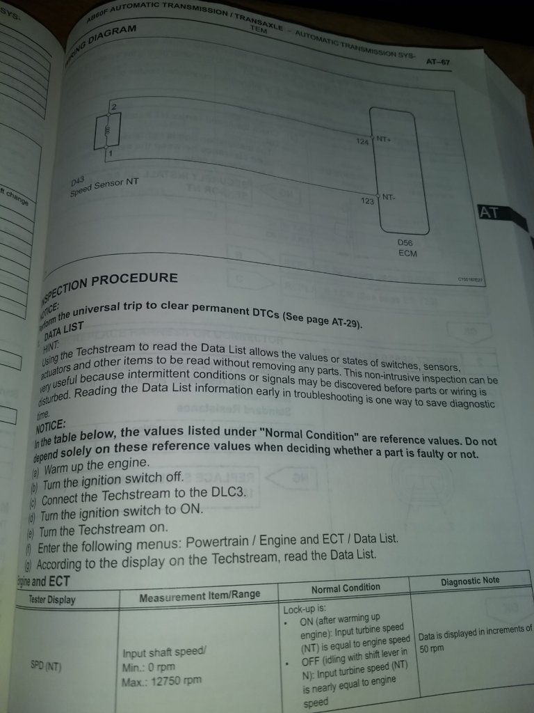

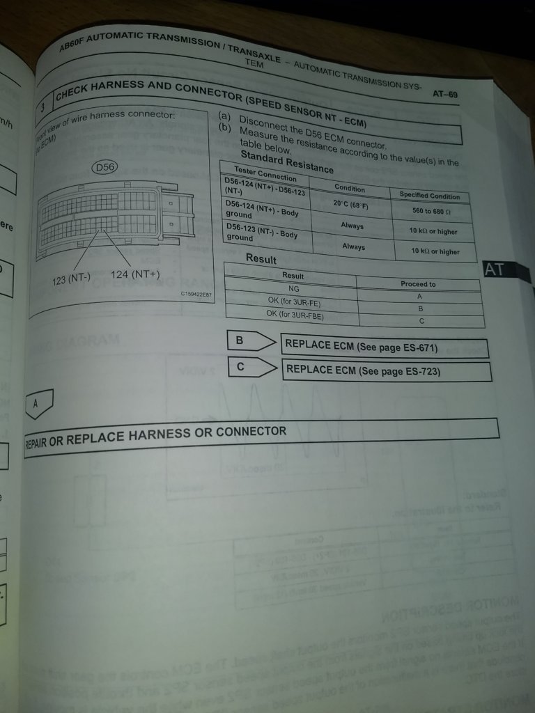

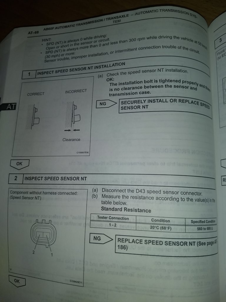

    The whole procedure:
