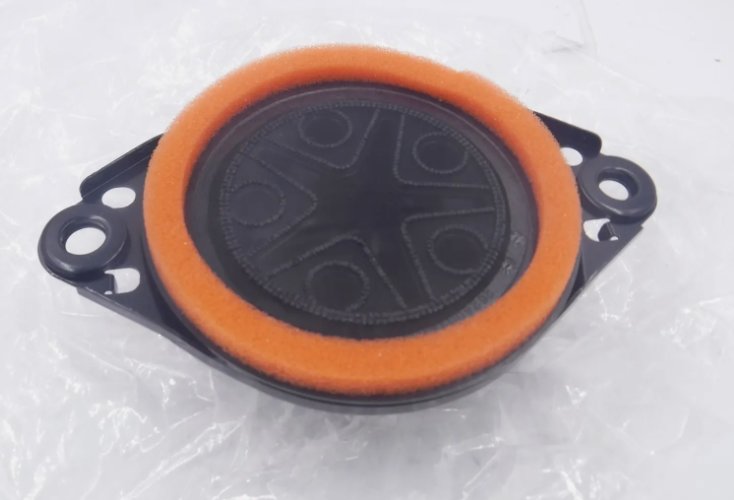

    Idk if I would trust the local shop if they're saying the speakers aren't JBL in a JBL equipped truck. I'd imagine that would be class action lawsuit level if Toyota wasn't putting JBL speakers in when they say they are. The JBL speakers are easy to spot as they typically have an orange surround like this:
