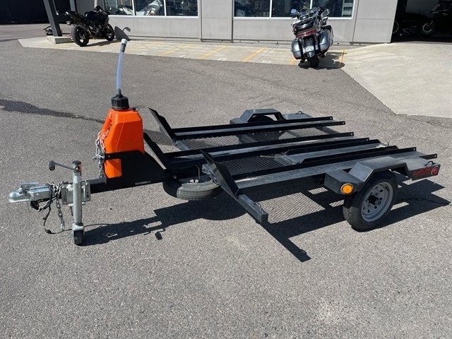

    I already tow a trailer actually to track, but on occasion I need to trailer and also put a bike on the back. Towing 3-4 Bikes in some cases, and the option of the cab is always handy for overflow. 1st world problems. lol
