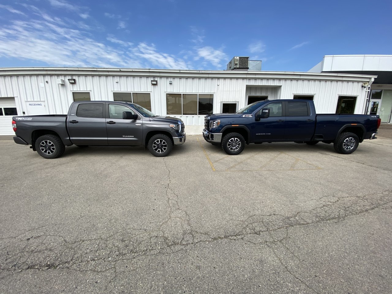

    I feel your pain. I loved my '18 Tundra but mission requirements finally caught up to it and I ended up trading her in for a '21 GMC 3500 gasser. I needed 6 seats and more payload. My Jayco weighed in around 7k the way we had it loaded and with gear in the bed it put the Tundra right at 7200#'s with just me in it. Momma bear would have to follow behind in the van with the cubs and that got old pretty quick.
    Now, if it fits it ships, lol.
    Numbers that I can work with.
