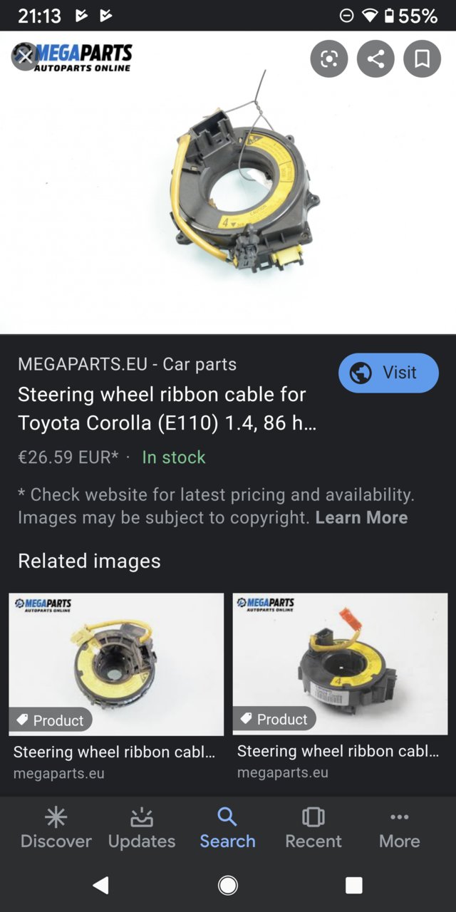

    I'm wondering if you have a ribbon cable in the steering column issue.

    Horn issue is likely a clock spring issue.
    If it still works with the key fob

    Don't know what a clock spring is or a ribbon cable. Where should I start with the horn? As for the pump, I'll be taking the reservoir out this weekend and testing if I am getting power to the pump. Thank you for the feedback!

    The ribbon cable and click spring are the same thing. It's located under the steering wheel in the steering column. Your horn and cruise control quite often are effected when it goes bad.Screenshot_20191111-211351.jpg

    Leading in too many words to my follow up questions; Is going cheap aftermarket ok on the steering wheel ribbon? What website have you found to be the best priced/ quality? AND should I attempt to do the steering wheel ribbon myself or am I getting in over my head with that?

    Not to chase you away from attempting the steering wheel clock spring check but keep in mind that's where the airbag is, so proceed with caution.

    I don't have issue using aftermarket ribbon cables.
    It's gonna work fine or not and you will know right away. If it's bad, send it back.
