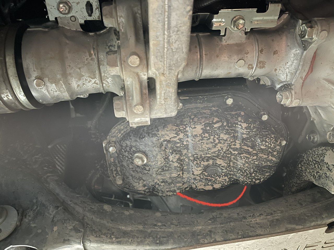

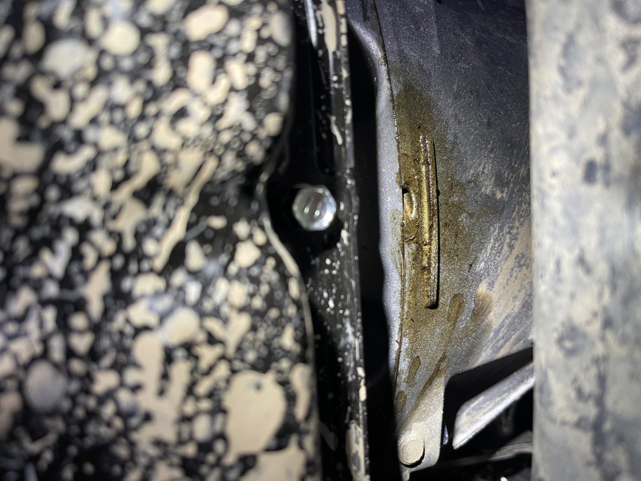

    Found a little oily residue behind the engine oil pan, on the trans housing(correct me if I’m wrong). The only reason why I bothered looking was because I took the truck to Colorado and drove the alpine loop. And while on the loop I smelled something weird. I just couldn’t tell what is was. But something smelled off. It’s not much oil but it is disappointing. Truck only has 3k miles. Purchased july 5467ACFD-447C-4036-B10E-C9F92DF29CF4.jpg242032A5-493C-4916-85AE-493030F55B4B.jpg

    Oh no,
    hybrid? I saw a guy who had something from the hybrid area oozing out.
    hard to see on my phone where that is in your pic. Obviously get to dealer asap
    Hella Krusty and IsaiahCanada like this.

    Non hybrid. Here’s a zoomed out pic of the area 70AD0383-617B-410C-A926-C0D811369168.jpg

    was it serviced at dealership recently ?

    Probably my post here:
    https://www.tundras.com/threads/front-diif-issues.111141/#post-2879722
    Seems very similar, the oil seems to be seeking from the rear of the engine and/or front of the transmission. In my case, the electric motor is sandwiched between the engine/transmission.

    Considering the location, and what looks like a weep hole from Toyota, I wonder if it could be a rear main seal leak. :monocle:

    Could also just be some assembly lube making its way out after being heated up. Is it dripping or just that light oil stain?

    It looks light yellow not red or pink so most likely engine oil in that area. I agree with Tilly, any motor I have ever seen weeping oil in that location points to rear main seal leak on crankshaft. Can you update us after dealer repairs it?

    Agreed, that it could be RMS, but if you look at my post, here, which seems to be very similar or identical to @Bennza, I've got oil weeping both in front and rear of the electric motor that is sanwhiched between the engine and transmission. This leads be to believe that it may not be the RMS, but maybe, like suggested by @Dieseldiagnostics, assembly oil/lube.
    Dealer have cleaned it up and will revisit down the road if still present.

    I noticed the same thing on my 2022 while installing the cat shields at around 500 miles. Dealership inspected and said main seals had to be replaced because it was slightly deformed allowing a small amount of oil to leak. No issues since but now I feel the need to crawl down there and check again.

    They changed it out. Disappointing that it had to be done on a new truck but seems fixed.

    Ooof. I would hate to do an RMS job on a new truck. I've done that job 3x on different XJs. It's a notorious place for leaking on those Jeeps.
    I had some oil build up on my skid plate & cat shield recently. I noticed it after some trails because the oil caught a bunch of dust & dirt build up. I ended up pulling the skid & shield both completely off and cleaned them. I couldn't find any leak or weep anywhere on the engine. I had my truck in for the 10k service earlier that week so I just chalked it up to a lube tech who was messy.
    I'll crawl back under this weekend to see if there any more oil build up. I've got about 5k miles since then now.

    I've got the same issue with my non-hybrid 3rd gen. It goes to the shop tomorrow and we'll see what they say, but my first thought was it must be the rear main seal. based on what i've been cleaning up, I would estimate a good ounce or so per every 250 miles is leaking from the seal.
    A little disappointed considering the truck has less than 3k miles and has not been abused.

    Rear main seems like a possibility. I know it was semi common on the UR motors in the previous gen as I see it come up fairly often on the GX groups. Usually its not an issue and more of an annoyance as it won't leak fast enough to even show up on the dip stick.

    Wipe it off and see if it comes back. Last gen tundra had oil from the factory in a location like that and a few members had to deal with dealer. They wiped it off and it never came back. If it comes back get it fixed.

    Quick update to those who may be interested. I took the truck by the dealership and a shop foreman looked at the truck. I was getting the truck aligned (out of pocket) as I just installed upper control arms and coilovers which of course threw the alignment way off. Got the truck aligned with no issue and they proceeded to diagnose the leak. Foreman observed leak from the transmission bell housing and noted it on the warranty work order. They placed UV die in the oil and said to bring it back in at the next oil change and they would try to pinpoint the cause and make sure nothing else was leaking. Keep in mind, I had a very small engine coolant leak where an o-ring was pinched at assembly (engine oil cooler/heater assembly - part of the oil filter housing), which I was told required two of the three timing chain covers be removed for access, and is evident from all the RTV during reassembly. With that said, i'll not assume someone is being lazy, but trying to make sure they don't have any additional oil leaks before diving into this thing again. My service advisor who is very straightforward and easy to work with mentioned Toyota advised the dealer to proceed accordingly and may be a result of the previous repair, in which they were in contact with corporate about due to the nature of said leak.
    We all know there's only one likely cause of an active engine oil leak from the bell housing weep hole... so their answer was less that satisfying, but i'm hopeful it will get fixed at some point. I did buy my "new" truck (50ish miles) 'used' so there is the 100k mile CPO warranty if all else fails. At the same time, I would also prefer my garage floor not have oil stains from my brand new truck o_O

    Had a similar issue with my 2022 tundra limited with 6000 miles on it . Took it to the dealer and they figured out it was the "freeze plug" leaking .
    The dealer was able to get a replacement part the next day and repaired it. 2000 miles later no problems
