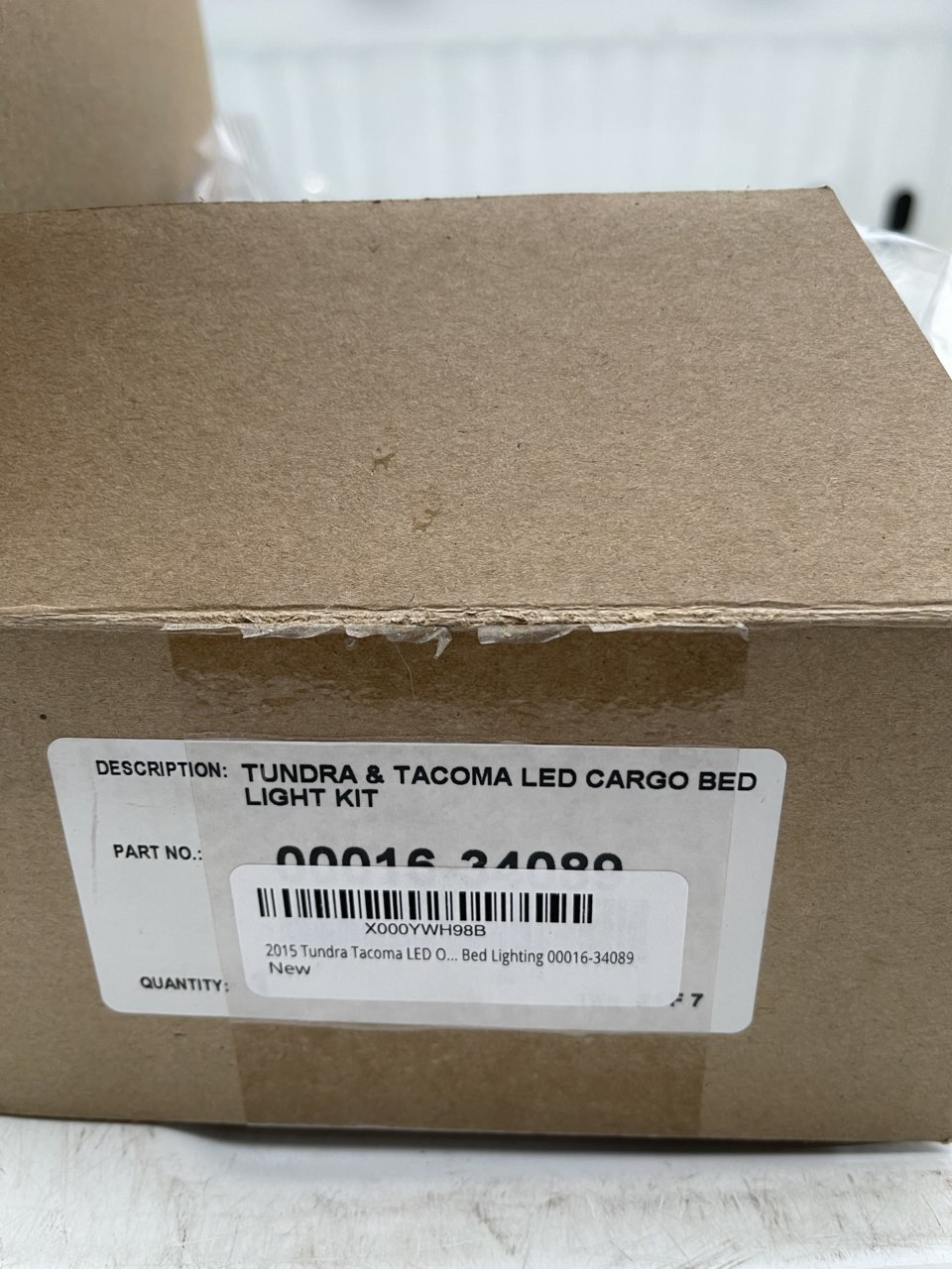

    Does anyone else have the OEM kit? The one I bought is part number 00016-34089 and it looks like it’s possibly meant for the Tacoma. Just looking to confirm before I drill holes in the bed that I have the right kit and the wiring will reach and the connectors will plug in the harness and dash. Thanks for any help!

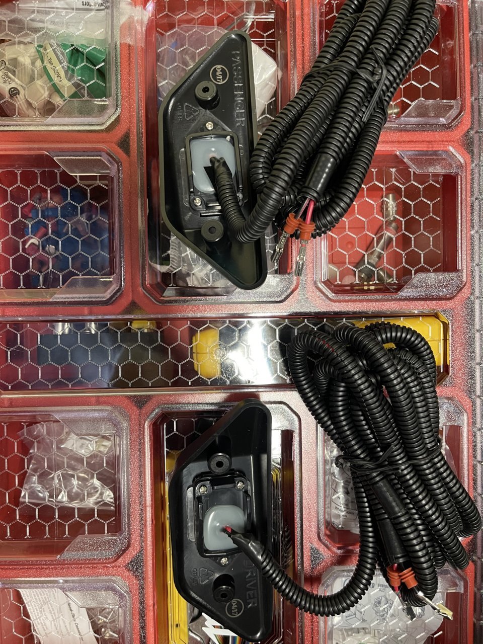

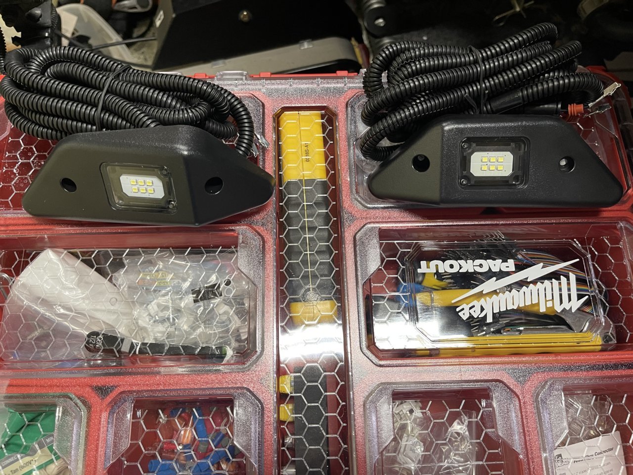

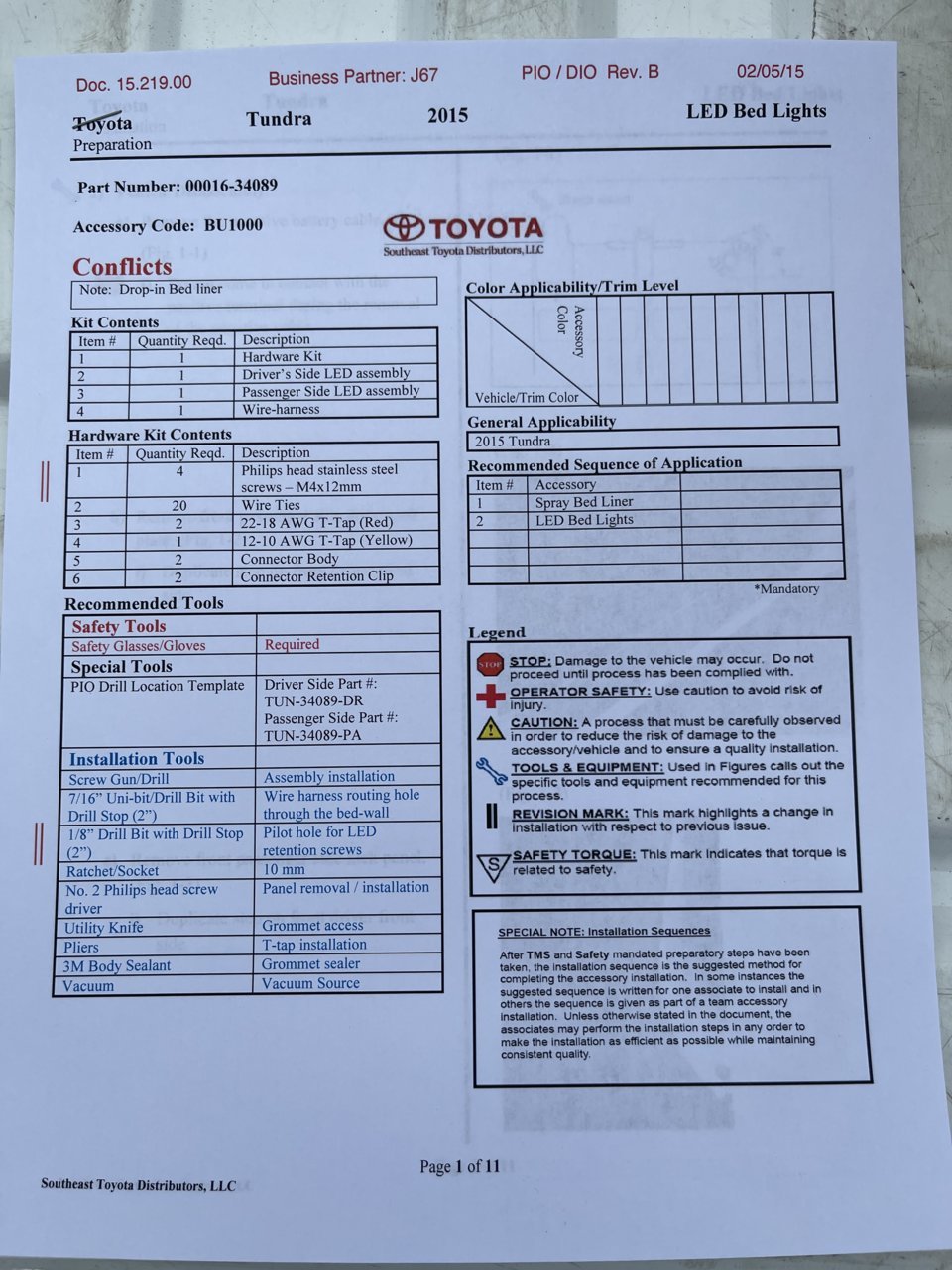

    For sure, what exactly do you want a picture of? When I looked up the part number for the install instructions (which oddly didn’t come in the box) I found 2 different pdf documents from Southeast Toyota Distributors LLC that shows the same part number being installed on a Tacoma and the second document is for the 2015 Tundra. Luckily the Tundra instructions come with a printable drill template. I’m guessing it’ll work, but let me know what you’d like a picture of and I’ll gladly upload it. Thanks

    For clarity, I bought these back in 2017 when I had my 2017 because they were available and I found several posts saying they’d work fine. I never got around to installing them and I’ve now traded in the 17 for a 19 TRD Pro and figured I’d get them installed before the bed cap comes in, right after the liner is installed. I just don’t want to proceed if I’m gonna have a problem. I’d rather catch it before there’s holes in my bed ha! Maybe I should just wait until after the bed liner is installed so I have more time to research this.

    I'm sure they will fit since everything I've seen they use the lights in both trucks.
