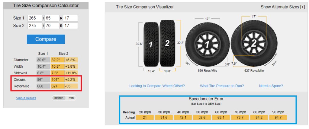

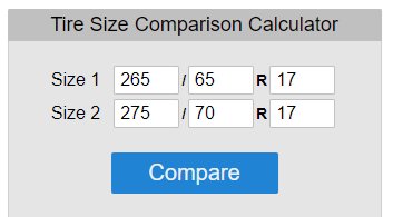

    Gist is this:
    Go to compare tire sizes, I like this site: Plugin your old size, and your new size, click Compare.
    The areas of interest in the output are the red and blue box here. Blue box is pretty straightforward, it's how much your speedo will be off, if that's all you care about.
    You can calculate your deviation in one of three ways, I believe. You could either (1) calculate % of deviation in speedo, then add that % back to the miles traveled, or from the red box (2) calculate the % of change in revolution and add that % back to the miles traveled, or (3) calculate tthe % of circumferential difference and add that % back in. What that would look like....
    1. Speed deviation in this example, taking the highest speed, 90 ÷ 94.7 = approx 0.95, so 95%, so we would be reporting 95% of actual miles traveled, and need to add 5% to the miles logged. 5% in fractional form is 0.05, so if we odometer miles times 1.05, we get our actual miles traveled.
    2. Revs/mile deviation in this example, divide our new revs of 627 by old revs 660, 627 ÷ 660 = 0.95, so 95% of actual miles traveled, thus need to add 5% to logged odometer miles. Repeat last half of #1 to calculate actual miles traveled (multiply odometer travel by 1.05)
    3. Circumferential difference in this example. They've done the math for us, 96 ÷ 101 = approx 5% (they say 5.2% but I came up w/4.96%). In this case, you'd essentially follow as above, multiply odometer miles times 1.05, or if we use their number, times 1.052
    Likewise, if you installed a yellowbox, you'd want to play with the numbers a bit, but telling Yellowbox to correct miles by 5% should put you close enough for government work.
    I may be wrong on any of the above, and if I am, I hope someone calls me out. There may be a better of the 3 to choose, mathematically. I know how to get to the numbers logically, I just don't know which method is best.
