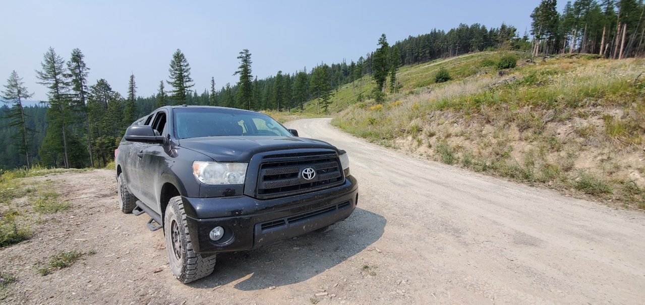

    I probably should have included photos. Here she is. Yes, she's dirty, because we're always driving down dirt roads! Soon I will have a yakima roof rack on the truck cap. I will also be installing a driver side 270 degree awning. Yeah I don't really love the idea of a light bar mounted up top due to wind resistance/noise. Maybe I will just upgrade the fog lights then. It appears upgrading the headlamps is very expensive! front of tundra.jpg 20210723_104058.jpg
