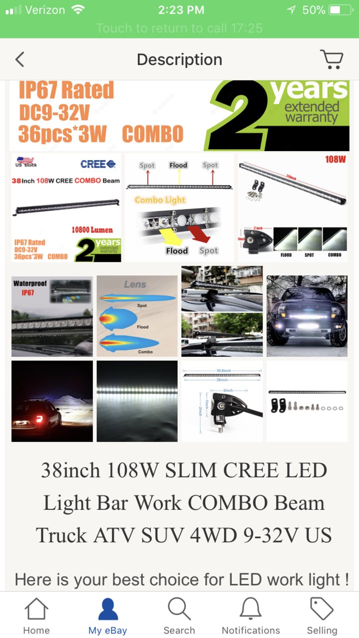

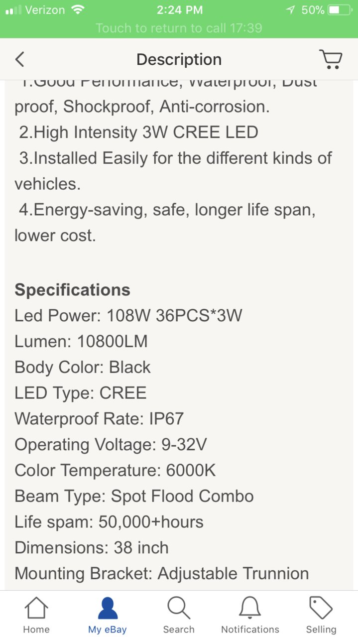

    @CJ21 What brand is that light and where did you order it from?

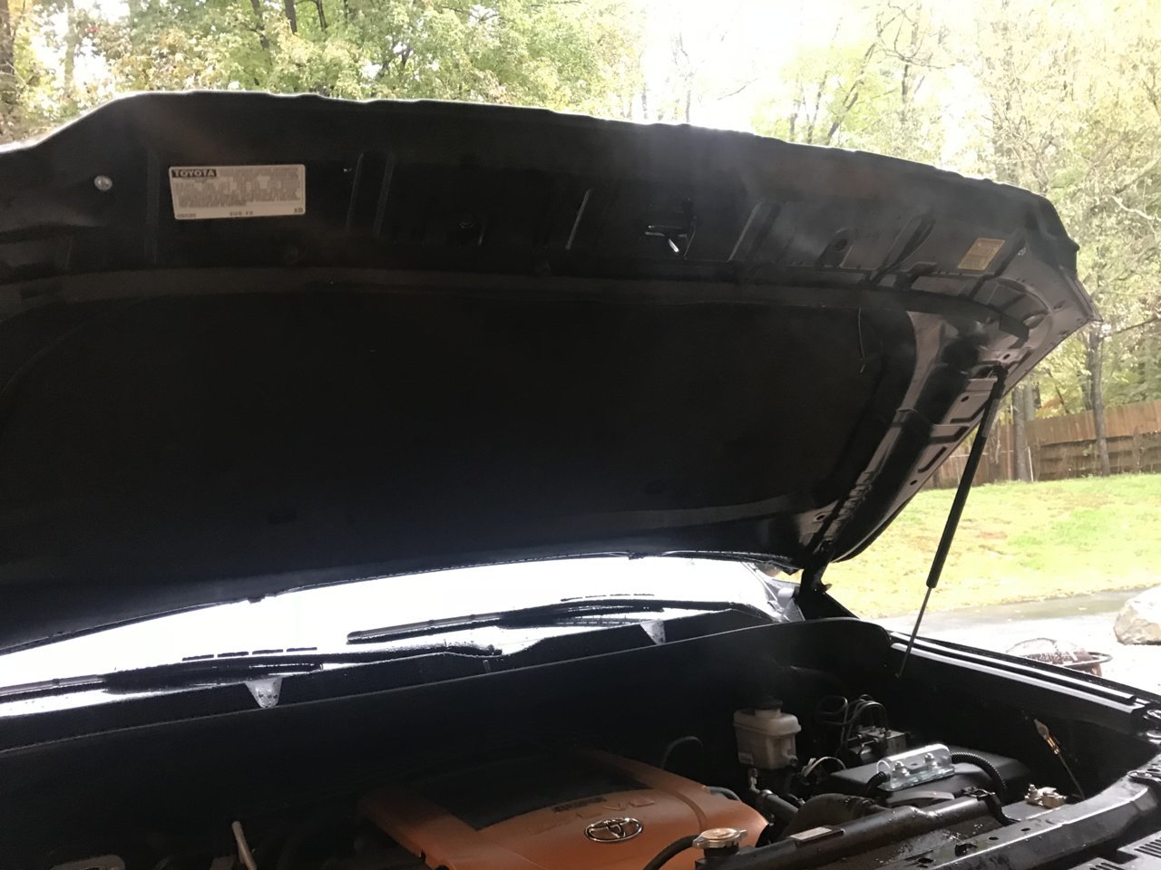

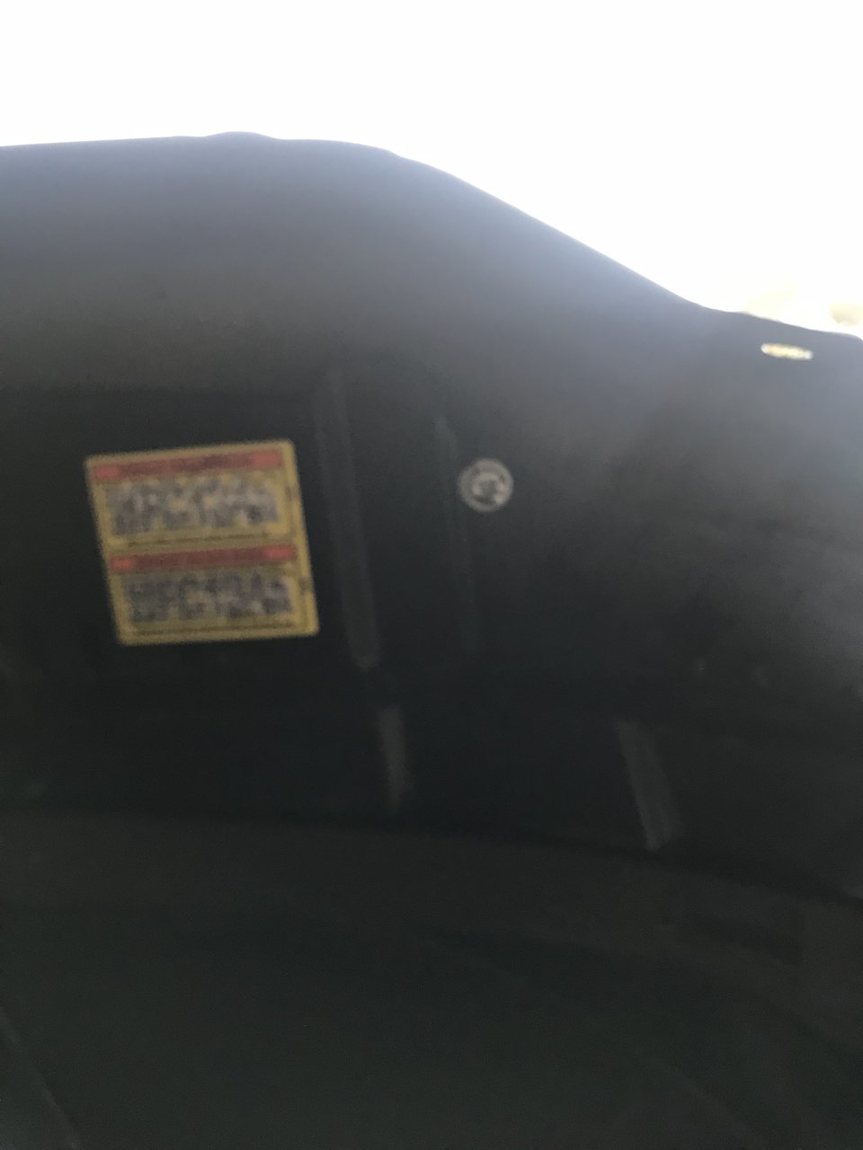

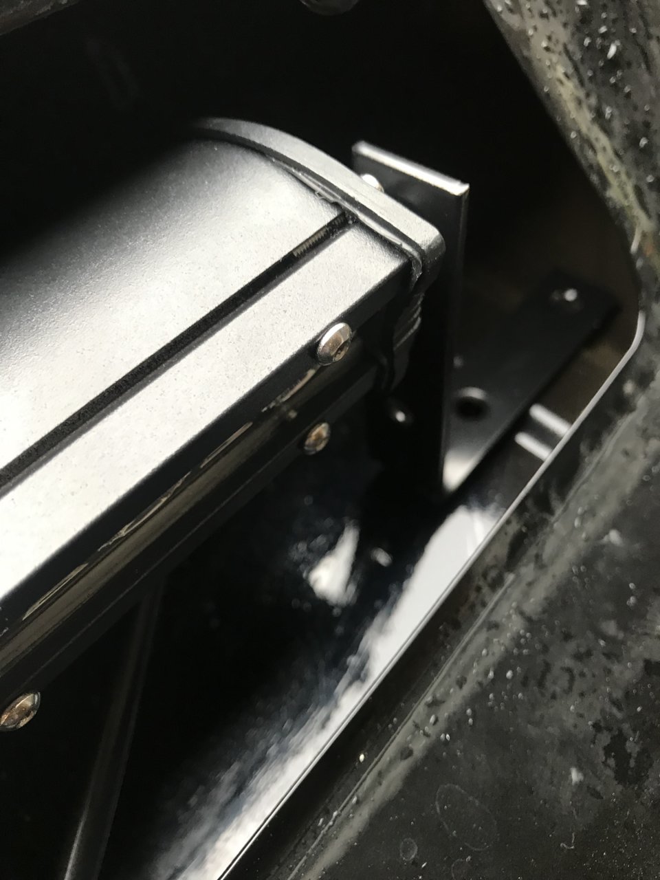

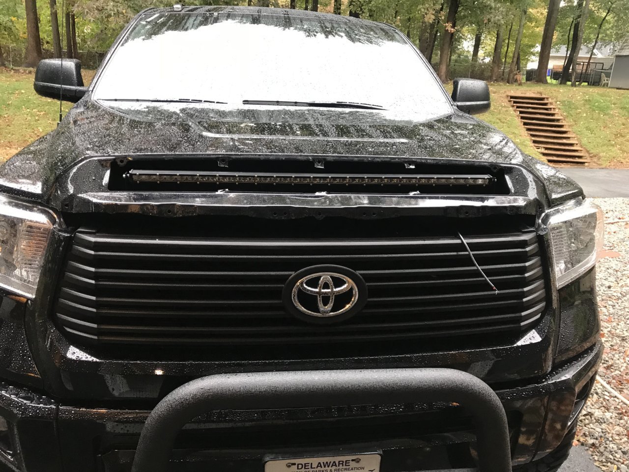

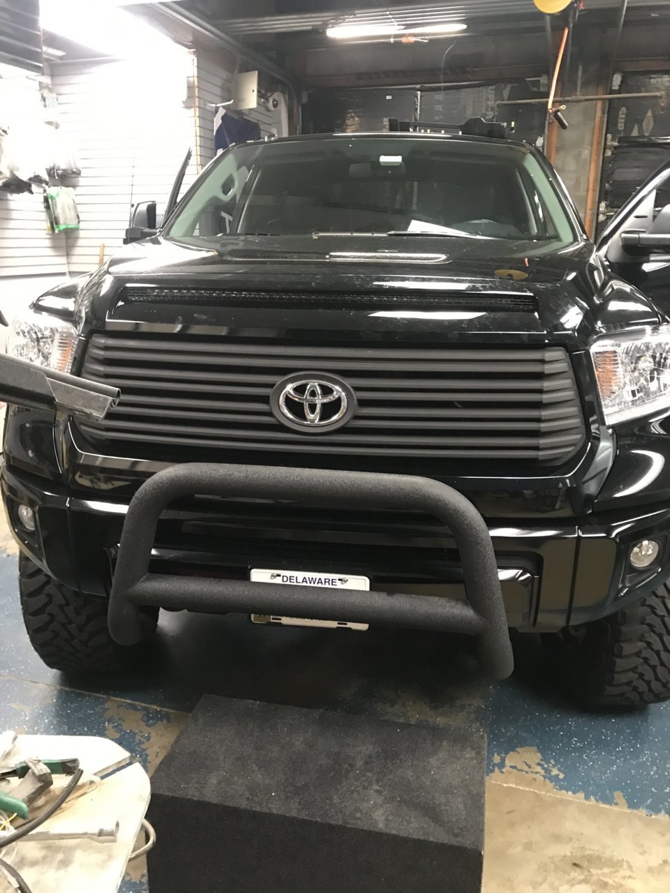

    There are holes that are already drilled in our trucks and I was able just to use them holes.. Did not have to make new ones!! So the Brackets lined up almost perfect..I went to Home Depot and bought 3 inch L brackets.

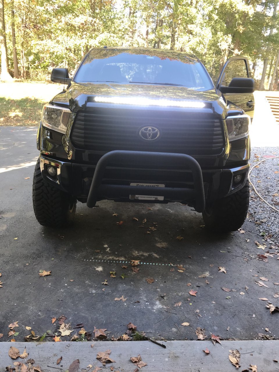

    Looks real good! I’m going to have to this. The price is right for me.

    Looks beautiful!!! Nicely done, great workmanship. Too bad you don’t live closer so you could do mine. I’m gonna have to search Ebay for this light. Does it come with wiring harness? I guess I can look it up and see.

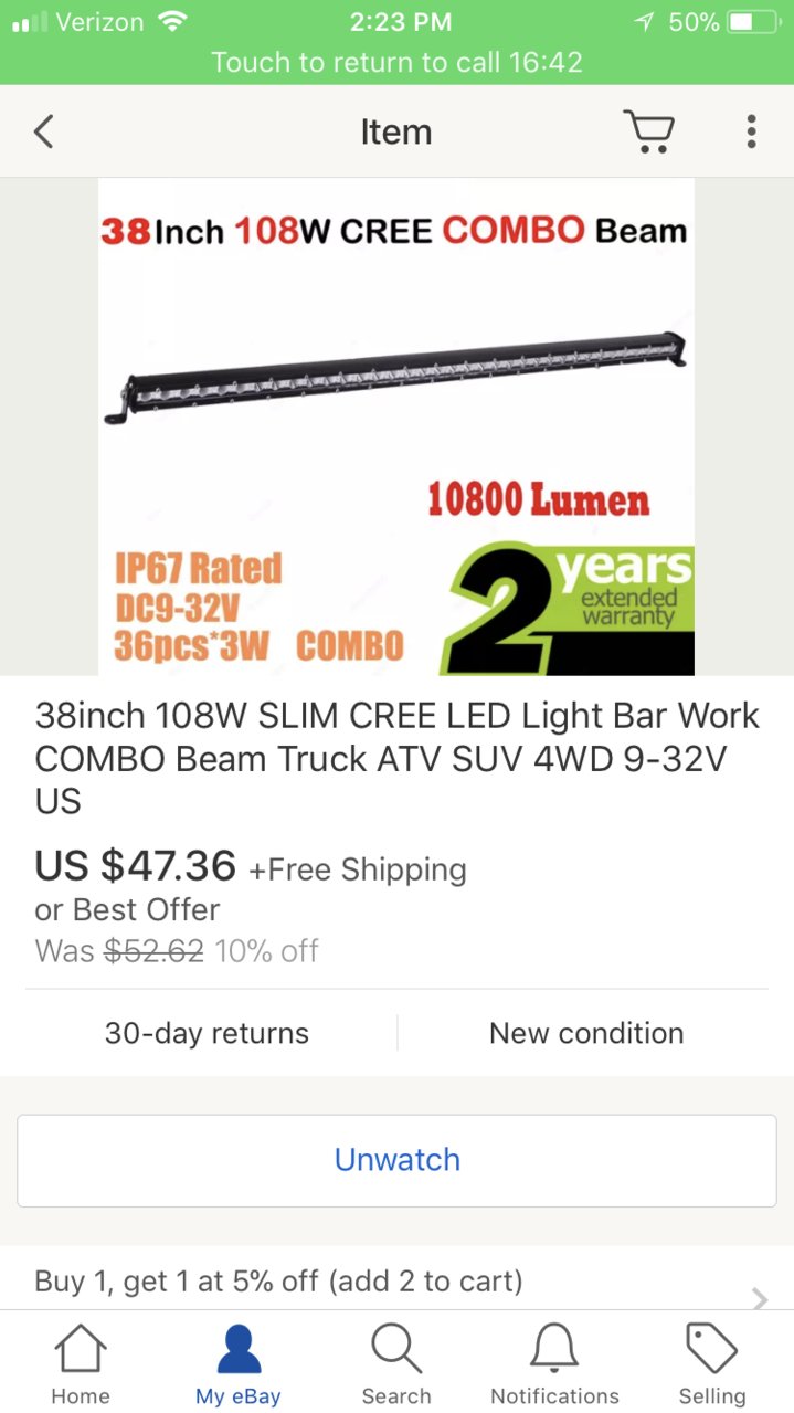

    I have one in grille and bumper. This makes me want to add a third. I have extra wire and relay but could probably just power off the one in bumper. It is 180 watts adding a 108 to that harness would put me at 288 or almost 25 amps. Relay is rated at 35 so no sweat.
