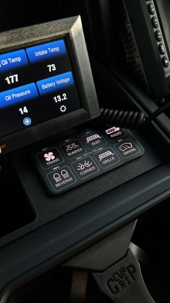

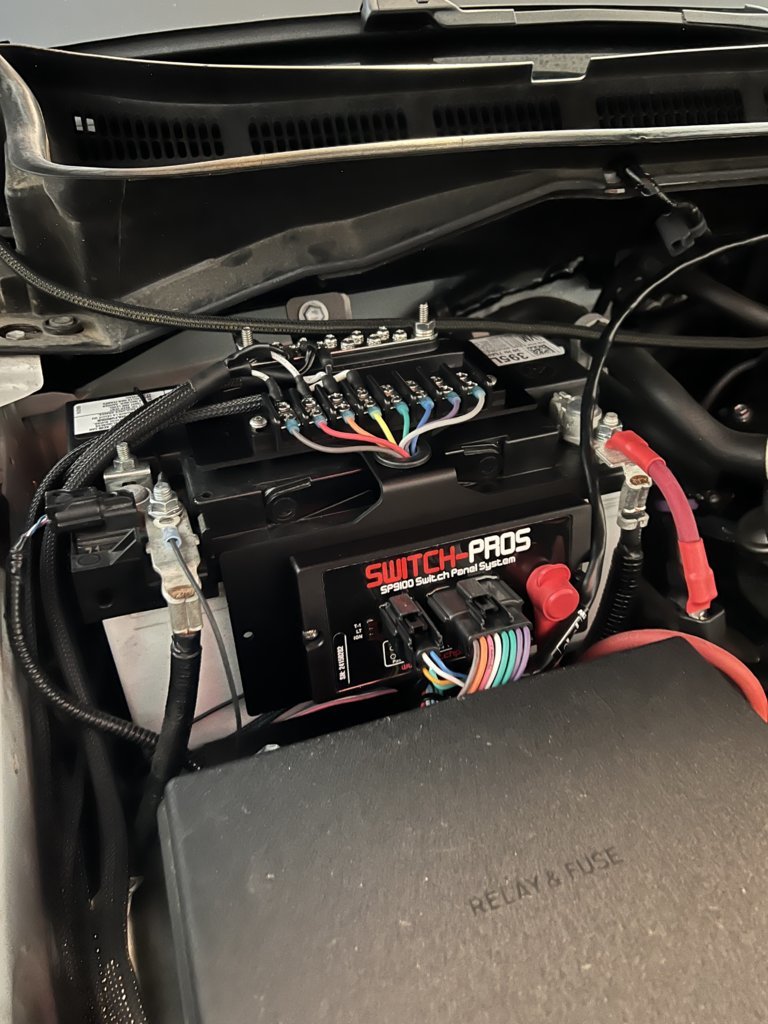

    I just swapped out my sPOD switch panel for a Switch Pros 9100. The sPOD is easier to install and wire up your lights since it already has a terminal block and negative bus built in. The Switch Pros will take more time to install and will require you to buy a terminal block and bus bar if you want to make the install cleaner and easier to remove/install accessories down the road. You'll also need to buy or come up with your own mounting solution. That being said, Switch Pros is more work but operates better in my short time with it vs the sPOD.
    Here's what I did the other day on my 24. Ignore the ground that isn't properly seated. This was taken before I finished the install. lol

    Do you have any blank spots on the panel left of the steering wheel? Air on Board switch in one of those holes?
