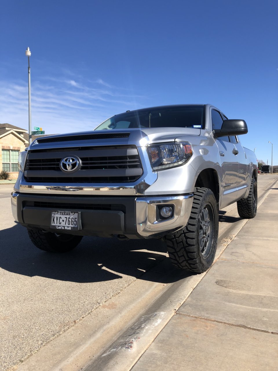

    1.8”-2” is as much as you can go without having to lift the rear. My 2014 Double Cab has a Bilstein 1.9” lift and is perfectly level and I have no issues with the stock UCA’s. My tires are 295/55r20 and I had to remove the small mud flaps

    If you go 2.5” in the front you will definitely be nose high. I’m at 1.9” and it’s perfectly level with a tape measure but at certain angles and if I add weight to the bed I become nose high.
    You will have no problem getting a proper alignment with the stock UCA at 2” but it can become an issue at 2.5” and beyond.
    Bilstein 6112 set to 1.9” stock rear

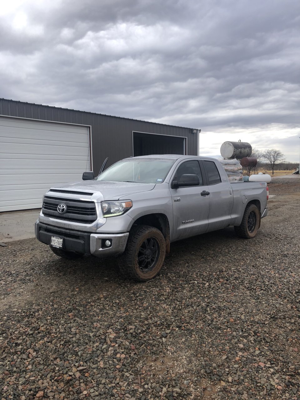

    200lbs in rear
    2,000lbs in the rear

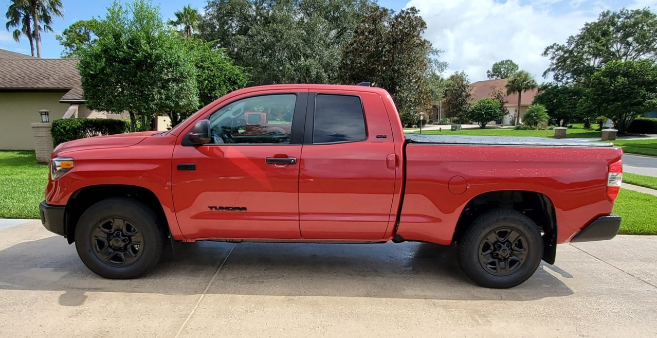

    Ok. That really helps. So I'll do the 2 inch up front. Do air bags in rear so when I put weight on it. This is how it sits now. Stock 18's. Getting 20 inch wheels for my tires soon. 20200824_161557.jpg
