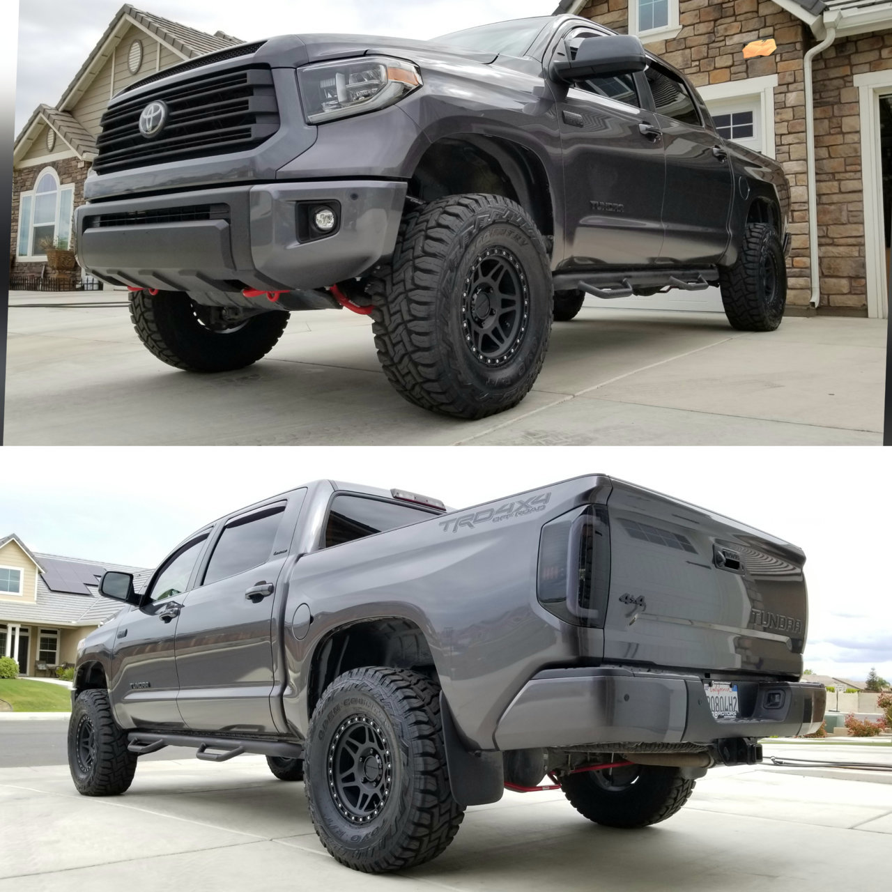

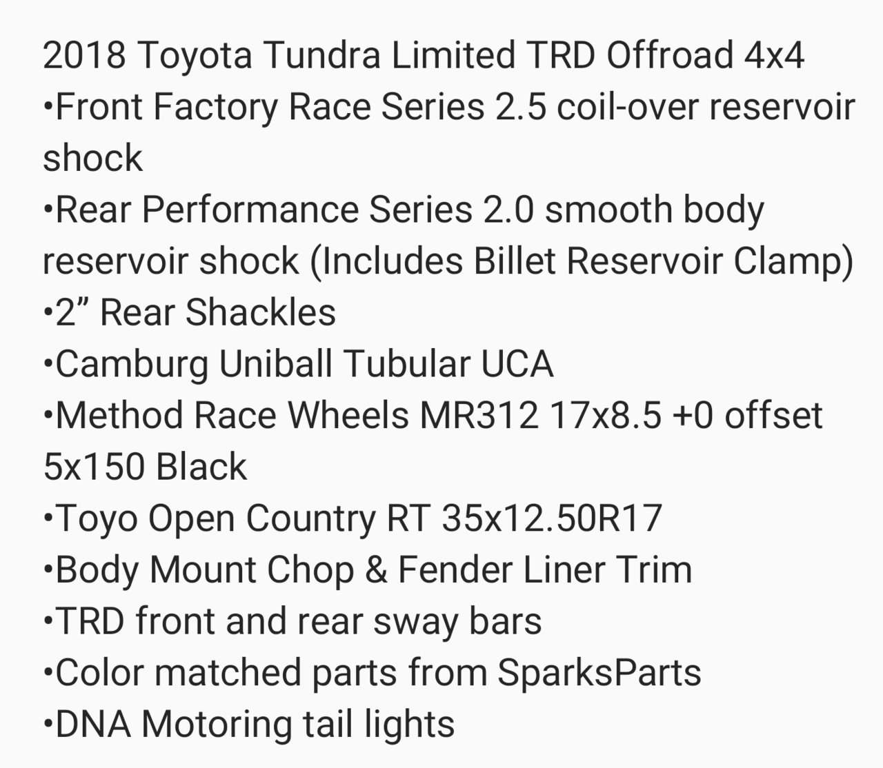

    Just had mine lifted with Fox COs front and Fox 2.0 rear w/2" shackle in rear. What I had installed is in the pics. No rubbing and rides great. Took a few tries and a call to Camburg before the alignment tech got it right without rubbing the body mount chop plate.
