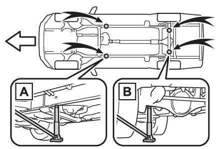

    OP, if you need to jack it up or support it, here’s a helpful pic:

    Thanks but the front jack point is kind useless since I have the front skid plate.

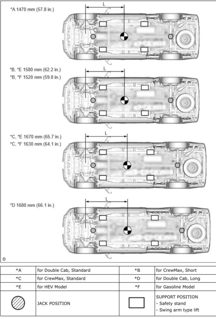

    These are the factory recommended jack/stand locations for the Gen 3 Tundras.

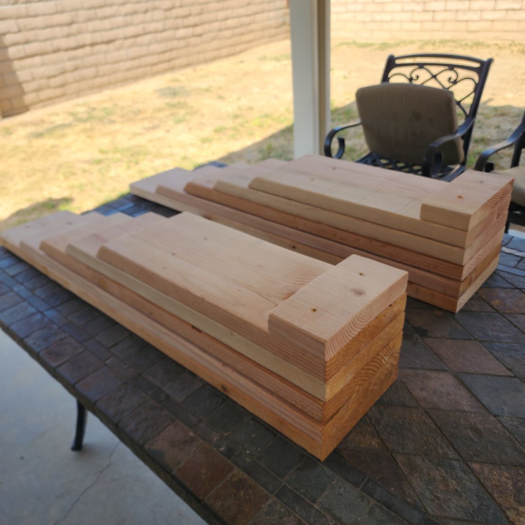

    Build my own ramps from 2x10s and use the floor jack to slide out/in the TRD skid plate. (4Low rolls right up there) Super easy and fast.

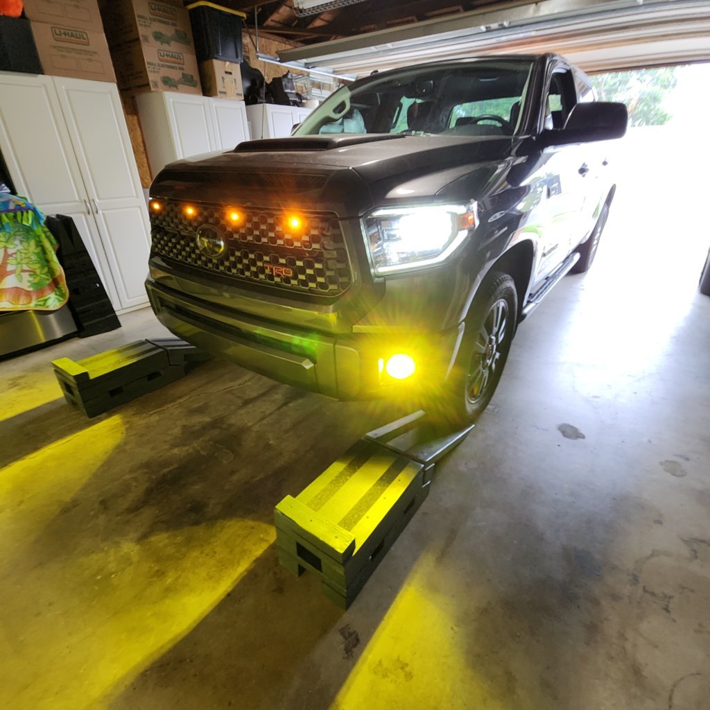

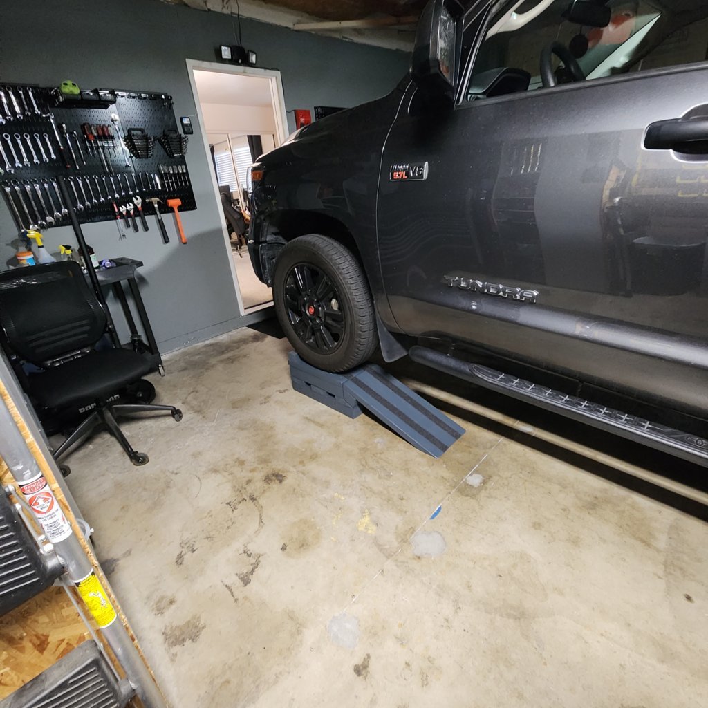

    I know you said you don't wanna spend money on ramps but that's gonna be the best and easiest method for quick and easy oil changes going forward. As previous members said, DIY some ramps as they are a great investment. One DIY oil change alone will pay for itself. I've made several and even sold a few. Super simple design..
    But you can get fancy like my brother did for ones he built me and build them with removable ramps..
