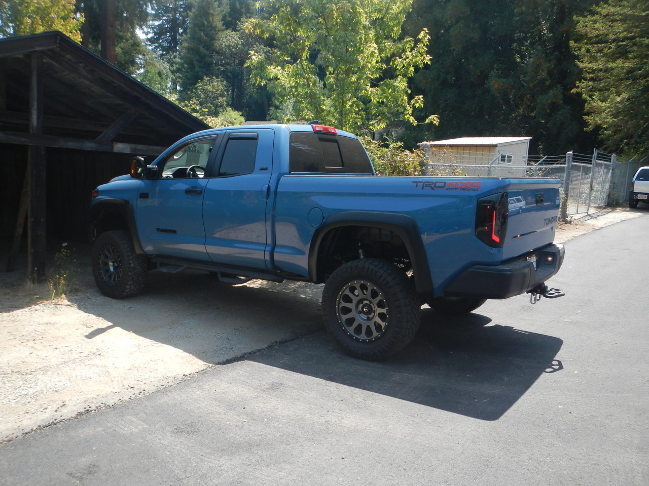

    Hello tundra owners. I’m looking for photos or recommendations on lifts for my recently ordered 2021 tundra crew max 4x4. I’m looking to run a 295/70-18 tire, basically a 34x11.50 and 18x 9 wheel. Any photos or recommendations would be appreciated.

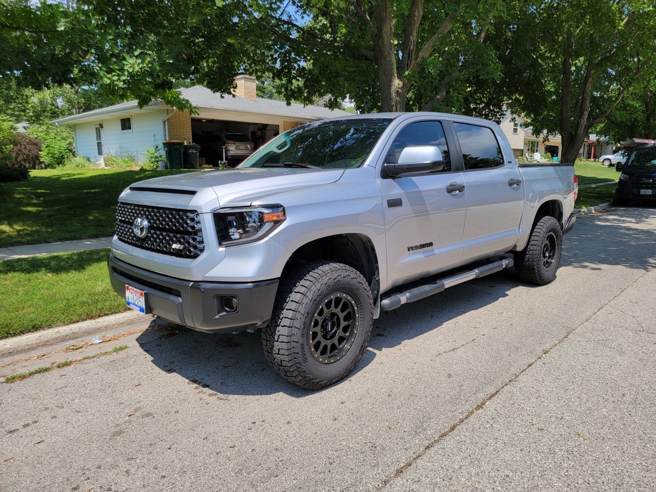

  6. Aug 14, 2021 at 5:14 PM
    infidel
    infidel New Member
    May 31, 2021
    #63737
    192
    Jesse
    SE Wisconsin
    2016 Silver SR5 Crewmax
    Procomp 3/1 Method 307 18x9 +25 Falken Wildpeak AT3W 295/70r18
    Procomp 3/2 level
    Method 18x9 + 25 offset
    Falken wildpeak AT3W 295/75r18
    weldit[OP] likes this.

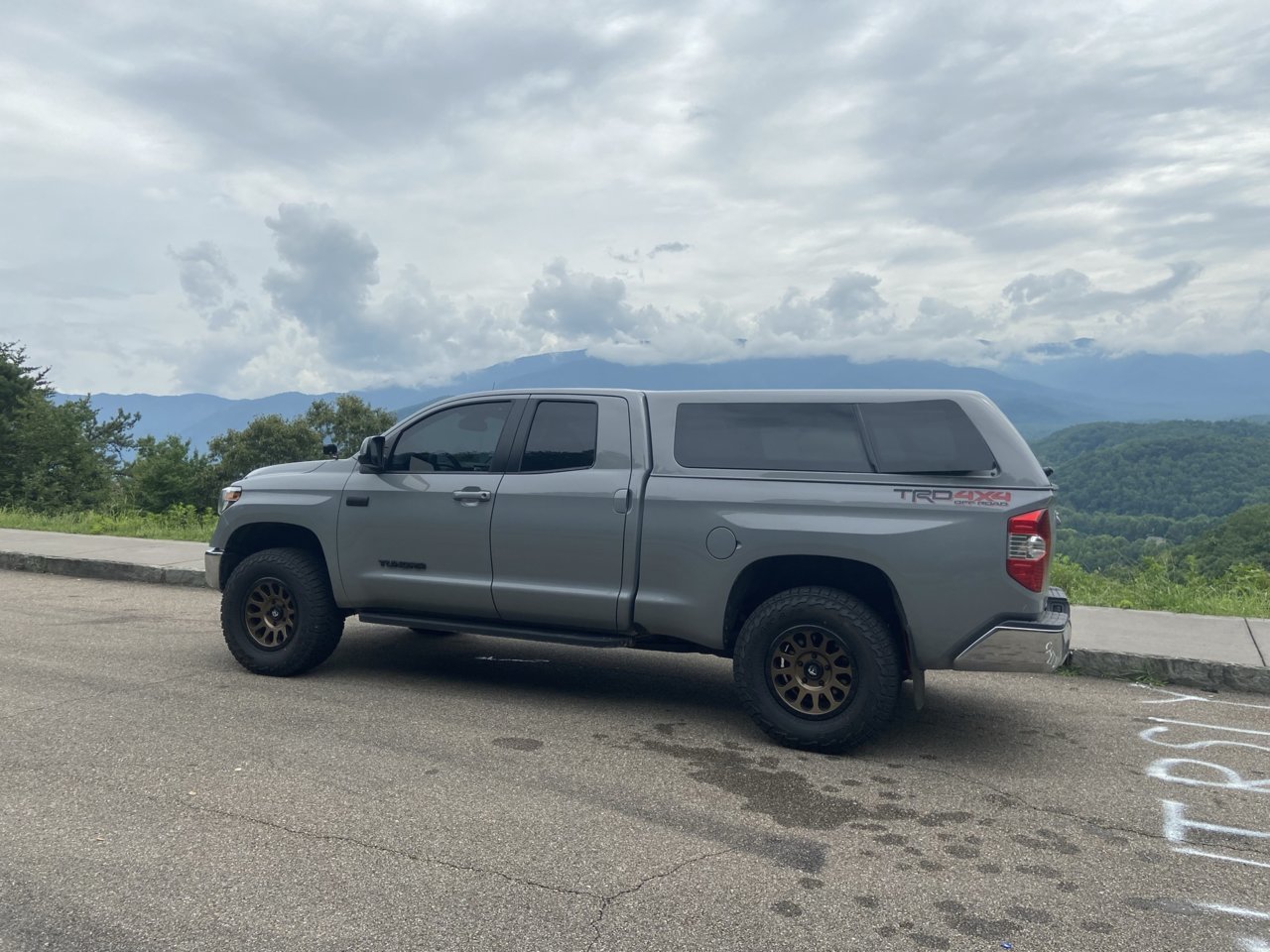

    2018 TRD double cab
    Eibach 2.0 full kit. Spc uca’s. 1cb shim passenger, E1095BAE-FED9-41AB-8F8D-183280952DBA.jpg 2 cb shim driver. 3 inch coachbuilder shackle. 295/70 18 +20 offset

    2021 Tundra Crew Max Trd Off Road
    What wheels and offset are these ? Are they relatively flush to the fenders ?

    Method wheels with a + 18 offset. They stick out a bit but not much at all. I was worried about water flinging up in the PNW but it is not much of an issue. The greater consensus is that +25 is the best offset for a 3/1 kit.

    I also have the Method +18s and I'm looking for something with more positive offset. With the Wildpeaks it picks up and throws the limestones all up my rockers and it started to piss me off with a bunch of chips on a truck with 6k on it. Conflicted on where I wanna go from here so I'm looking around.

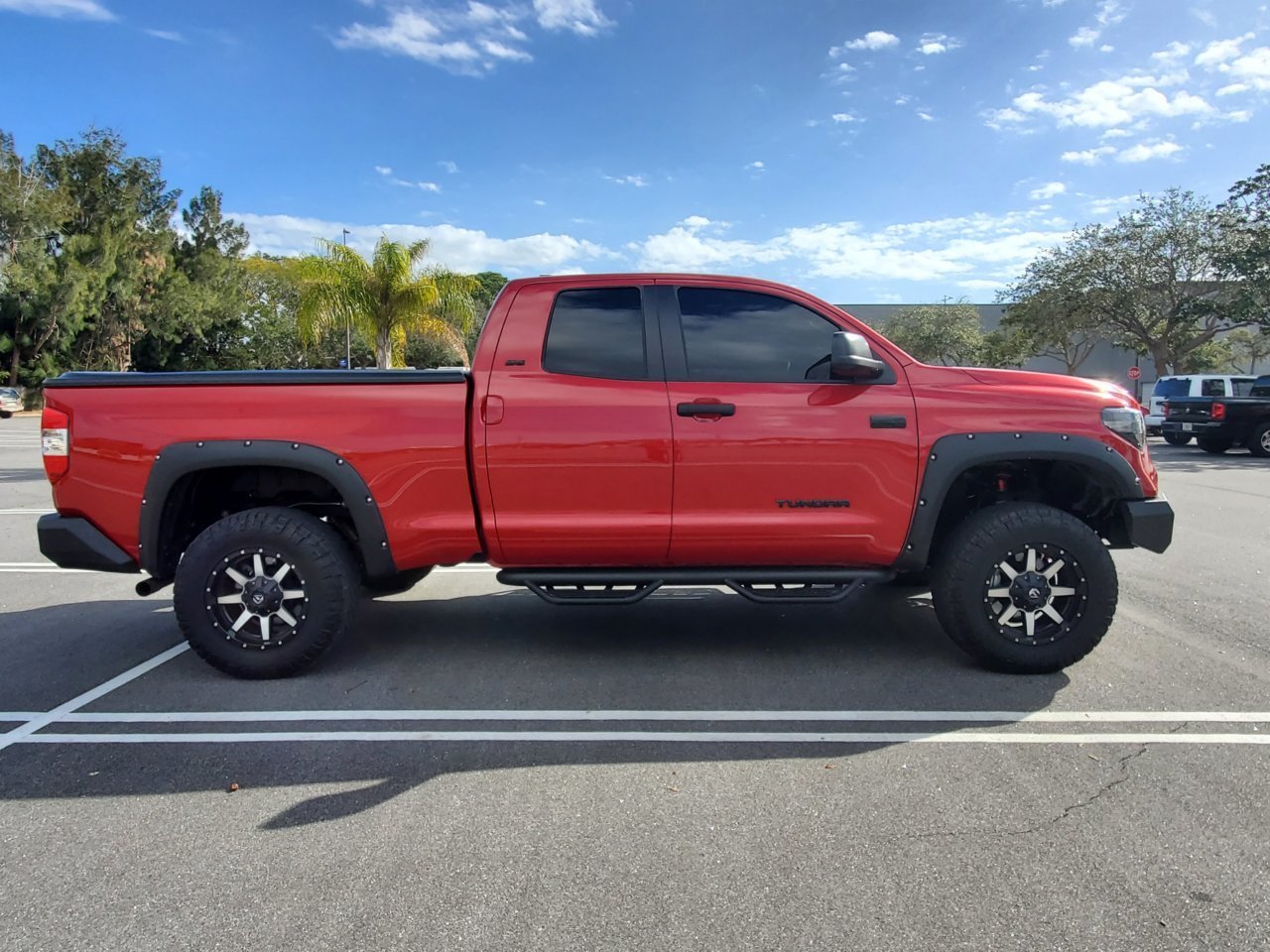

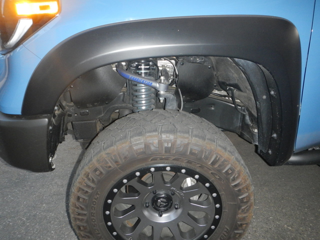

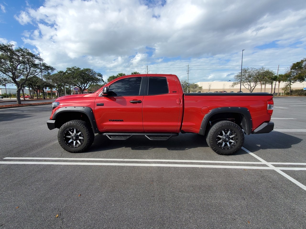

  12. Aug 14, 2021 at 8:01 PM
    Blue By U
    Blue By U New Member
    Aug 11, 2021
    #66647
    576
    6" Pro Comp lift 20 x 10 Fuel Vectors 35 x 12.50 ridge Grapplers. Sorry I don't know the offset. I have no wheel rub and no body mount mods. I did have to use the Bushwacker flairs To stop the rock dings.

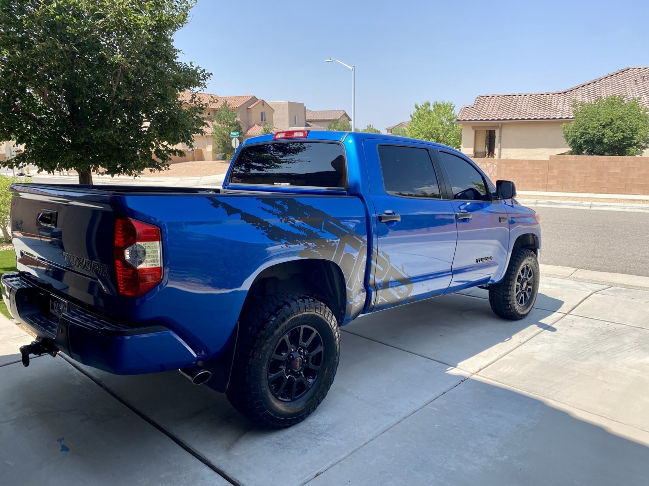

  13. Aug 14, 2021 at 8:29 PM
    BlueJay
    BlueJay New Member
    Oct 1, 2017
    #10017
    12
    Justin
    ABQ NM
    2016 Blue Tundra CrewMax
    3/1 Rough Country lift
    295/70/18 Dick Cepek tires

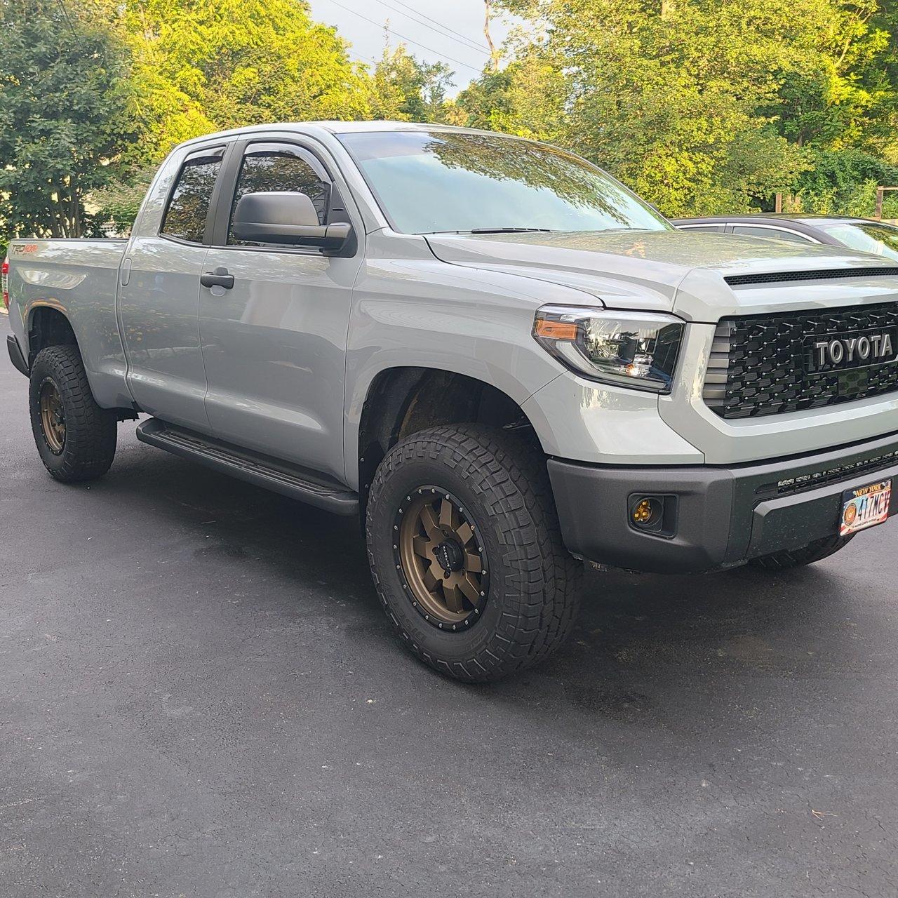

  18. Aug 16, 2021 at 3:07 PM
    ctkny
    ctkny New Member
    Jun 16, 2021
    #64373
    29
    NEW YORK
    21 Cement Tundra SR5 TRD
    little higher then normal and a little black paint
    Boss 4x4 3/1.5 bilsteins 6112/5160, 2/1 shims, icon leaf pack, cooper 295/70/18 raceline +18
