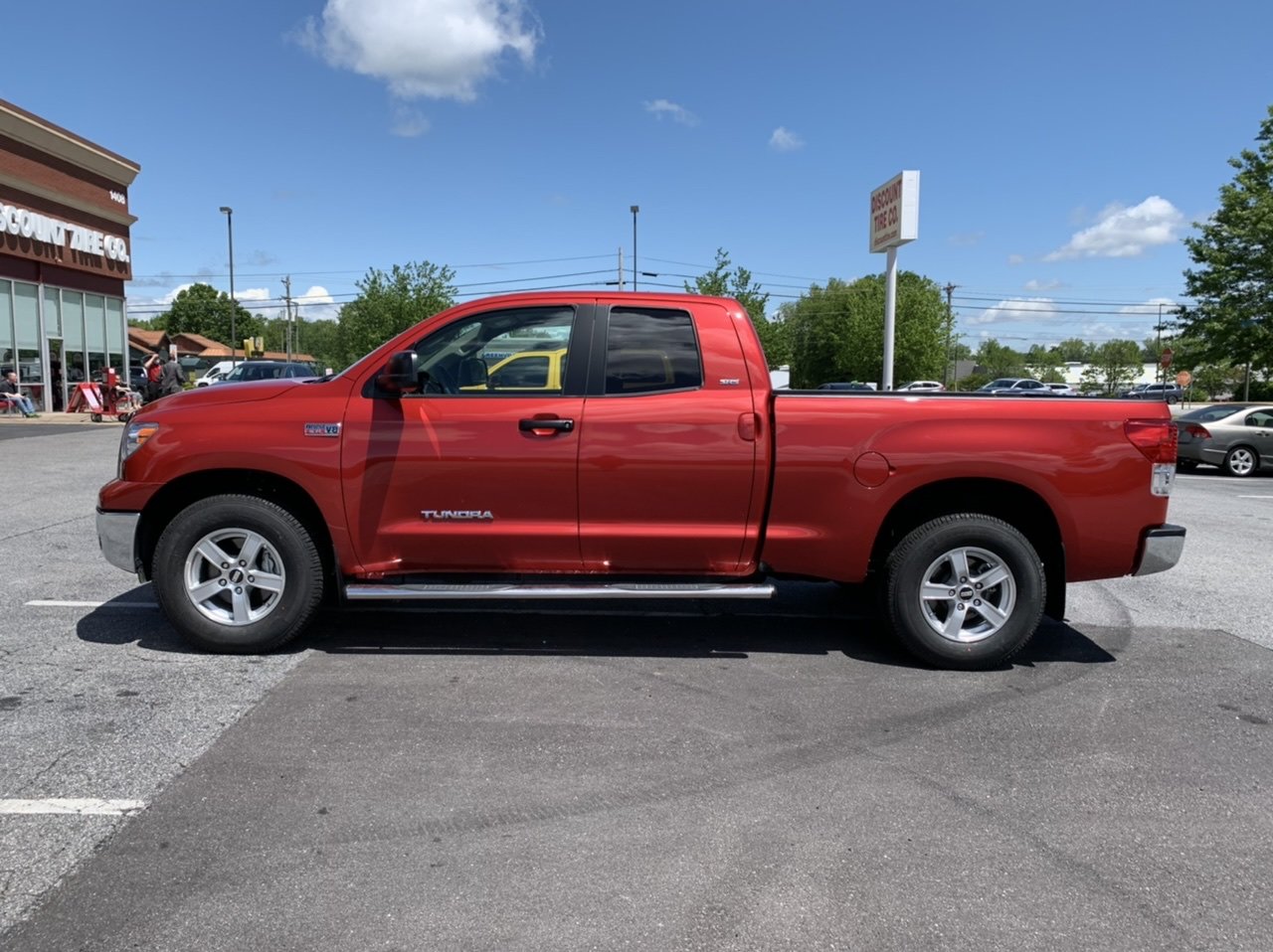

    I just installed Michelin 275/70R18’s and they fit well. The overall diameter is 33.2”. Considering leveling just for looks. 82735372-F4FA-4394-8B86-C35A4AA72DD6.jpg

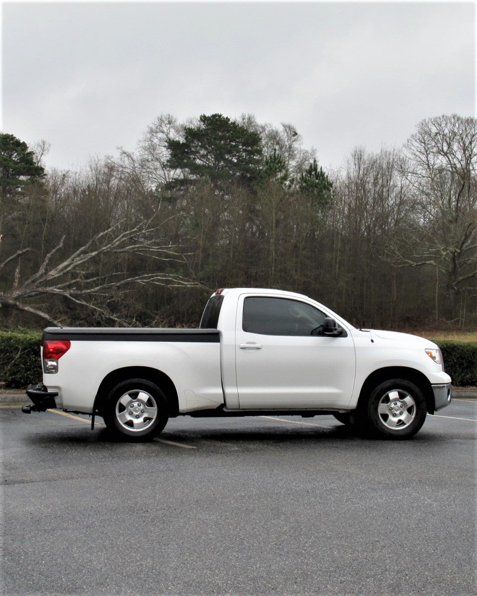

    I leveled by lowering the bed 3.25", it looks great on stock 18" tires.

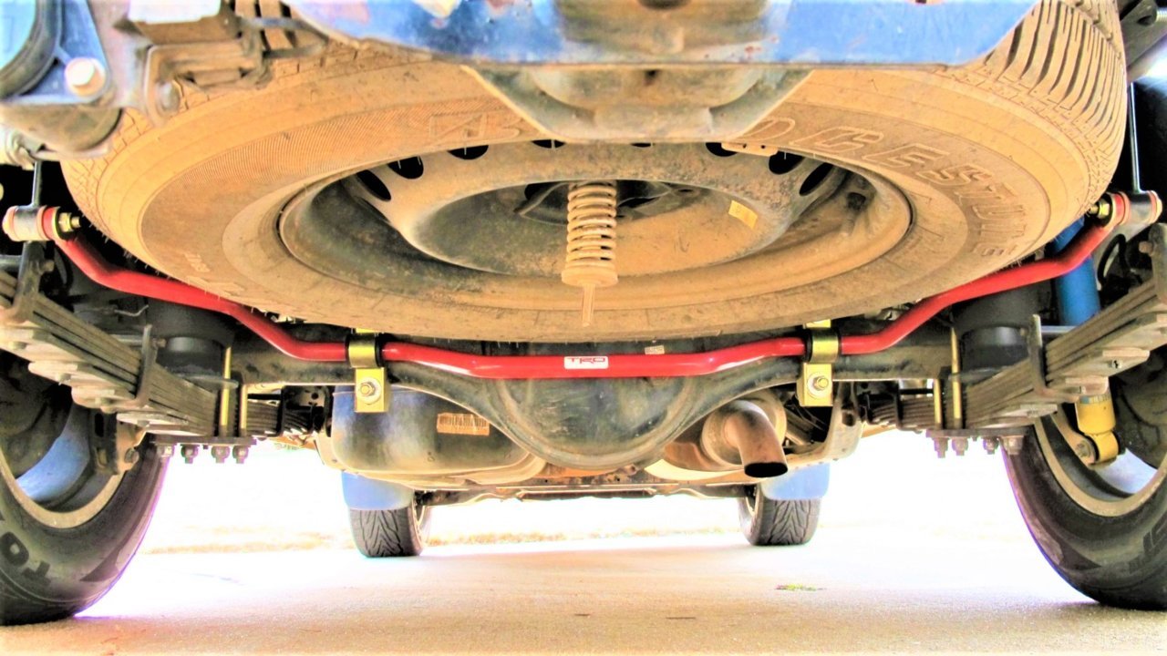

    SOS 3.25" rear only, plus air bags, anti roll bar with installation kit and short shocks.
    The leaf packs are from Alcan. The front suspension is stock... ground clearance didn't change.
    In this picture there's a few hundred pounds of weight in the bed, so the bags are aired up a little bit.
