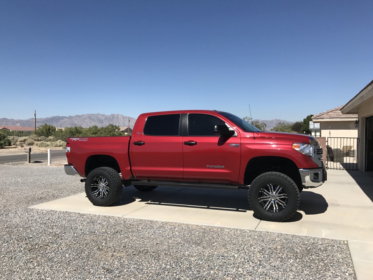

    ProComp 7" 35/12.50/18 -11
    That's gonna be a tough one partner, This forum consist of everything from 75 dollar spacer lifts up to 12 inch bullet proof suspensions..
    I'll make it easy and give you a starting point, A 6 inch lift with 35 inch tires and new wheels fully installed will run approx 5K.. You can go up or down from there..Good luck with whatever you choose, I'm sure it will turn out good.
