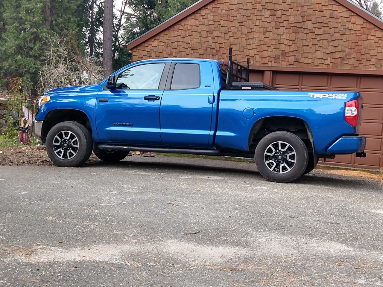

    I just did the 6112s up front on 2.5" and the 5100's on the back with the regular 1" block and I love it. Did BFG KO2s at 305/65r18 (33.6), and Fuel 18s at +1 offset and 5" backspacing. I think it's perfect for my truck and looks very balanced. Sure I could have gone bigger, but I love the way it sits now.

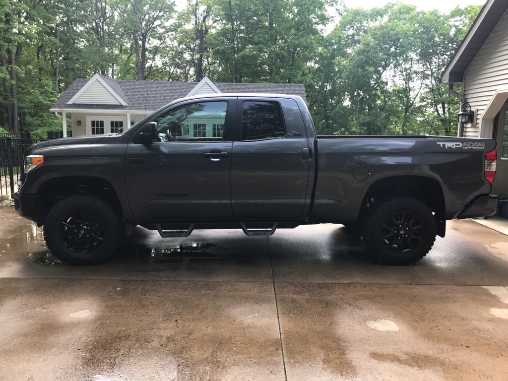

    These aren’t the best pics but hope it helps...

    Thanks. Looks good. I've got flares too. Running 1.25" spacers now. I want to get rid of the spacers. Gotta figure out what offset I'm gonna need too. Lol. Heads gonna explode.

    Well I think what I got, fit it perfect and lined up really great with the flares. Like I said, it’s the +1, and has a 5” backspace. So it basically makes it stick out 1” more than stock. Then on 18s, the tires fill in nicely.

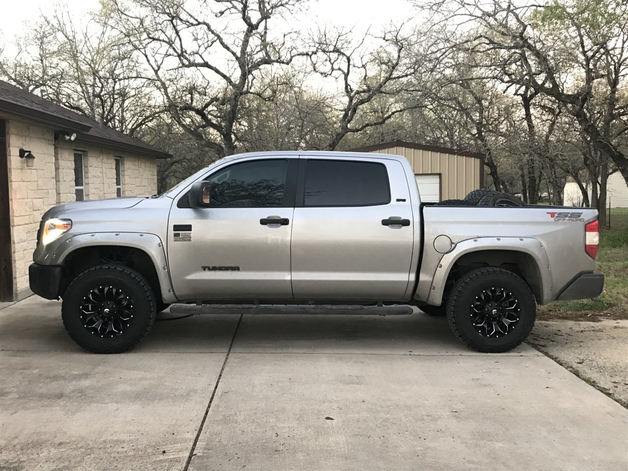

    I went with Procomp 4" so that I could still fit in the garage, I tow often enough, and no crossmember cut. I love it! I think its the perfect height, and to me 22's with 35's with a 4" lift gives the appearance of the perfect amount of wheel/tire to wheel well look ratio IMO. Had I got a 6" I would have went with 37's to keep that wheel well ratio looking good. An actual lift is expensive so I had to save for it, but theres no way I was lifting my truck without a diff drop because on my last Tundra I started having rack and pinion problems that normally don't happen as soon as they did from what I'm told. Had it replaced and 10k miles later or so I felt the same thing about to happen so I traded the truck in haha. Bottomline, don't rule out a lift I think its well worth it.

    What flares are you running?

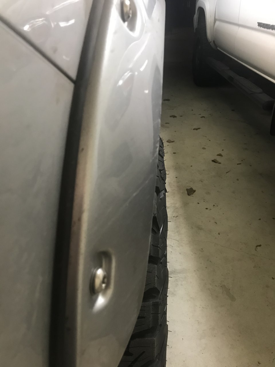

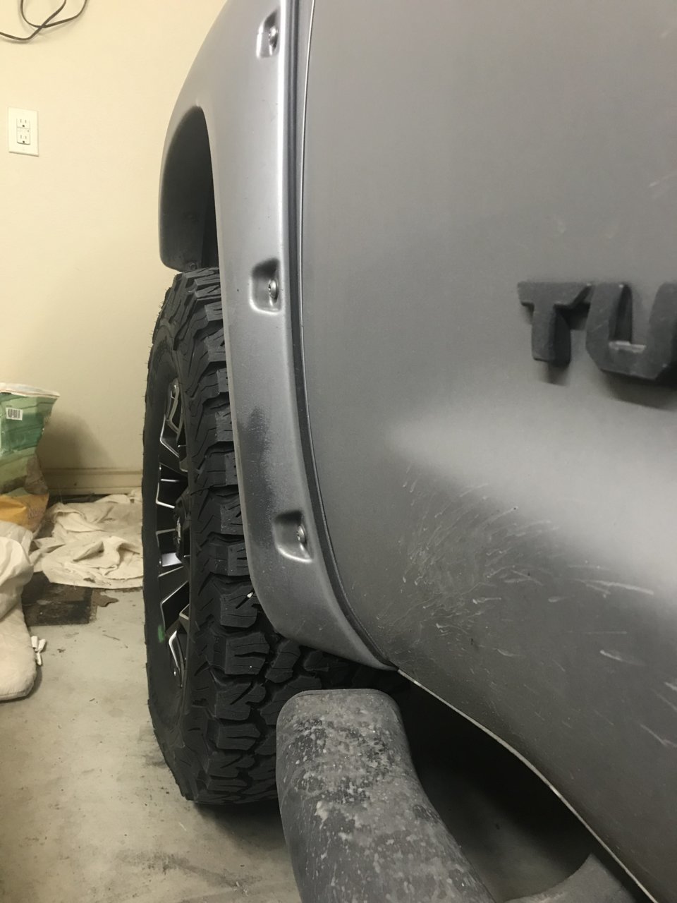

    D3Tundra, that's a good look. I went on procomps website and it doesn't even pull up Toyota when I search for my truck. Lol

    Stock haha. Eventually I'm going to get the AirDesigns flares, just have to find a painter that can paint match them first.
