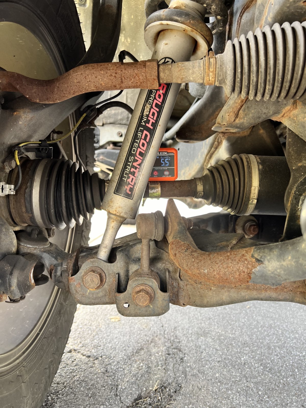

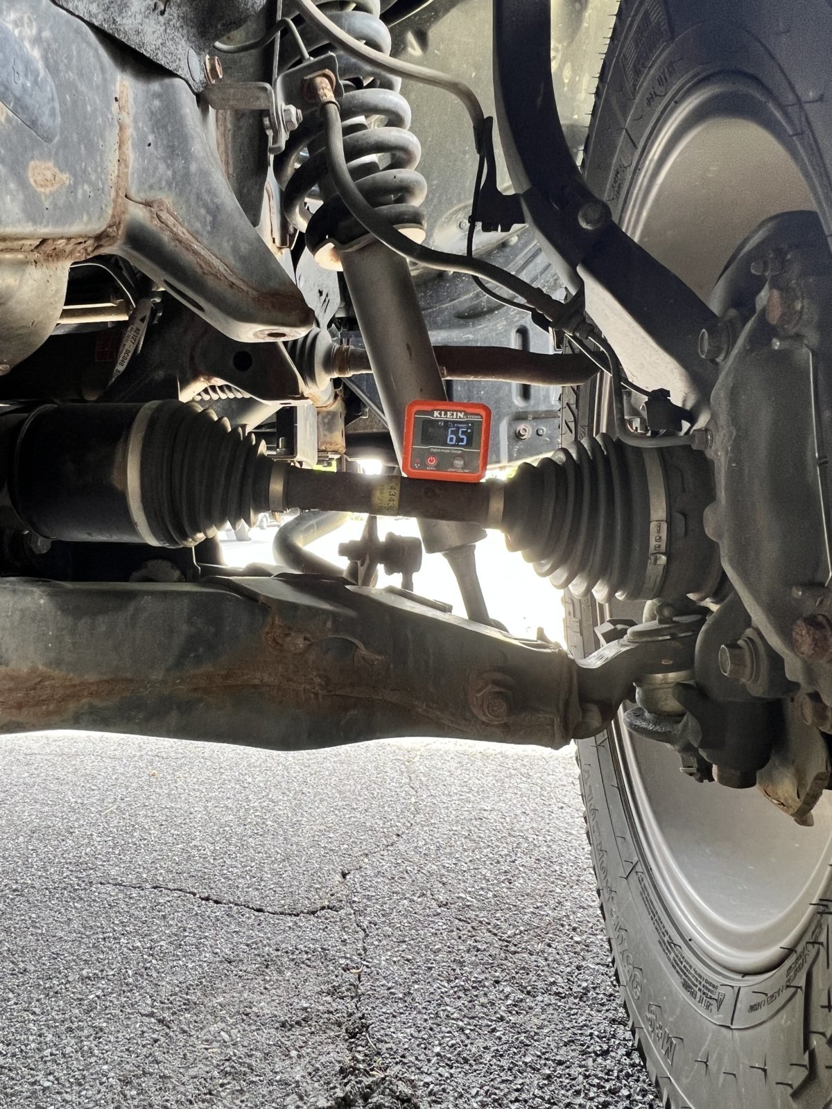

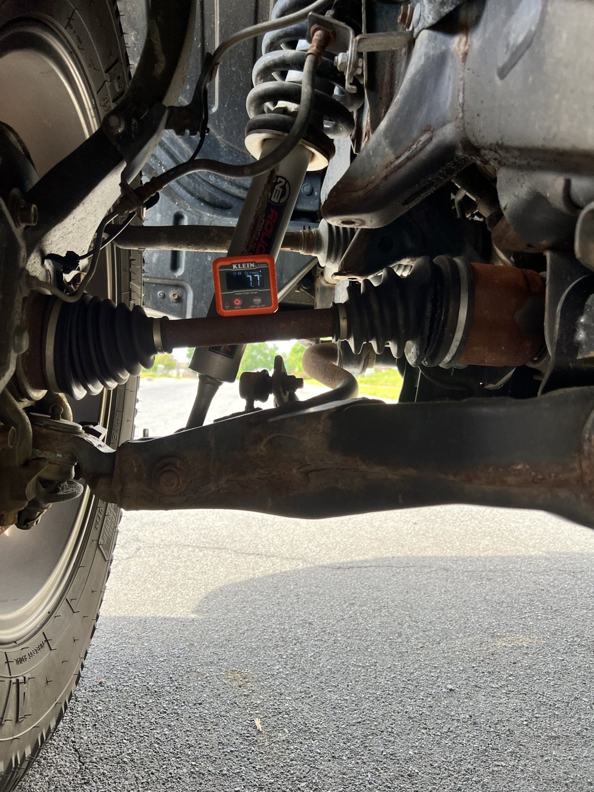

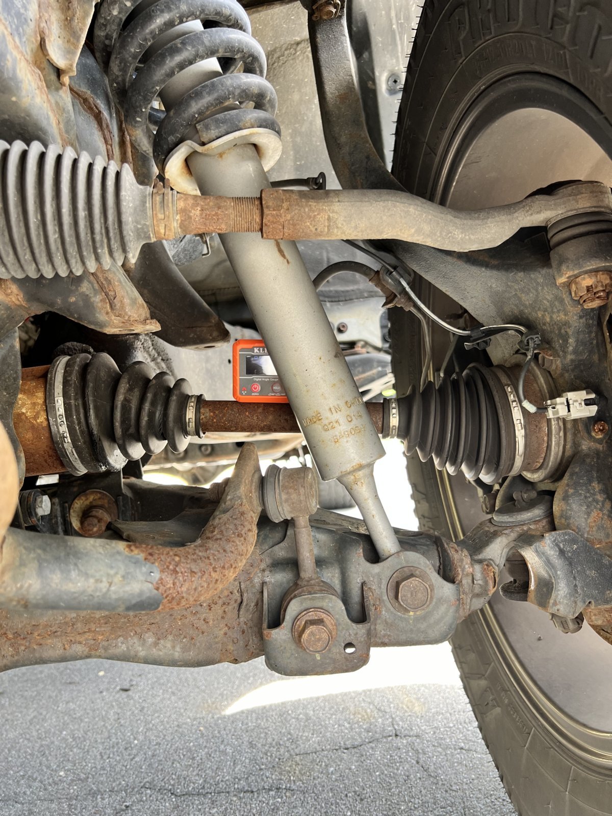

    So here are some pictures of my CVs. I threw a Kline angle finder on them to see what they are at. The first one from the front of the passenger side is off as it’s sitting on the metal band that you can see in the picture. So passenger side is
    6.5 and the driver is 7.7. Thoughts?

    It looks like you’re running an aftermarket axle shaft for the driver’s side, which is likely why you’re having problems. OE is expensive but are known to last.
    I’ve had a 6” RC lift for the 5 past years / 100K miles. Our lifts are almost identical other than one being taller (same control arm brackets, hardware, and knuckles). I accidentally damaged an OE axle shaft while changing a hub. My biggest mistake was using aftermarket to replace it, as it didn’t take long to fall apart. Then when I re-geared for 37s, the shop threw in a new “HD” shaft from Napa, to replace the first aftermarket shaft. It didn’t last much longer.
    After the “Heavy Duty” shaft went south, I replaced it with a new OEM shaft. I haven’t had any problems since. And FWIW, the other axle shaft is the original that came with the truck.

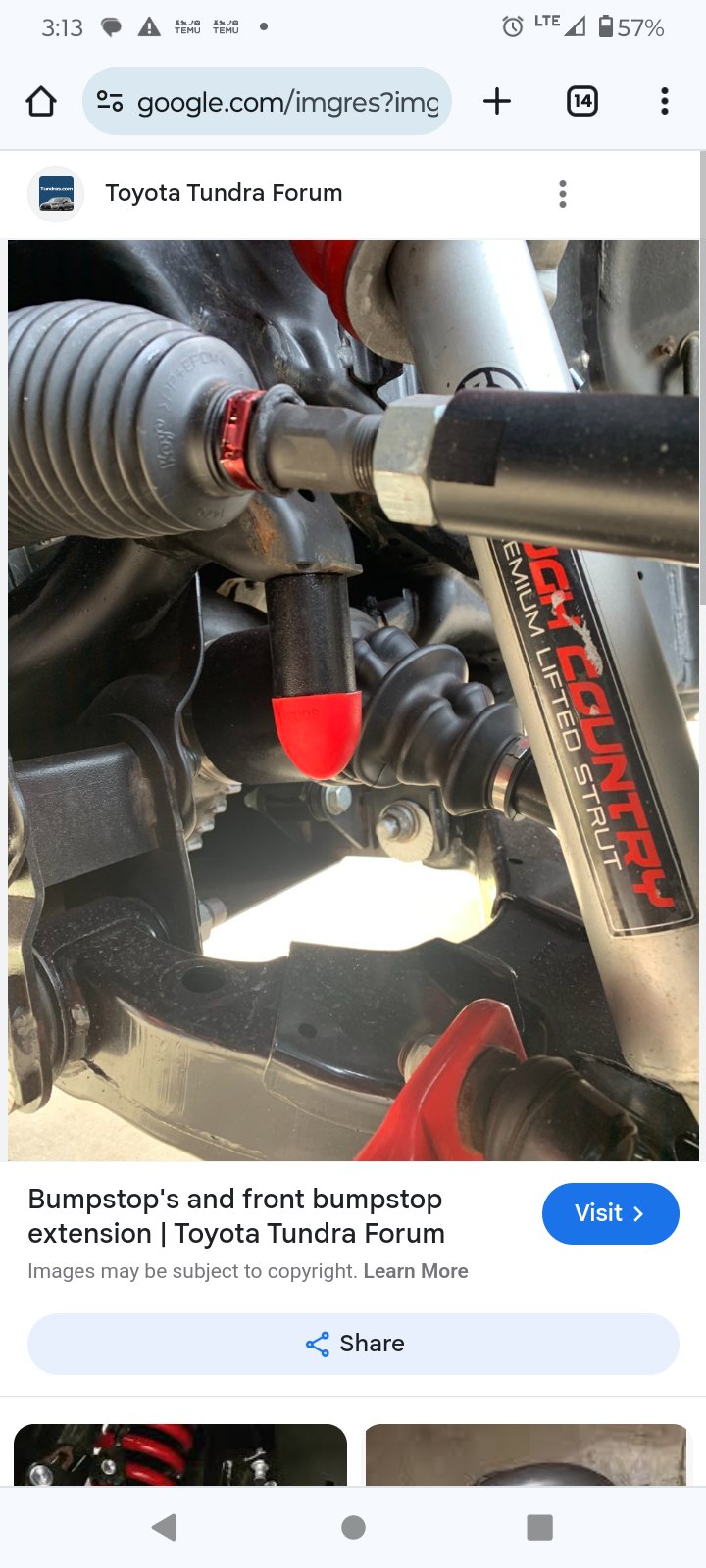

    What limits the up travel and prevents bottoming the shocks? Seems like you're missing the bump stops

    I am missing bump stops as the OEM ones sheared off when I attempted to remove them. I have the ones from RC but never took the time to drill and tap them. The most articulation I see is coming off the curb at the end of my driveway. The truck is primarily used for towing and in the winter when it snows.

    That unlimited up travel really needs to be properly restricted and that is why RC provided you with the extension spacers. If they weren't needed, they wouldn't be in the kit.

    I totally get that. I just didn’t put much time aside to resolve the issue. I will be sure to take care of that when I install the new axle.
