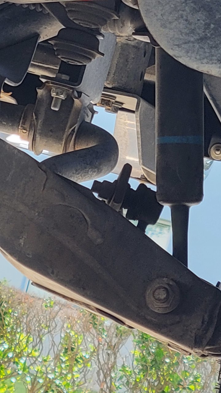

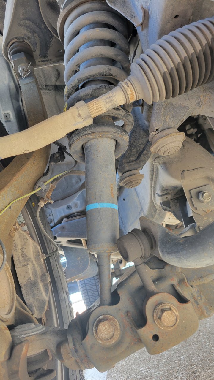

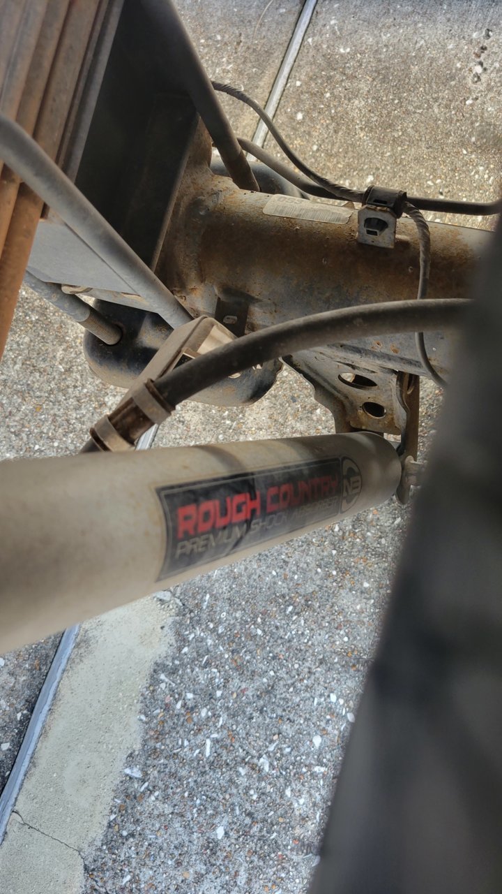

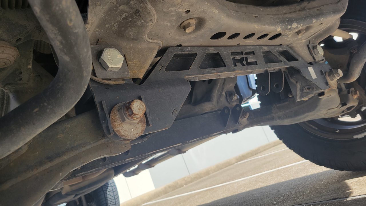

    Was trying to see if anyone can identify the lift kit installed on my 08 tundra which I purchased lifted. I see rough country markings in the rear shocks and front crossmember if I'm id'ing the part correctly. The front coilovers Im not sure what it is since didn't see anything but a blue line. Tia.

    Looks like a full Rough Country lift that uses extensions (spacer blocks on top) with the stock struts and coils up front, then new rear shocks

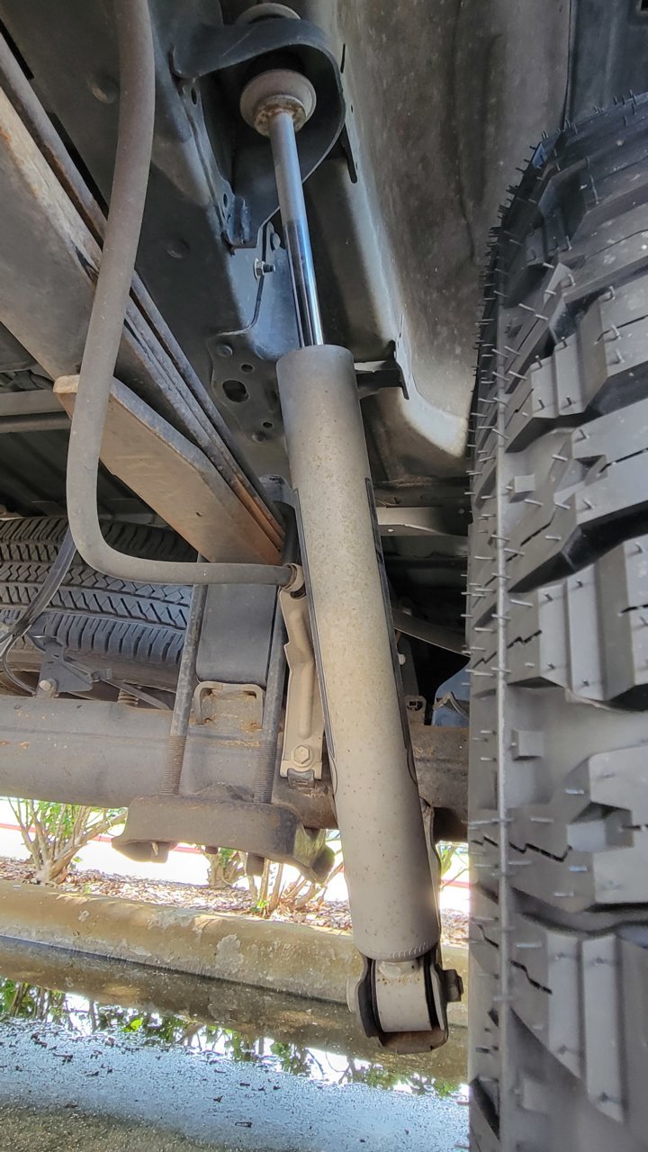

    So what you have is a Rough Country bracket lift. There is most likely a large spacer above the front coilovers. How thick is the block on the rear axle? It is looking like either a 4 inch or 6 inch.

    One hell of a block on the rear too.

    Thanks. So for them to lift the front its with spacers? Also, can this be convert back to factory suspension and height? Any idea of a model # for the rough country lift?

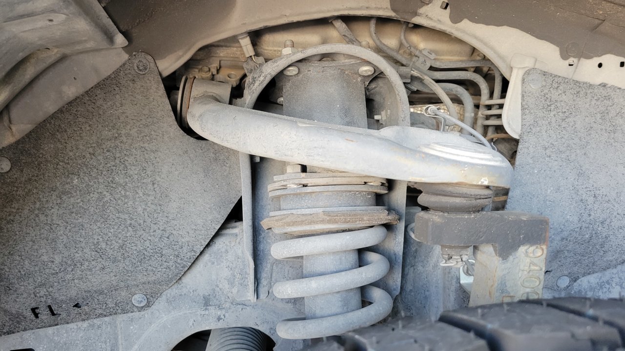

    Post a pic of the front at the top of the coilovers. It will have a spacer on it. The problem with the bracket lift is that the crossmember is cut out. It would have to be replaced.

    Here you, took a full shot of the rear shock as well.

    Yep...that a big spacer sitting on top of the coilovers.

    You'll need to call Rough Country and see if it's reversible. Some of their IFS kits require cutting out the OEM front cross member and to bolt in a new one (those are not reversible).
    Your photo looks like it's bolted on, but they would tell you. Go to their website and look at the same kit, and the instructions for how it's installed. That will tell you too

    Its definitely Their 6inch basic lift. 4 inch rear block and six inch spacer and diff bracket up front.
    https://www.roughcountry.com/toyota-suspension-lift-kit-775c.html
