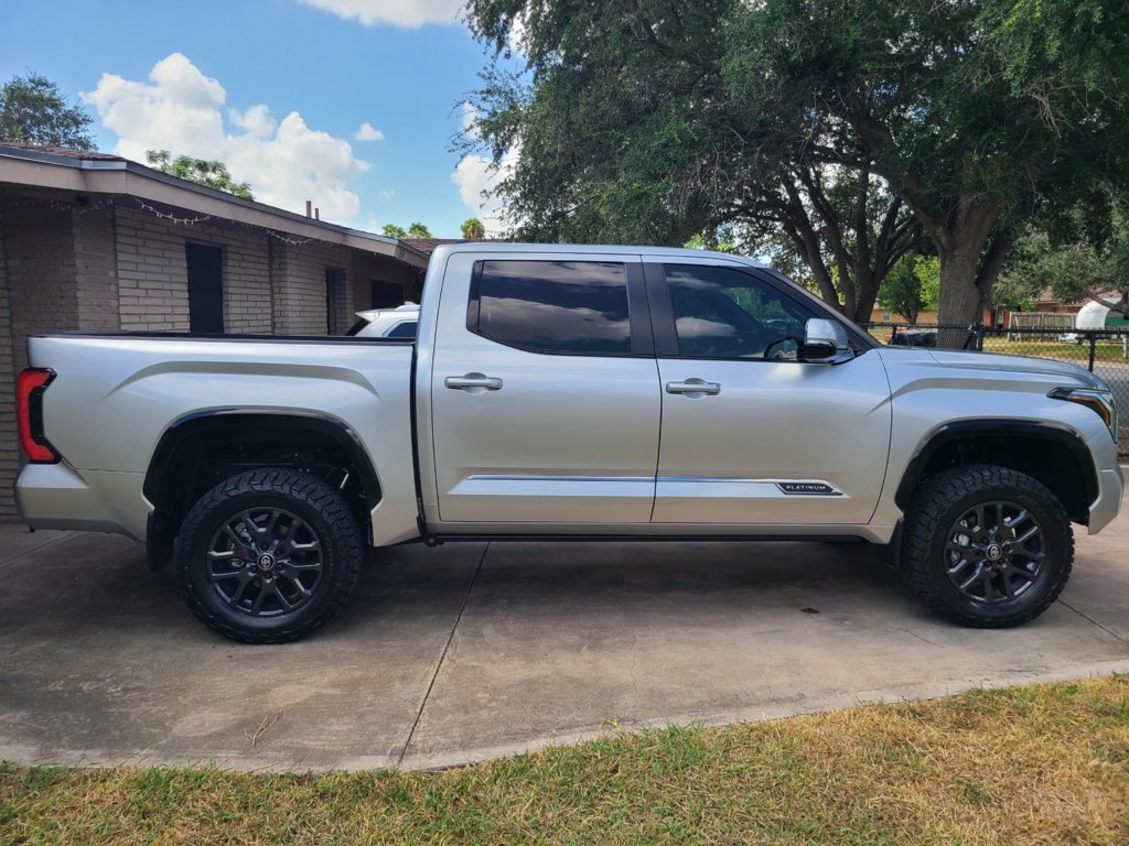

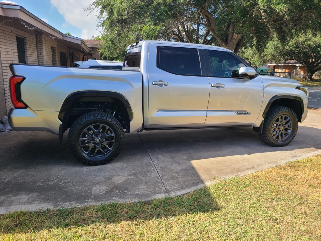

    Hello everyone.
    Looking for some comments or feedback from the experts here. Just picked up 2025 Platinum with AVS about 2 weeks ago. I wasn't looking for AVS but got such a good deal on this one, I couldn't pass it up. Just had a Readylift 3" SST Lift Kit With CV Axle - 2022-2025 Toyota Tundra Rear Air 4WD installed along with 295/60/20 KO3s at a local 4x4 shop.
    As I was detailing yesterday, I noticed a small rake. The height in front is 41 1/8 and the rear is 41 7/8, while it's not less than and inch, to me is seems pretty noticeable. The details on the Readylift say "...for a nearly level stance with a 3” front lift and 1.25” rear lift." From ready the owners manual, the AVS should remain in auto, so most of the time it will be set to Normal. If I do move it to Low the back goes down as it should and is on 2/8 difference. However it doesn't stay in the Low setting because that's not how the AVS works. Before I call Readylift or go back to local shop, I want to hear from you all, is the difference ok. Thanks for you feedback.

    Yes, you all are correct, I was referring the auto suspension (AVS). I was asking if there should be a height difference in back 41 7/8 vs front 41 1/8 after installing the lift. I called Ready Lift and they did confirm that the difference should be there. Thanks for responding.
