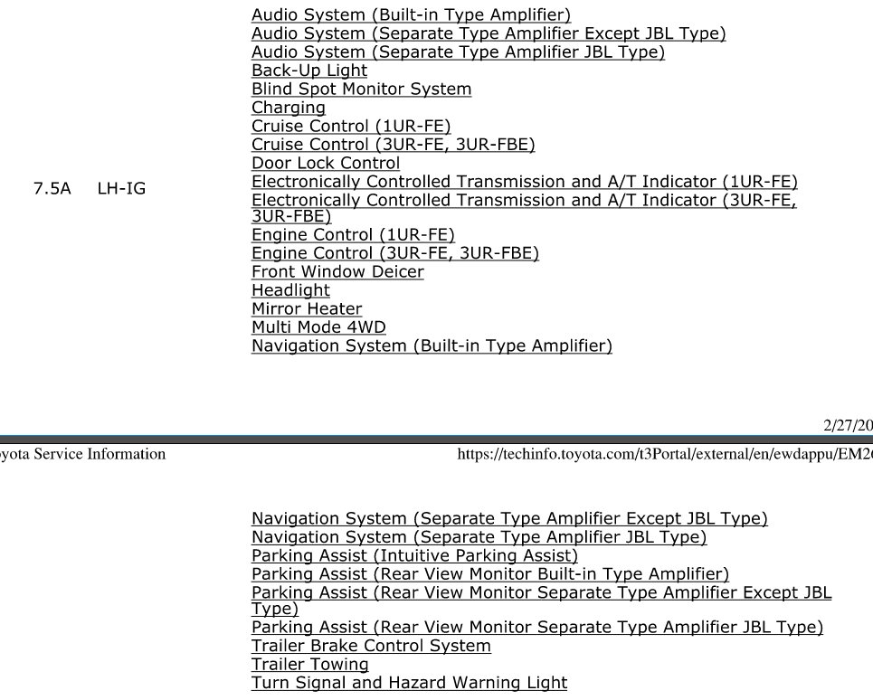

    Hazards and Turn Signals are all the same relay on the 2015 (PDF attached of the wiring diagram).
    LH-IG is used in a LOT of circuits (depending on what your truck is equipped with). It is the "trigger" circuit for ignition on a bunch of different relays and components. With that fuse tripped, I would expect your radio to not work, your charging circuit to not work, and if you've got a column shifter - reverse lights, 4WD, cruise control, backup camera, BSM, parking sonar, Door Locks, and who knows what else.

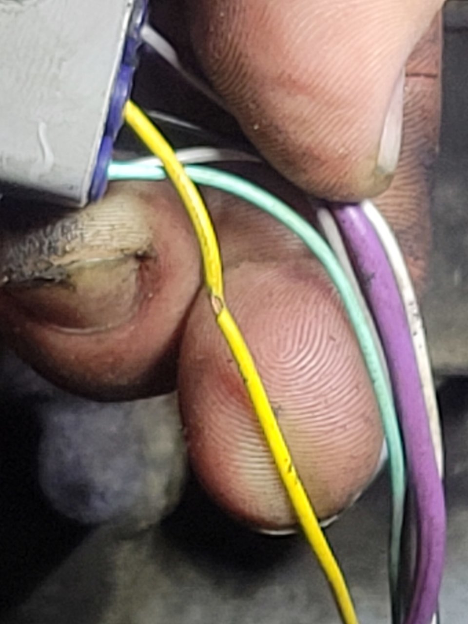

    Look what we found! Rubbing with a wire coming off of the brake fluid sensor. That was bare too.

    that's the cause???

    Yes. The yellow wire goes to the fuse and also goes to the alternator. It was next to the wire coming off of the break fluid sensor. Must have vibrated and rubbed with each other causing the casing to wear off and short with each other. Taped up and have not blown a fuse yet. Fingers crossed. Lol
