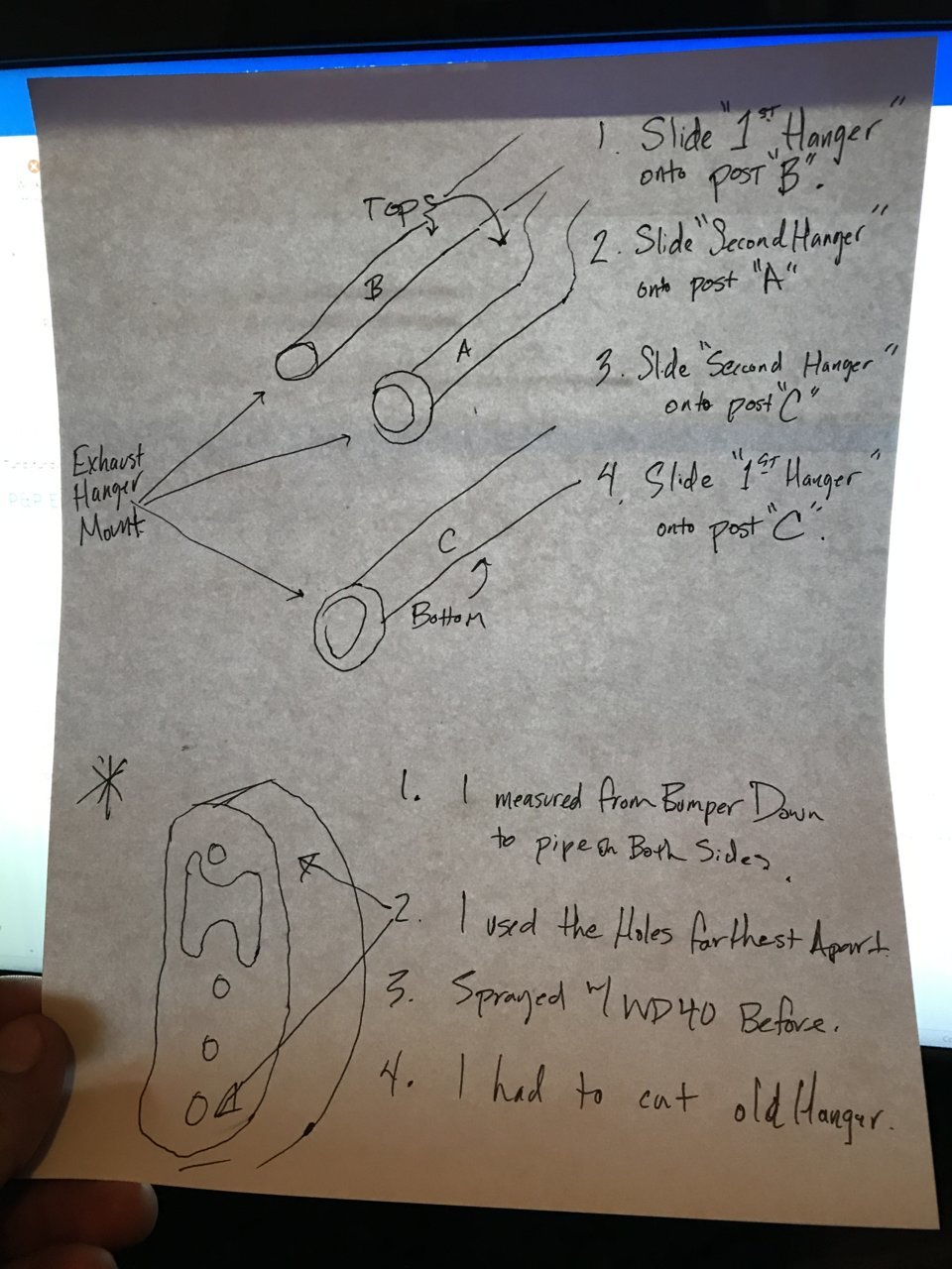

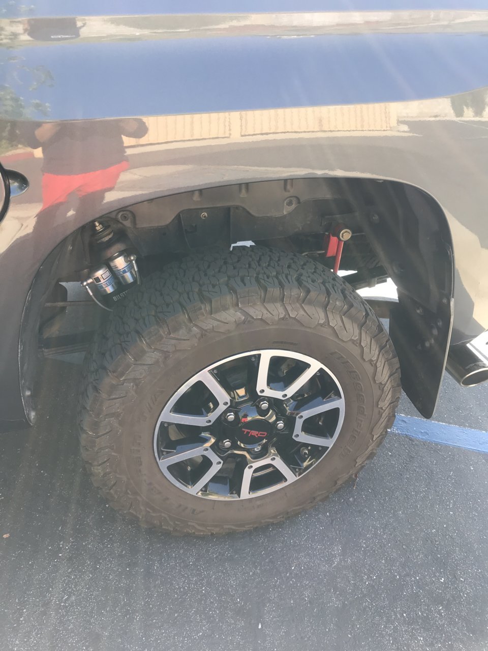

    After installing my TRD exhaust it was very obvious that the drivers side exhaust pipe was closer to the body than the passenger side. Not only did the exhaust tip hit the bumper when I was off-road, it was visually off putting. I had to do something!! Also seeing a bunch of other people having this problem I decided to make a thread with the fix I came up with.
    I ordered these exhaust hangers...
    https://www.amazon.com/CarXX-Exhaus...a-571004886438&psc=1&ref=&adgrpid=70635887228
    After much frustration I decided to cut off my old exhaust hanger. I couldn't get it lose for the life of me. Once I cut it off I installed one of the new exhaust hangers.
    After installing only one hanger it was obvious that the hanger was not as rigid as the OEM hanger and it let the exhaust pipe vibrate while idling.
    In order to combat this I installed both hangers on the drivers side and it tightened up the exhaust pipe quite well! It was a little tricky to get them both on there but I drew a diagram to try and help explain how I did it.
    I love it!! It's even now and exactly level to the bumper!! Much more clearance then before and looks BA! The red hangers are visible from the side of the truck and add some flair compared with the rear sway bar.
    Anyway I'm not a pro at this but let me know if I missed something and be kind!

    Diagram: I sprayed both hangars with WD40 to help slid'r in easily.

    I’ve always just snugged up the 6 bolts, pushed down on high side while tightening, then up on low side while tightening.
    If it’s off too far still, take out the bolts one at a time and drill the holes bigger.

    Hey Kieth,
    I saw that you posted that somewhere. I feel like this was way easier, permanent, and I don’t have to risk ruining the exhaust flange or steel gaskets. Also seems hard to keep the pipe where you want it while on your back trying to cinch down the bolts.
    To each their own but I found this fix very easy and the only tool I used was a utility knife. I’m just kicking myself for waiting so long!

    Side note.... I off-roaded today and the exhaust didn’t hit the bumper once!! So stoked on this mod.

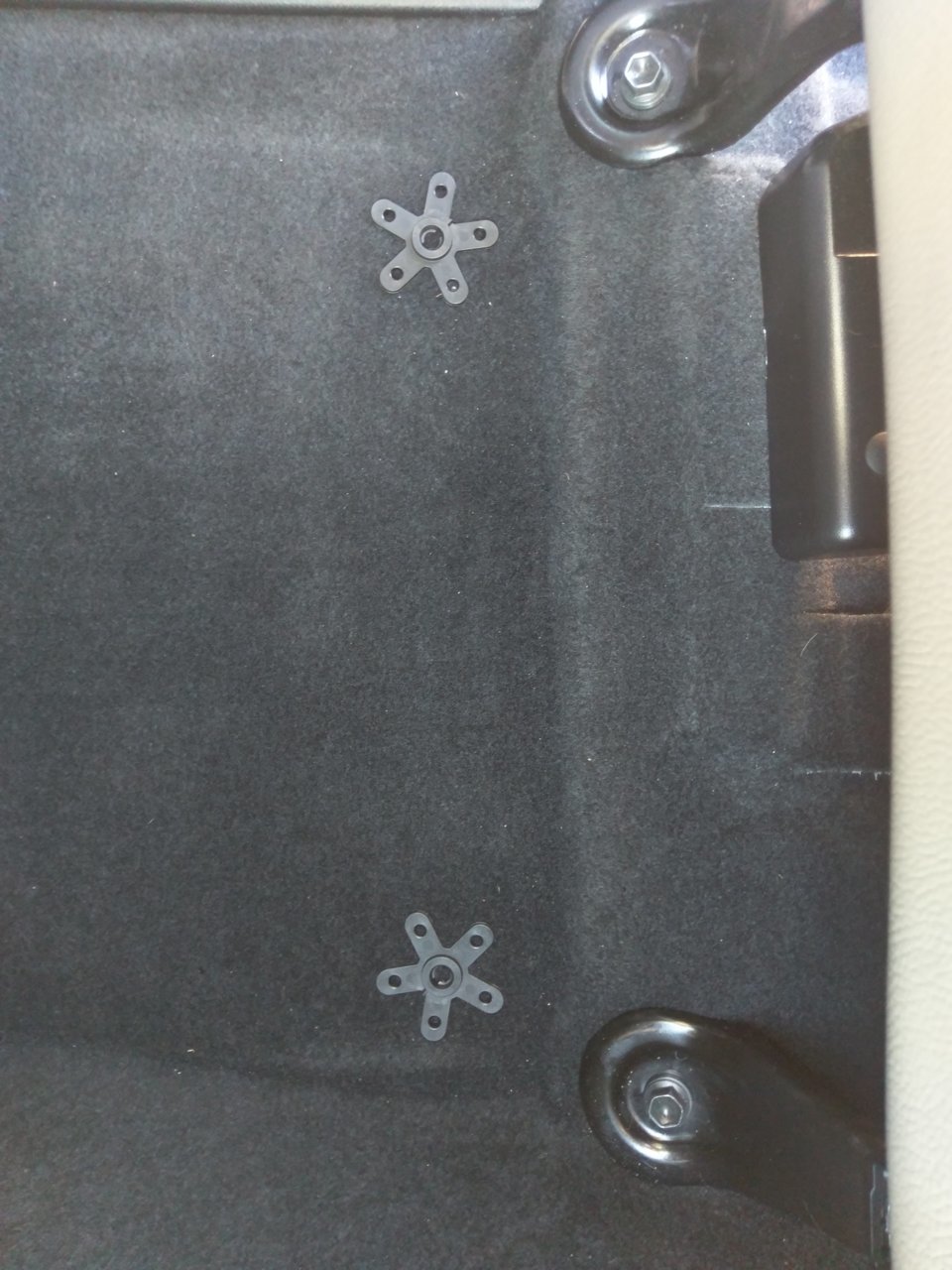

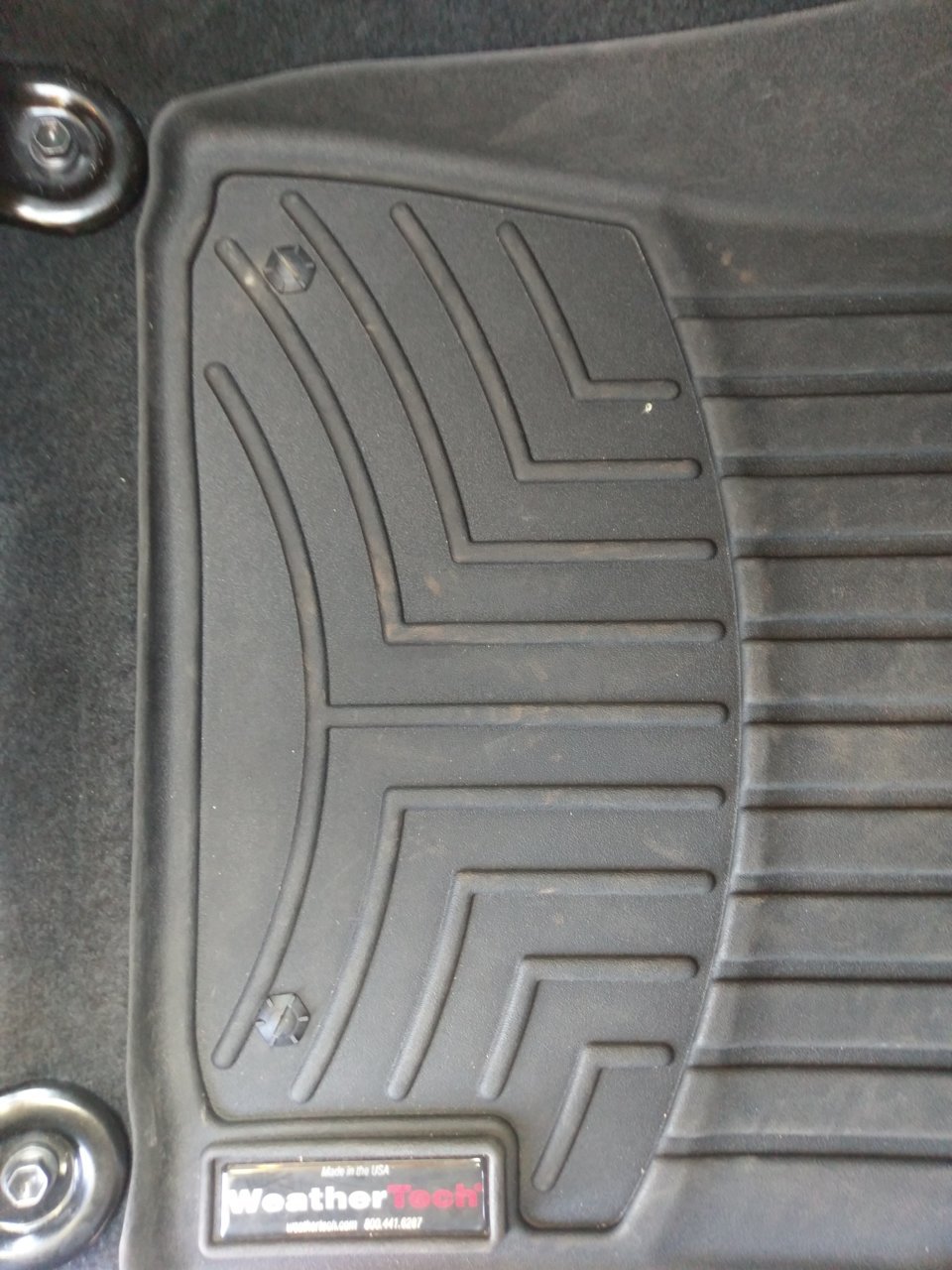

    Order more than you need just in case. I got the four pack and only used 2 on the passenger mat. One of the eagle claws bent as I tried to seat it into the carpet so I had to use another one and try again. If I needed all four I would have been screwed. Here is a pic of the finished product. Hopefully I can make a future trail run up there.IMAG3879.jpg IMAG3878.jpg IMAG3877.jpg
